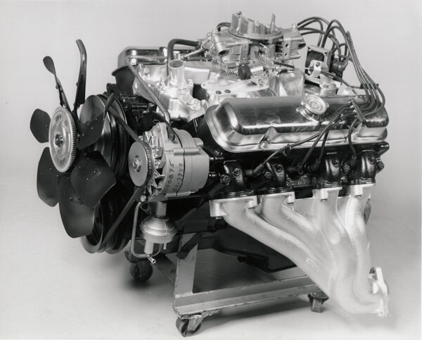

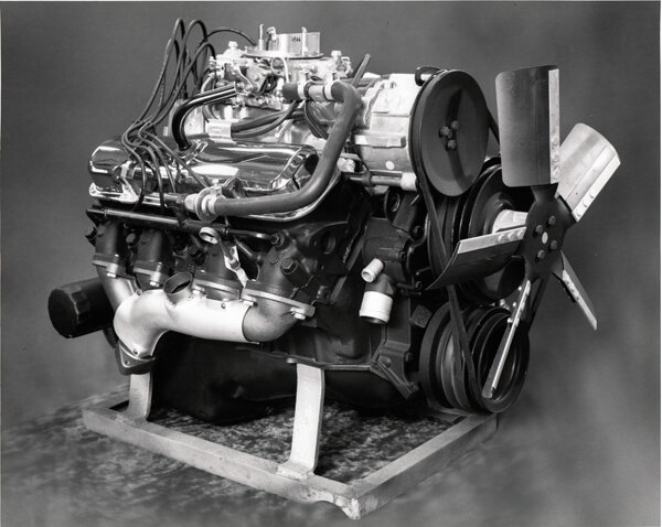

    I just read about the 303 that Pontiac developed for TransAm racing and the 366 for NASCAR. Both had the new heads with equi-distant exhaust ports. Are these pictures of them? I read that they tried to get corporate to use them as the base V8 instead of the 350/400 but got shot down.
