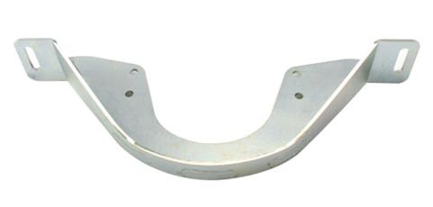

    Another one for the Pontiac guys... Anyone know where I can get a motor/ engine mount to fit a '66 - 326? I'm looking for the type that is a single piece and mounts to the front of the engine.

    No such thing (that I've ever seen, anyway). The only saddle type mount for Pontiac engines fits the early ('55-'60) blocks with the cast iron timing cover. The '61 and newer Hurst mounts bolted to each side and extended forward.
