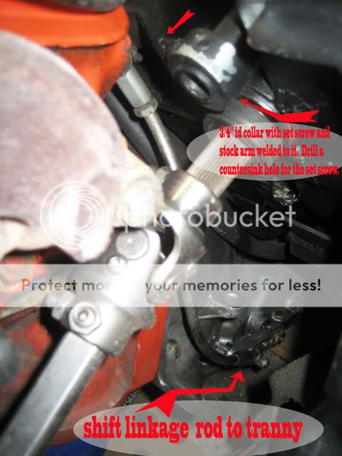

  6. i just did it in a `49 Ford that had a 3 speed on the column. i connected it up to a th350 and it allows the use of the stock column , shifter and steering wheel
    sorry , i don't have a lot of pictures , but basically removed one of the shift arms from the lower end of the shift tube. on the one that was left , i drilled and tapped for set screws to lock it in place on the tube. then it's just a simple matter of using heim ends and a short threaded rod to connect to the ******. drill the end of the shift arm to accept the heim. i used a Lokar linkage kit for GM columns , it was easy to adapt. don't forget a neutral safety switch , i used a lokar ****** mounted one

    Yeah I did the same thing. Easy. I had a mid 50's f100 column with manual shift. Cut one arm off and used a lokar shift rod to my 350 ******.
