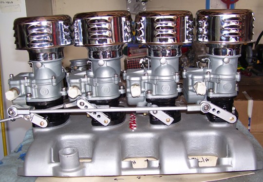

  10. strombergs97
    Joined: May 22, 2006
    Posts: 1,888
    strombergs97
    Happy Holidays..Here are a few. The first picture is a good ratio from the primary to the secondaries ..2 to 1 movememnt..

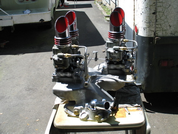

  19. rpol7966
    Joined: Sep 13, 2006
    Posts: 226
    rpol7966
    Here are some pictures of my "in progress" 3X2 linkaqge. I am using a Pontiac kit for some of the components and have made a few of the brackets including the coil bracket.
    I didn't want to use the aftermarket linkage that uses a longer center throttle shaft and places all the linkage on the passenger side of the carbs. Just an opinion, but I like the cleaner look with the single rod between the secondary carbs.
    The secondary baseplates are OEM cast iron units that Hotrod Carburetion modified. I didn't want the aluminum bases that are available from several sources.
    The Pontiac linkage works real well and gives the setup a more OEM appearance.

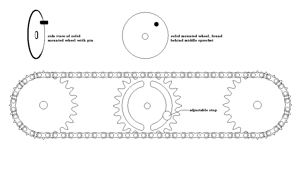

  25. i was curious to what all you guys opinions would be on an idea i have. i would like to take roller chain and sprockets to make a tripower linkage setup. this is still all in my head and not had the chance to mock anything up but the idea much alike using arms and rods. i figure having 2 sprocket on the primary, one that is mounted solid to the shaft while the second floats (spring attached). a mounted pin will run through a cut out guide from one to another allowing the primary to activate the secondary carbs. using an adjustable stop to fine tune the turning of the entire setup. i relise the drawing is very rough but its the genral idea, i also think that the middle sprocket may need to be alittle larger then the other two to keep the chain from saggin. any input would be nice
  26. jonnycola
    Joined: Oct 12, 2003
    Posts: 2,061
    jonnycola
    It seems like it would all work fine... I just dont see the advantage over typical lever type linkage. I like the idea though.
  27. SinisterCustom
    Joined: Feb 18, 2004
    Posts: 8,277
    SinisterCustom
    I think the chain drive would work to run the secondaries.....however, I don't see a need for two sprockets on the primary....just a lever to hook your cable or rod from the pedal and the 'slotted' gear to drive the secondarys.....
  28. Ahhh . . . re-inventing the wheel.
    Kinda cool.
    Think about an idler arm to keep the slop down to a minimum.
    There's a progressive sitting in there if you think about it a bit.
    Even so, it's hard to beat the non-slop characteristics of a quality Heim joint setup.
    Simplicity and easy adjustability is a factor with Heim setups too.
