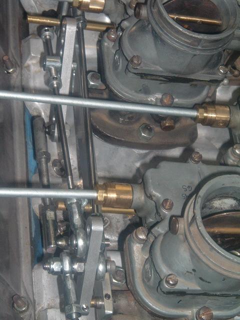

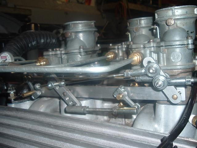

  7. SinisterCustom
    Joined: Feb 18, 2004
    Posts: 8,277
    SinisterCustom
    Neither......only the two extended throttle shafts (which are br***) actually pivot in the shaft, which is aluminum. The support bar slides over the collars of the driver side carbs......which I cross drilled and tapped for set screws, which makes the bar very stable. This way, only two throttle shafts are spinning in the bar = less wear and tuning issues. A little drop of machine oil every once in awhile keeps everything working smooth.
    Also, the extended throttle shafts I got have two set screws to hold 'em to the carb shaft....which if they're not tightened down evenly, will wobble at the end. The bar greatly stabilizes them.
    Here's a few better pics....:D
