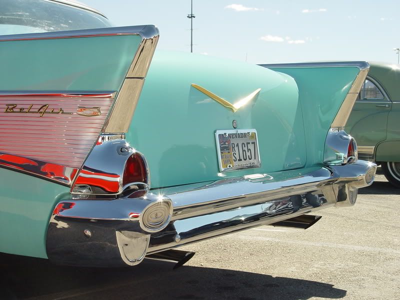

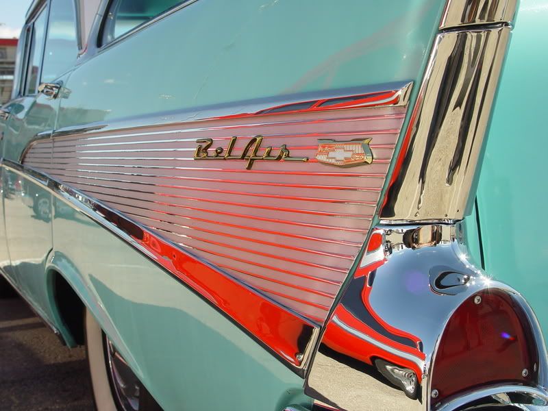

  19. Sincity57
    Joined: Jan 14, 2007
    Posts: 123
    Sincity57
    from Austin
    All the idease listed above for dent removal and straightening are great and I used some of them in restoring all the trim on my 57 4dr HT. Once I got the dents out, I started sanding. I used an Angle Die Grinder with a 3" 3M Hookit attachment. 3M makes various grits for the 3" disc with velcro backing. I started with 320 to get all large scratches and filing marks out. I then went to 600, and finished up with 1200 before I went to buffing. When you are sanding, it help to cross your strokes and cuts through the stainless faster. You will be able to tell right away if you didn't do a good job sanding with one grit when you change to a finer grit. Make sure you get everything out with the course grits before moving to a finer grit. If you don't it will take longer and you will go through more sand paper than needed. Once I got done with 1200, it was pretty close to looking good. I then moved to the buffer once I was happy with how it looked. I also found if there was an area that need a little more attention, it was easier to go all the way back to 320 and work back up then it was to try sticking with the 1200.
    I used two different wheels on the buffer. I used a sewn wheel and a course stainless compound first (grey in color). It was hard trying to remember to take as much time polishing as I did sanding, as it was starting to look real good quickly. I found if I stayed patient, the results noticably different. Once I finished with the sewn wheel, I went to a loose wheel and chromium oxide (green in color) compound, and spent equal amount of time. The results were like looking into a mirror. I talked to the Polisher at English Custom Polishing and purchased my wheels and copmound from him. Call him, he will talk your ear off and tell you everything you want to know about polishing SS.
    Hope this helps!!
  20. scootermcrad
    Joined: Sep 20, 2005
    Posts: 12,383
    scootermcrad
    Here's how the 57 looks!
