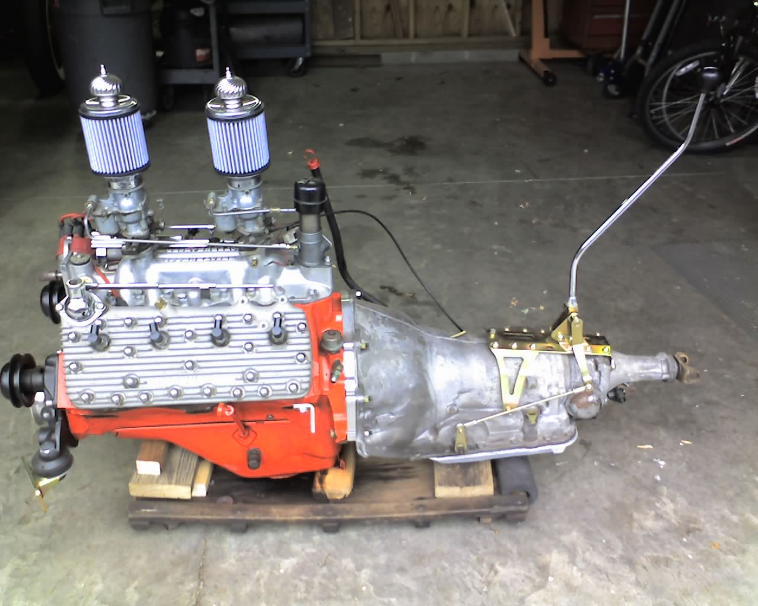

    Here is a flathead to Toploader bell wth a Ford T5 adapter.
    The stronger -251 Aftermarket Ford T5 could be run or any 85-93 Mustang T5.

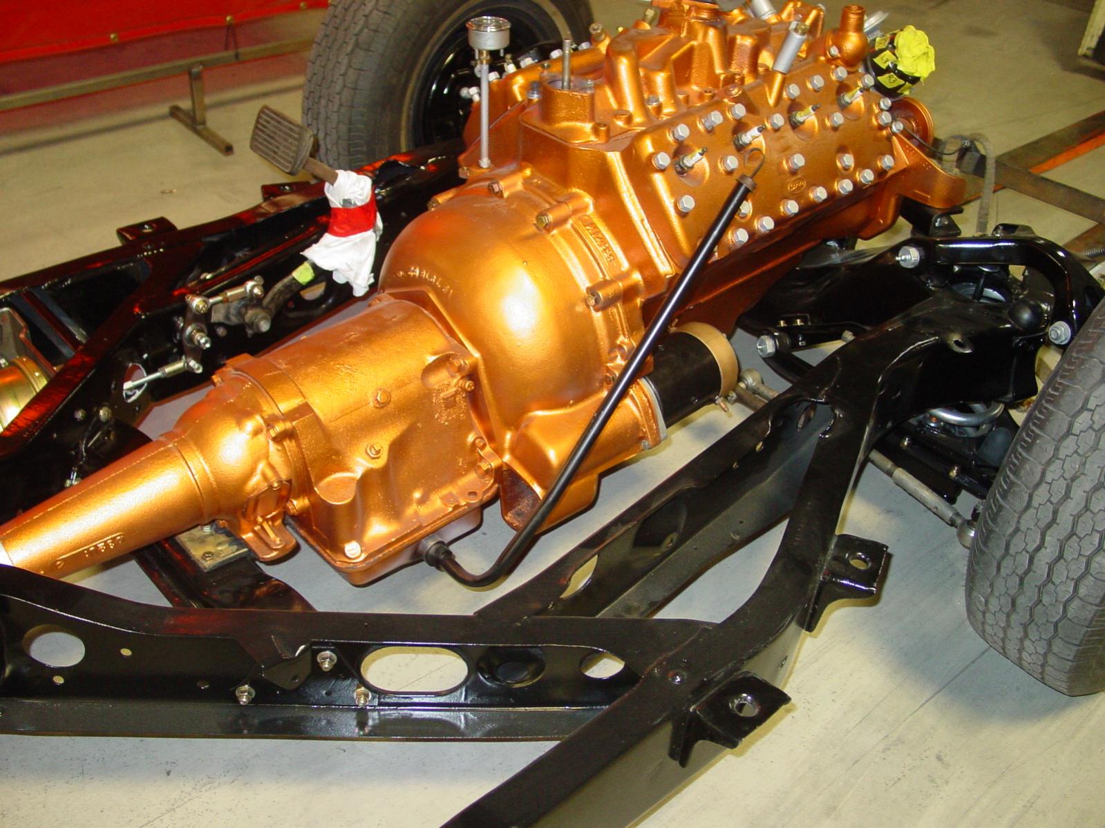

    I've just installed a speedway C4 behind my stock 8BA in my '53 f100 and I love it! The rear end is 3.91 (or 3.92) dana 40. I tried to do T5 with speedway adapter plate, but spacing just doesn't work out with '53 truck bellhousing. T5 is now moving to Chevy 3100 project.

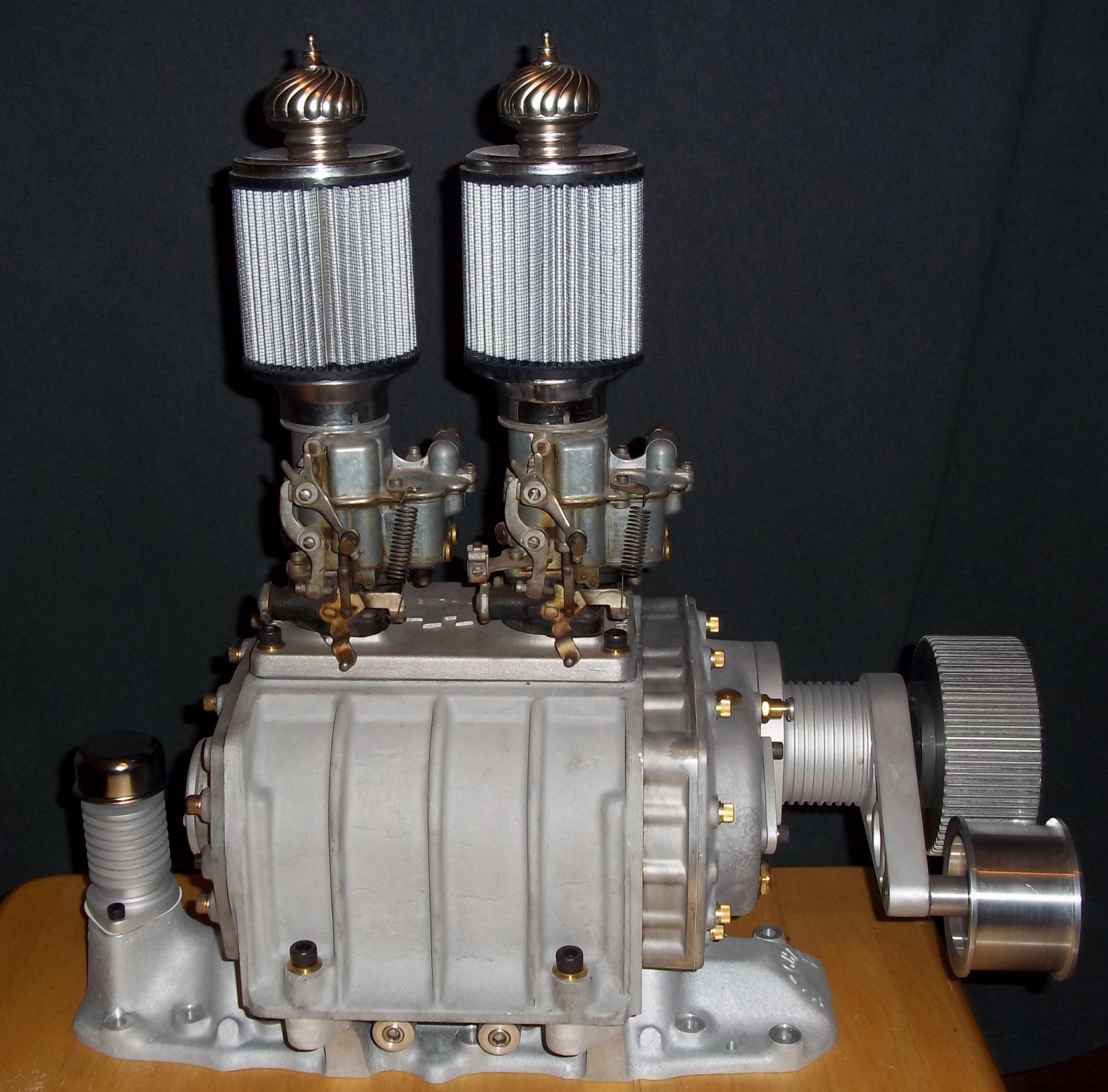

    I know I'll get slammed HARD for this, but here goes anyway...(covers his head) I'm running a 700r4 AOD and have just added the 471 blower....the ****** is mounted with a Wilcap adapter and uses a Mopar starter. No issues so far.

    If I recall correctly, the speedway adapter plate was 5/8" thick, and this set the T5 too far back from the motor. The clutch disk in engaged position would only catch 1/4" or so of the T5 input splines, and the T5 candle stick was only about a 1/4" into the polit bushing. The T5 need to move about 5/8" inch closer to motor for better engagement with pilot bushing and clutch disk.
    This was with a '86 S10 T5 and the '53 truck 8BA bellhousing. My options where to modify the clutch disk hub to catch more of the input splines or to eliminate the adapter plate and modify the bellhousing to mate to the T5 directly. Both options required skills I don't have right now, so I abandoned the T5 and went with the C4.
