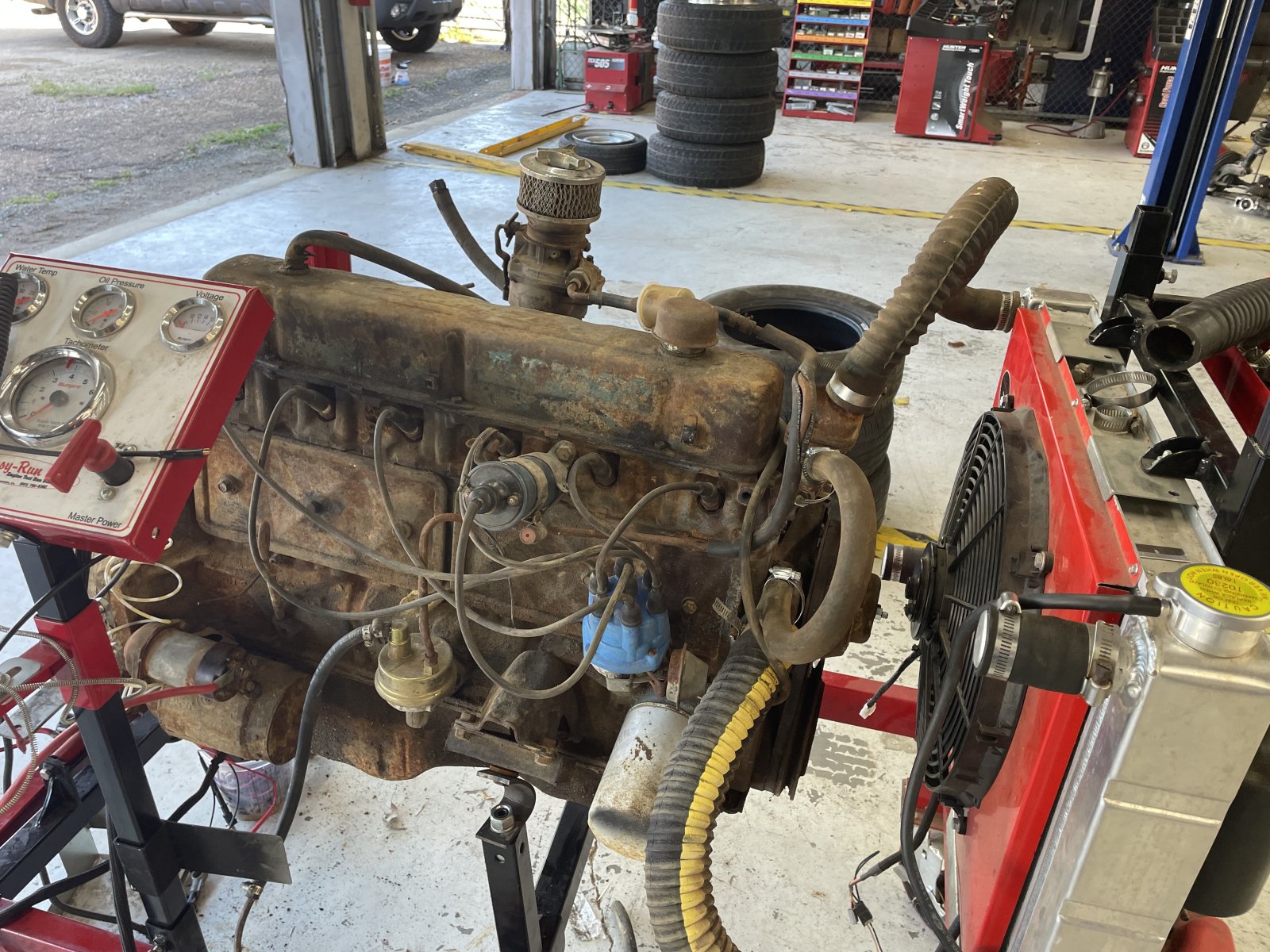

    Getting ready to fire it up.
    Basic ignition wiring and diagnostic skills.
    Compression and vacuum testing
    If it has good numbers, clean up, reseal and paint.
    Build a carb

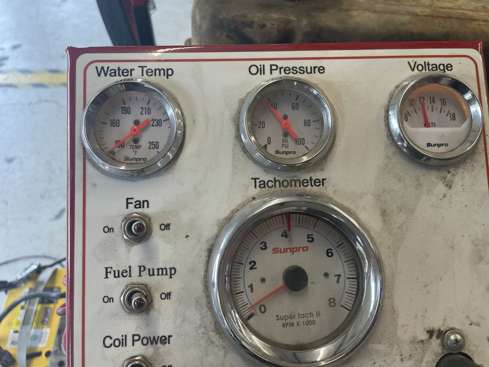

  2. Fired right up
    rpm reading is off.
    Around 40psi just above normal idle.
    Gotta replace the fuel pump and we can let it warm up and see what it does
    No oil change yet

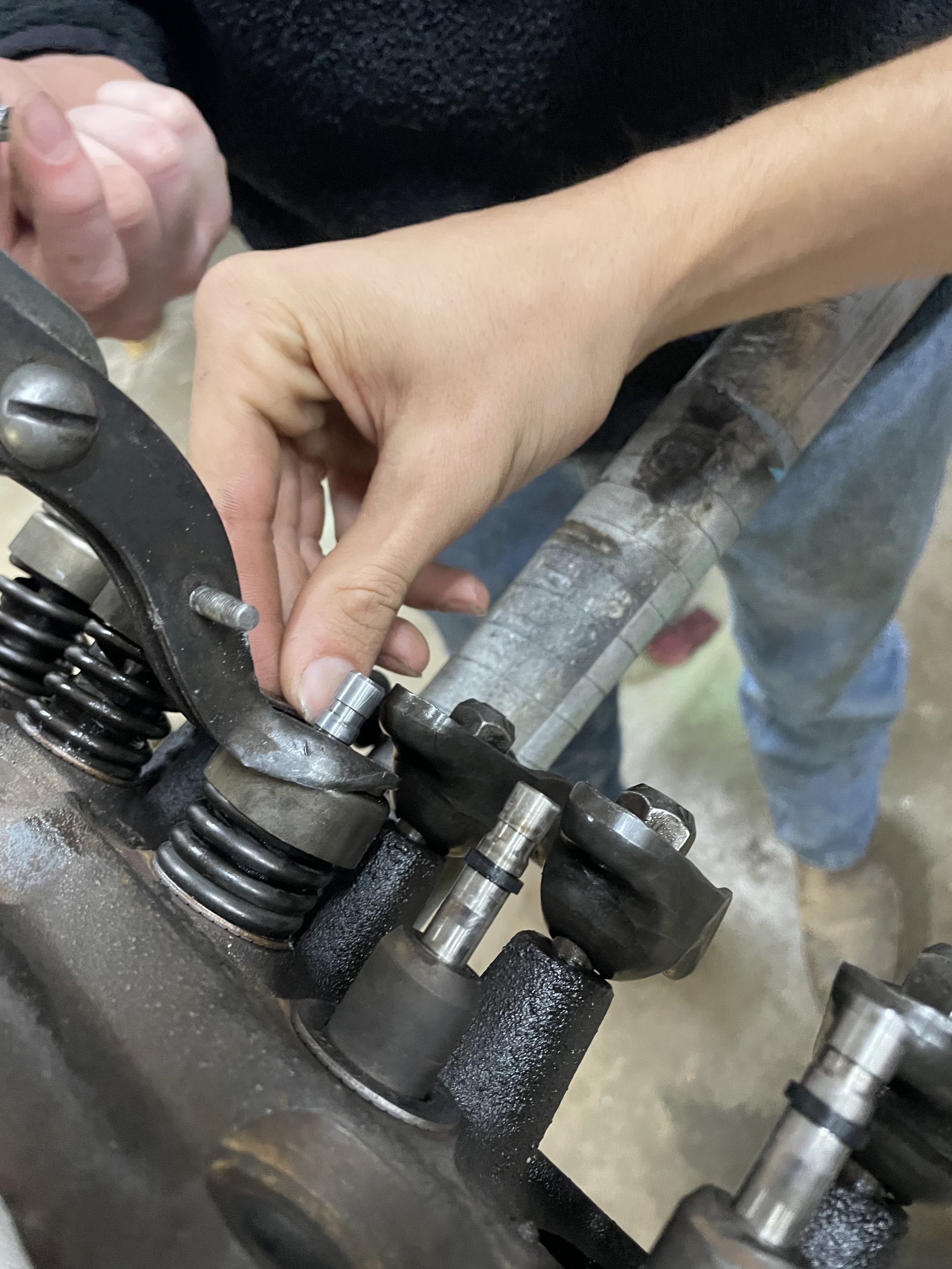

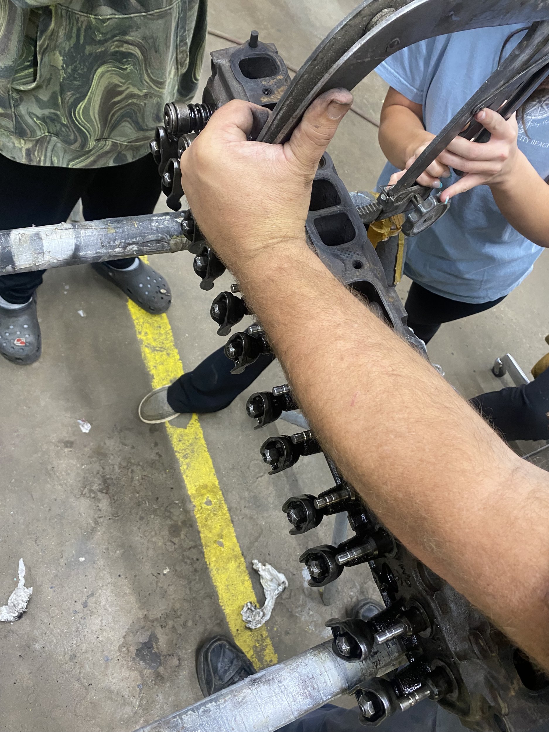

  4. Some backwoods head work
    Students lapped valves for a 292 Chevy
  5. Johnny Gee
    Joined: Dec 3, 2009
    Posts: 14,998
    Johnny Gee
    from Downey, Ca
    ^^^^^ The old power spin and seat method.
  6. I guess.
    We’re just cleaning em up and installing new seals.
    Older rebuild. Could use guides.
    Engine ran great on our stand and had very good comp numbers. 150-160
    40psi oil
    It’ll work for a truck that sees about 3/4k miles a year

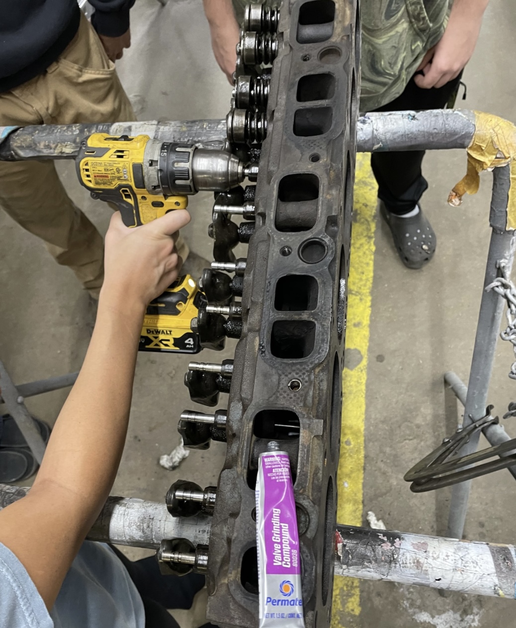

  8. Yep. Put pressure on it from the valve side.
    Turned at a slow to medium speed

    Hey, yer supposed to lap 'em by hand with the suction cup stick. Builds character! And a fancy pants cordless drill too....o_O :D

  14. I’ve never done that, but I damn well would have if I would’ve thought of it! Thanks for the tip!!!!
  15. Johnny Gee
    Joined: Dec 3, 2009
    Posts: 14,998
    Johnny Gee
    from Downey, Ca
    Lube stem well, always keep lap compound wet, slow speed. Chatter solved.

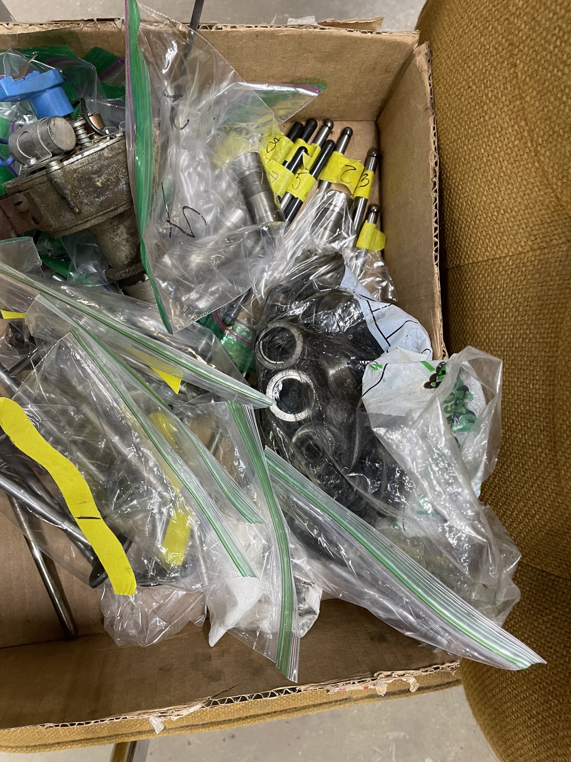

    Students bagged and tagged the important stuff

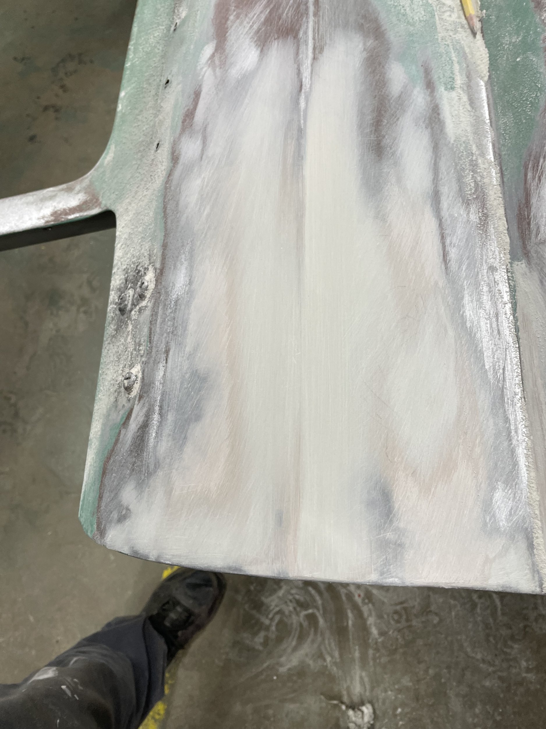

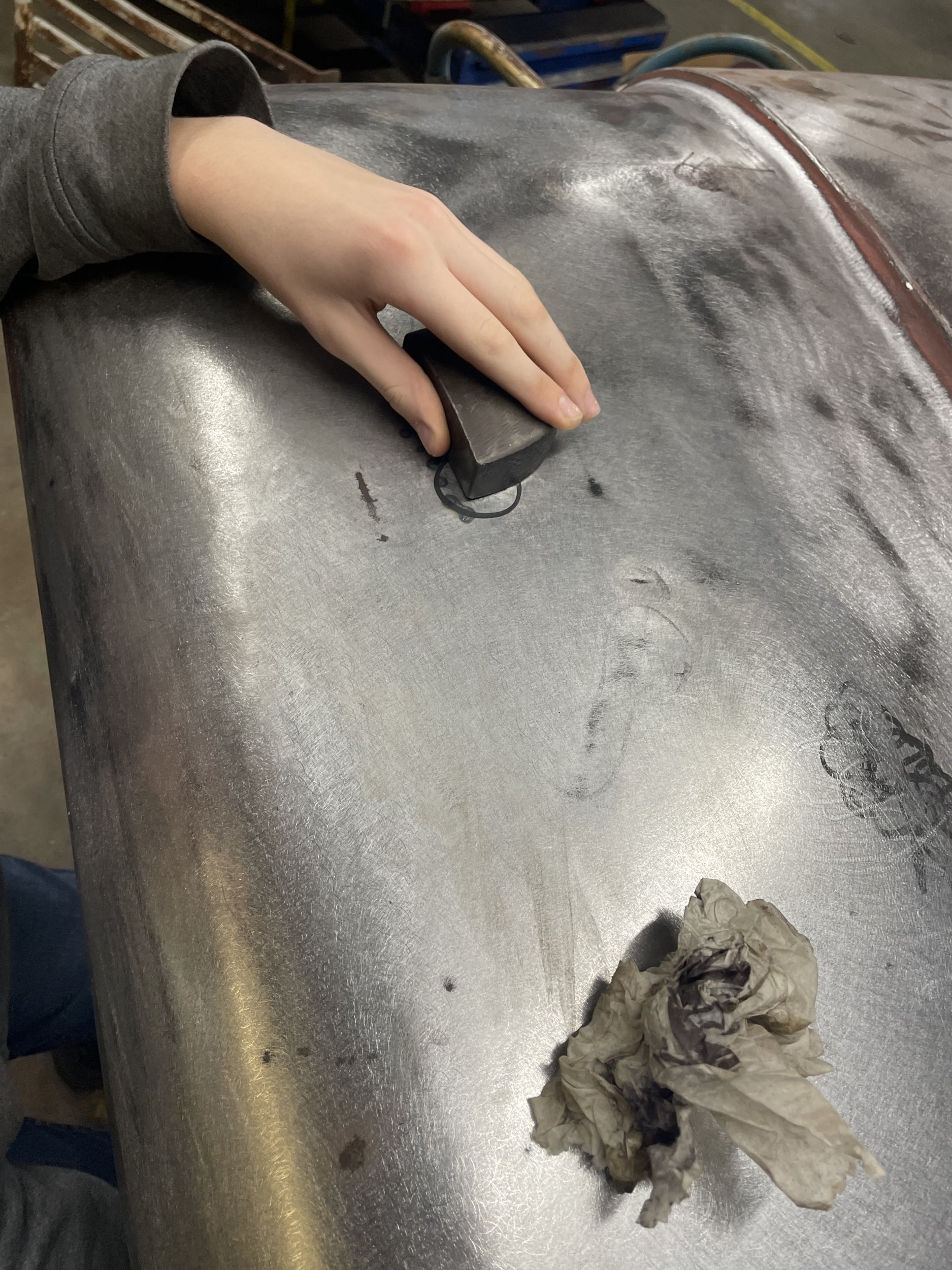

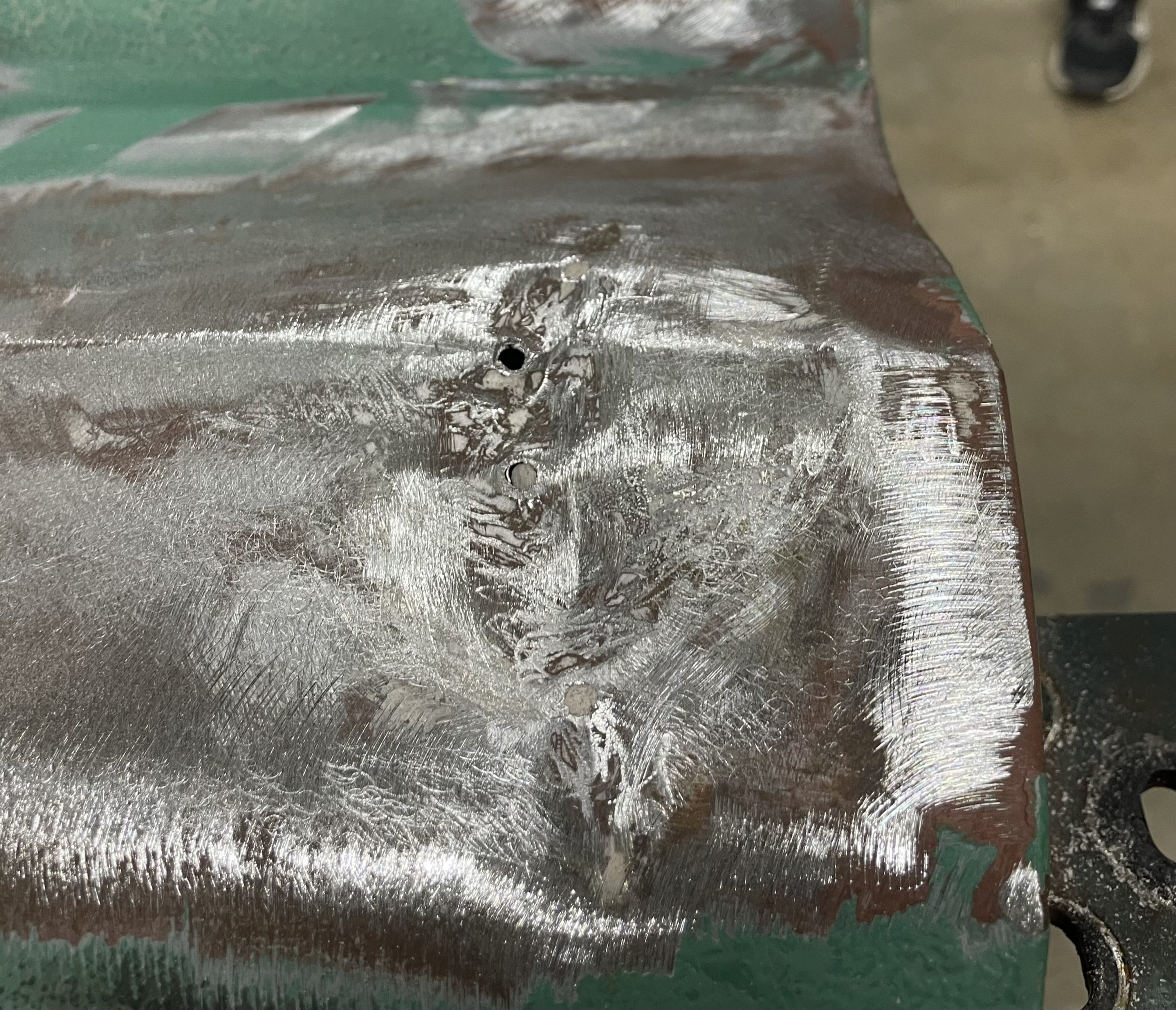

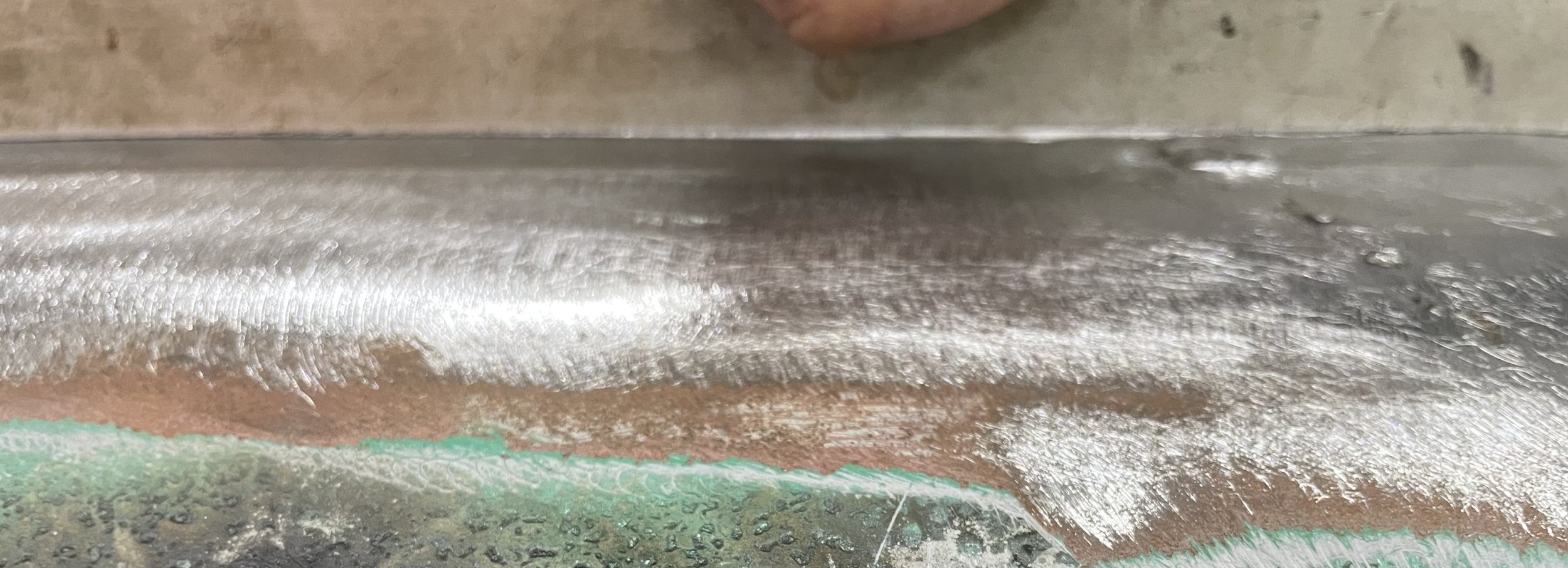

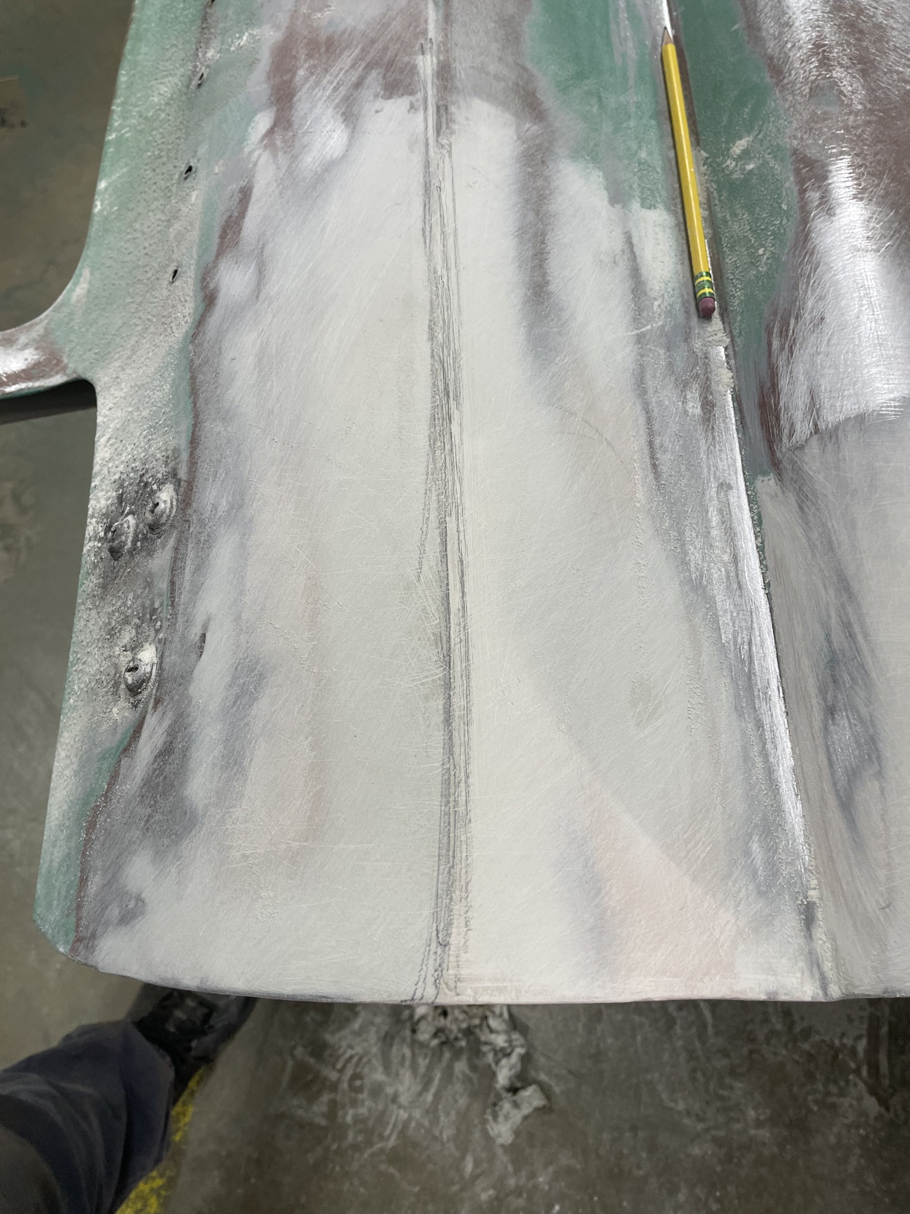

  17. S**** yard 63 c10 door. Has the typical wrapped around the fender damage that was hacked up some time in the past. Filler around 3/8 thick and typical screw dent puller distortion
    we got it to this point and called it done. Welded up the holes.

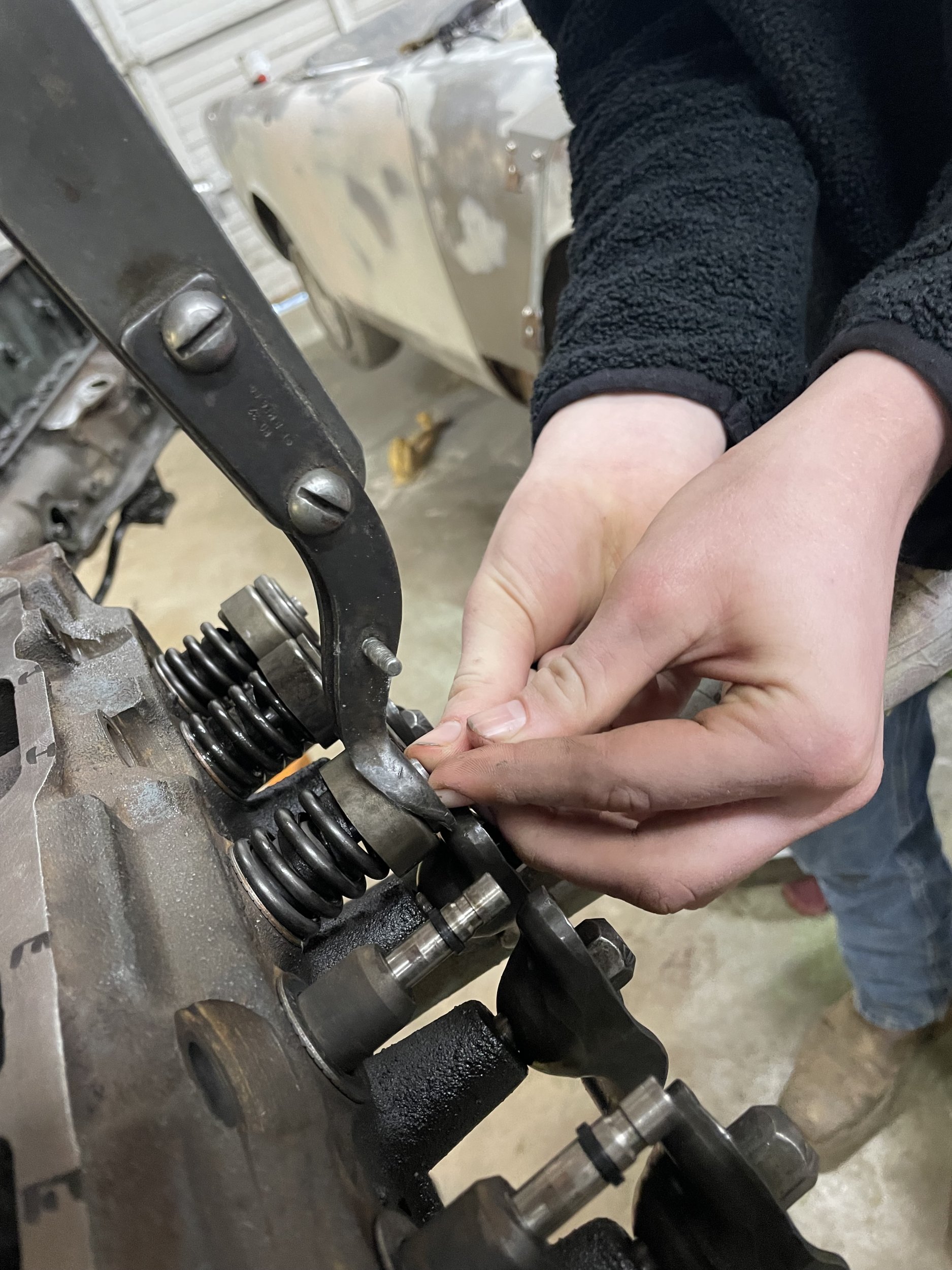

  18. Valve springs had these shims

    Man, that is a familiar fix! Seems most of those trucks have that damage and ****py repairs.

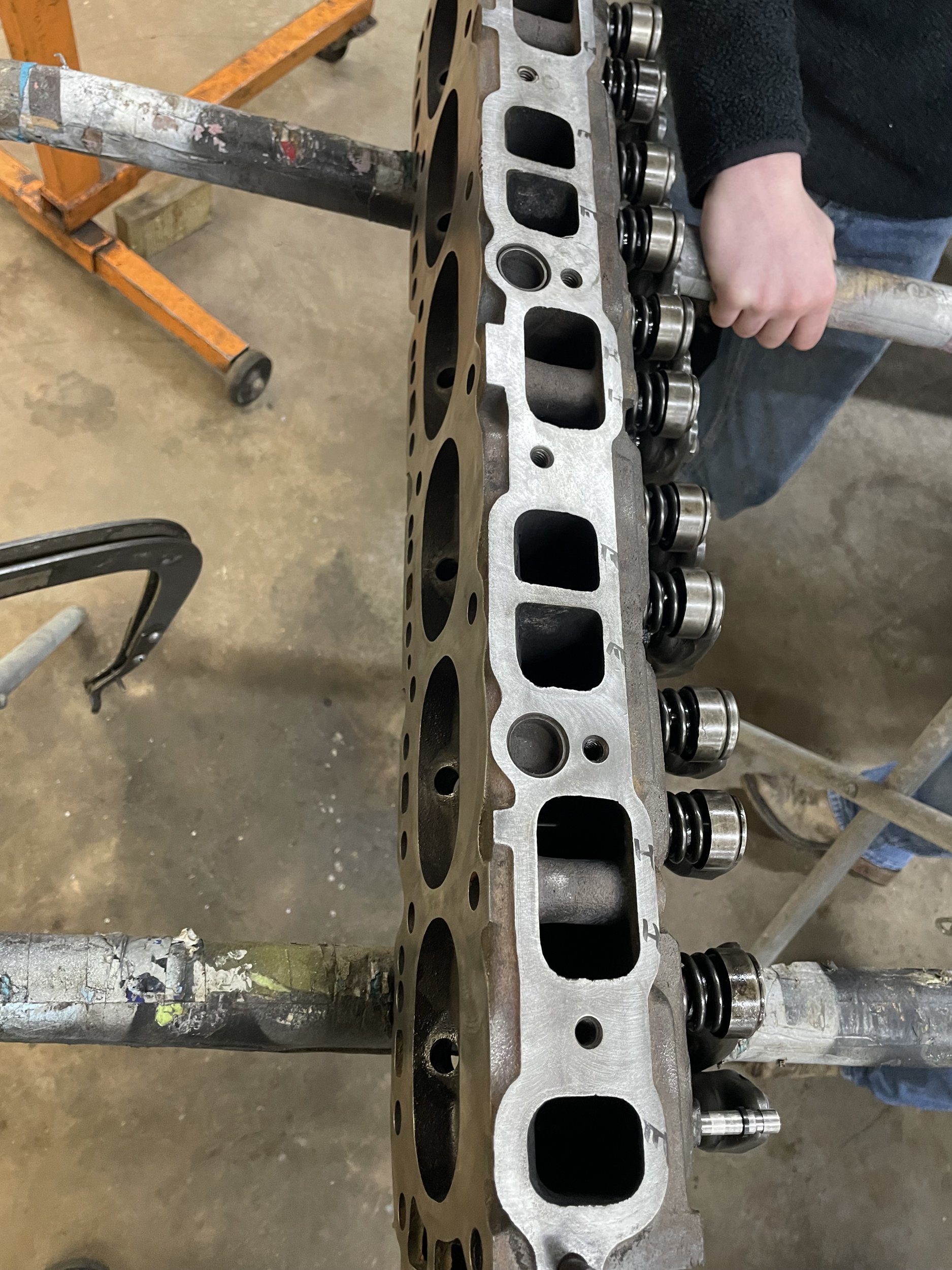

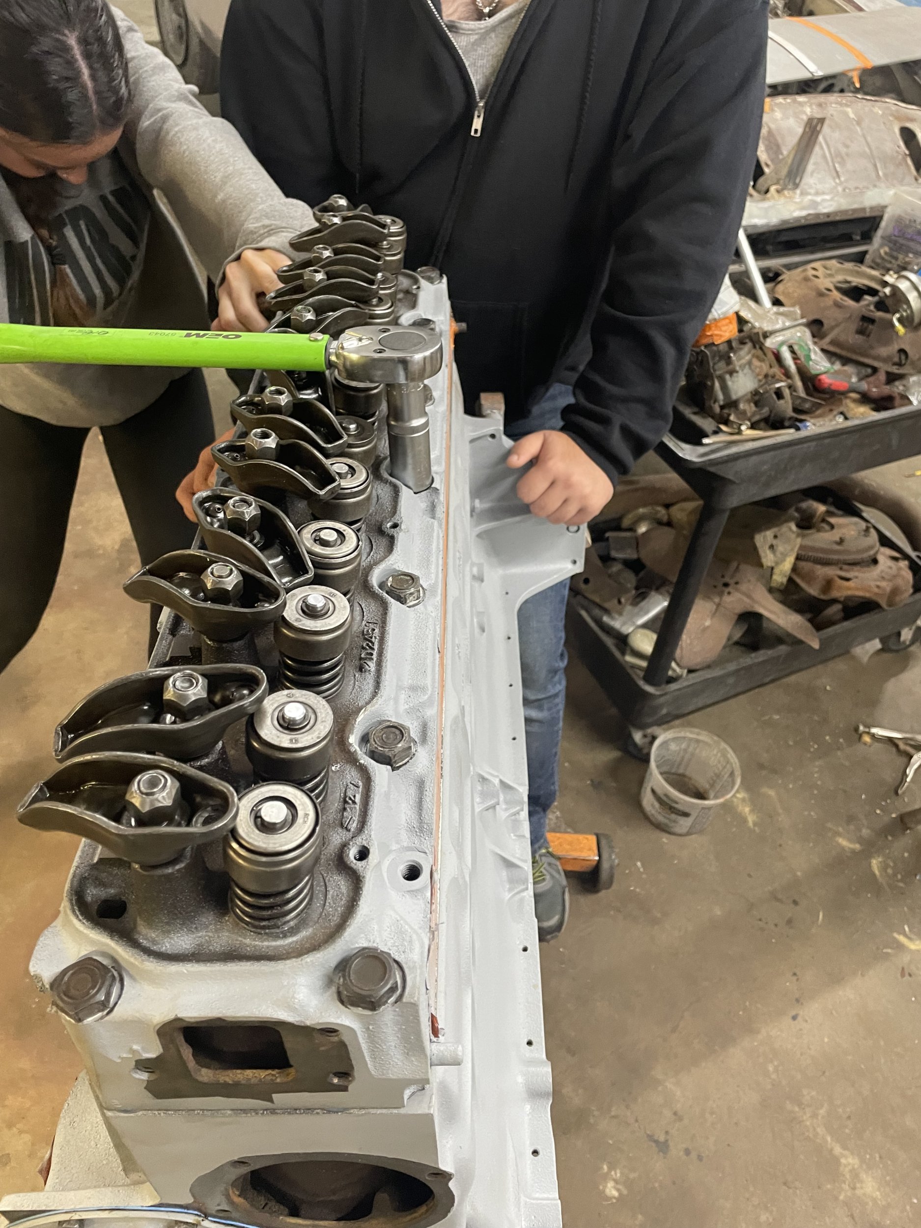

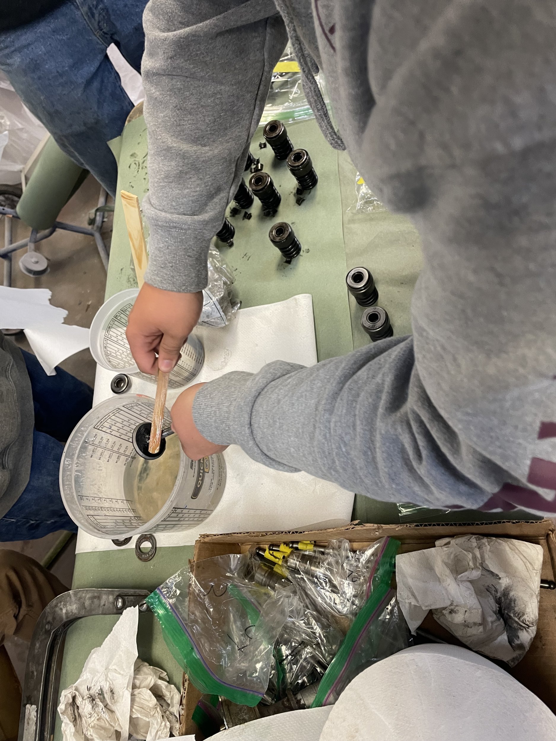

  20. Final clean on these old valves to get the compound off. Pressure washed the head and cleaned gasket surfaces.
    The old ones are just keeping em from falling out
    one to go

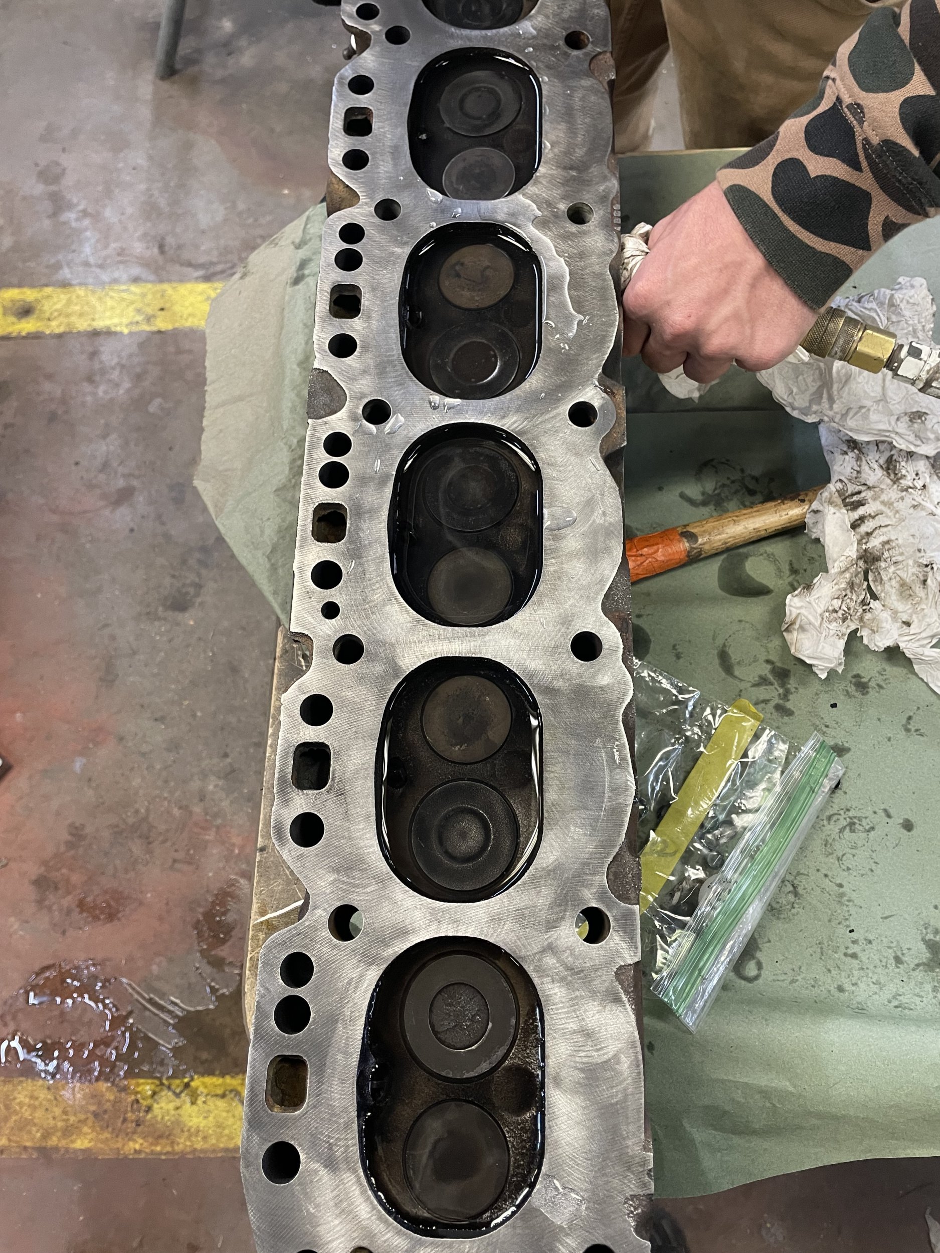

  22. Hillbilly leak check
    couple taps and it p***ed

  23. Crusty Chevy
    Joined: Aug 28, 2007
    Posts: 1,352
    Crusty Chevy
    Neat trick. Is that light oil or water, and how much air pressure do you use?
    Sharpone and anthony myrick like this.
  24. Johnny Gee
    Joined: Dec 3, 2009
    Posts: 14,998
    Johnny Gee
    from Downey, Ca
    Certainly less than what the valve spring rate is. :)
    clem, Sharpone and anthony myrick like this.
  25. Water and whatever the psi is at the regulator
    90-100
    But no where near that in the port
    Got a couple tiny bubbles on a couple exhaust valves. Flipped it over, set a piece of wood on top of the valve stem and banged it with a hammer.
    no more bubbles

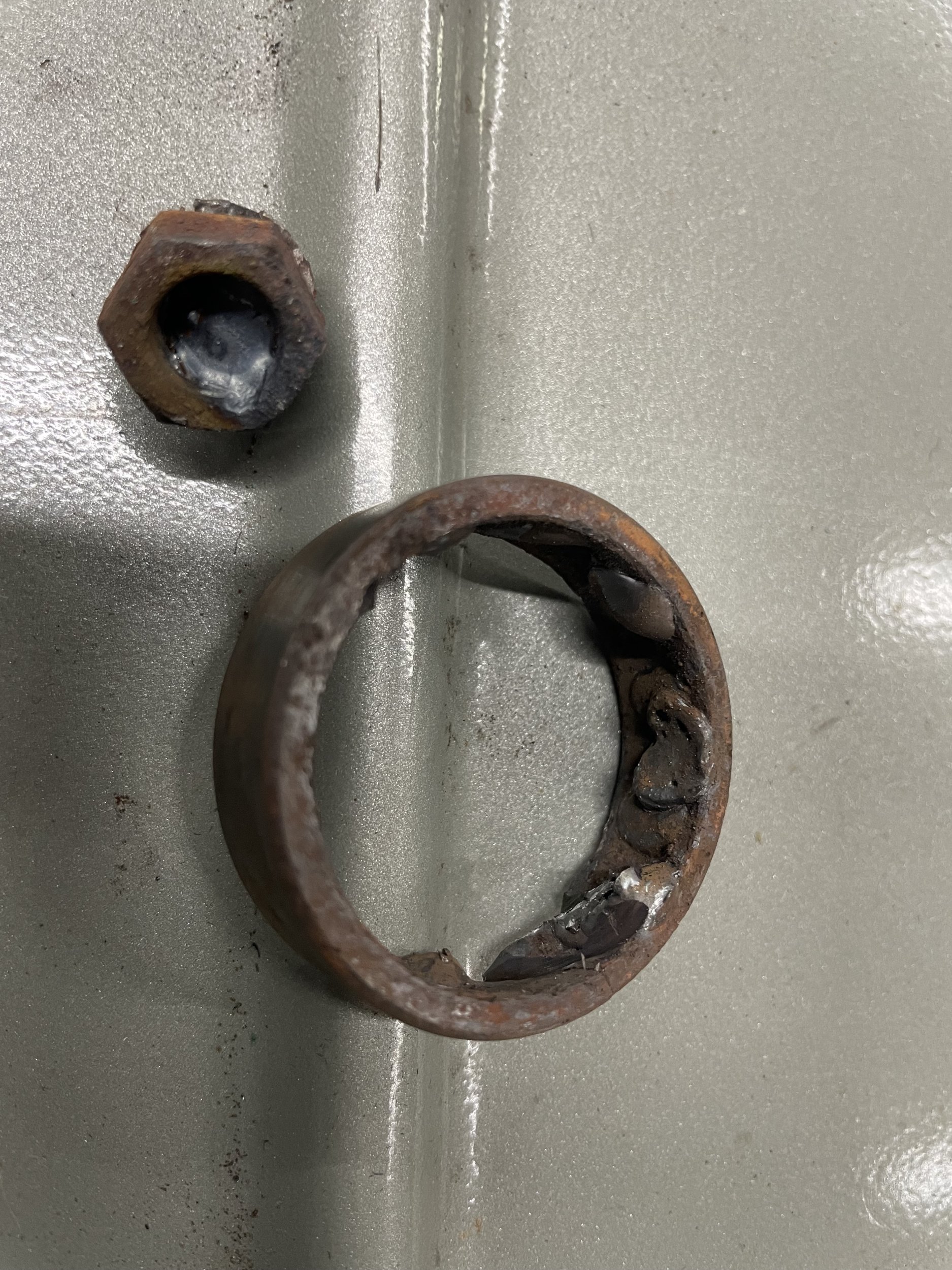

  26. Two successes today. Froze bolt (short threaded screw) and a very rusty bearing race with no access from behind.

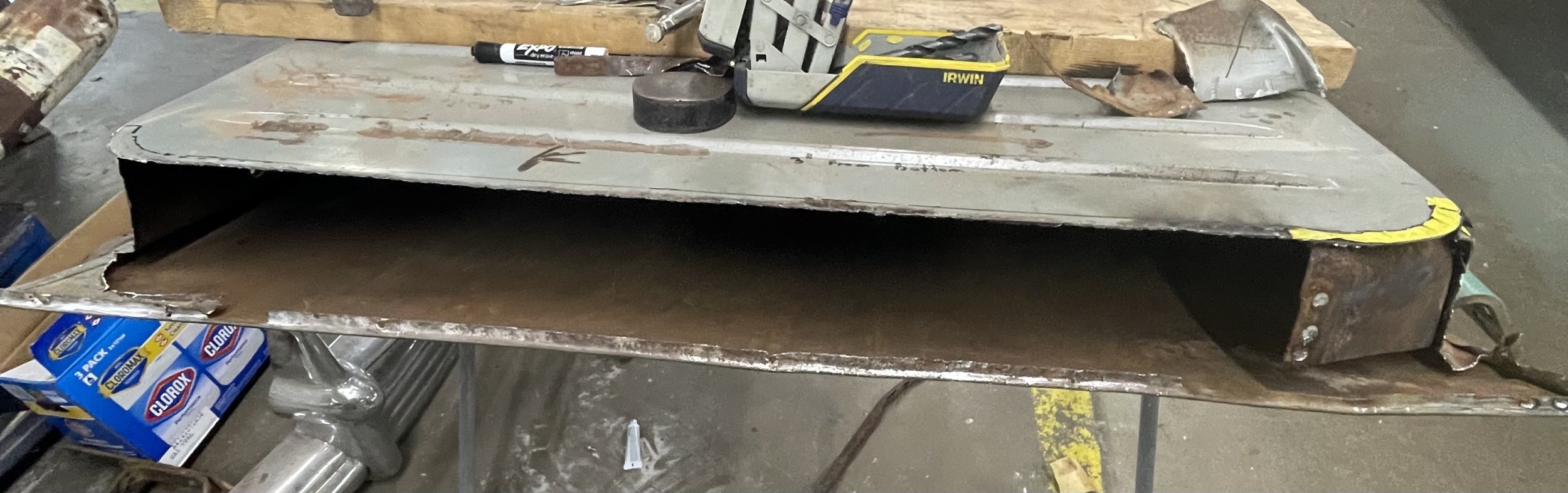

  27. 63 c10 door. The outside skin is good. The inner bottom isn’t.
    Students rough cut the inner then cut the spot welds for the skin.
    Then separated the hem joint. Those are tough when not removing the outer.
    the inner will be final trimmed after the new bottoms are bought.

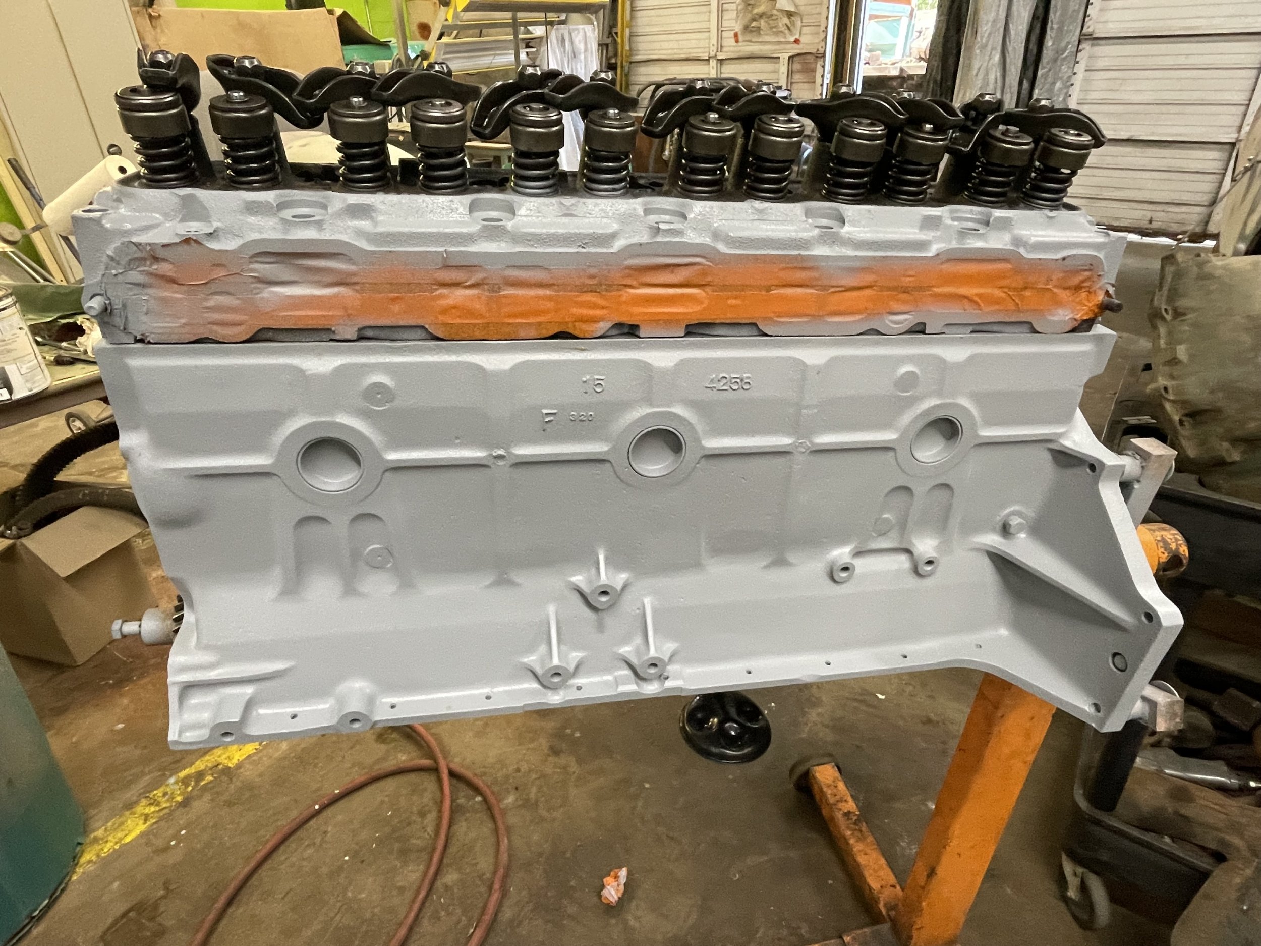

  29. Got the rear main seal swapped out. Super EZ.
    Students primed thr 292 pieces

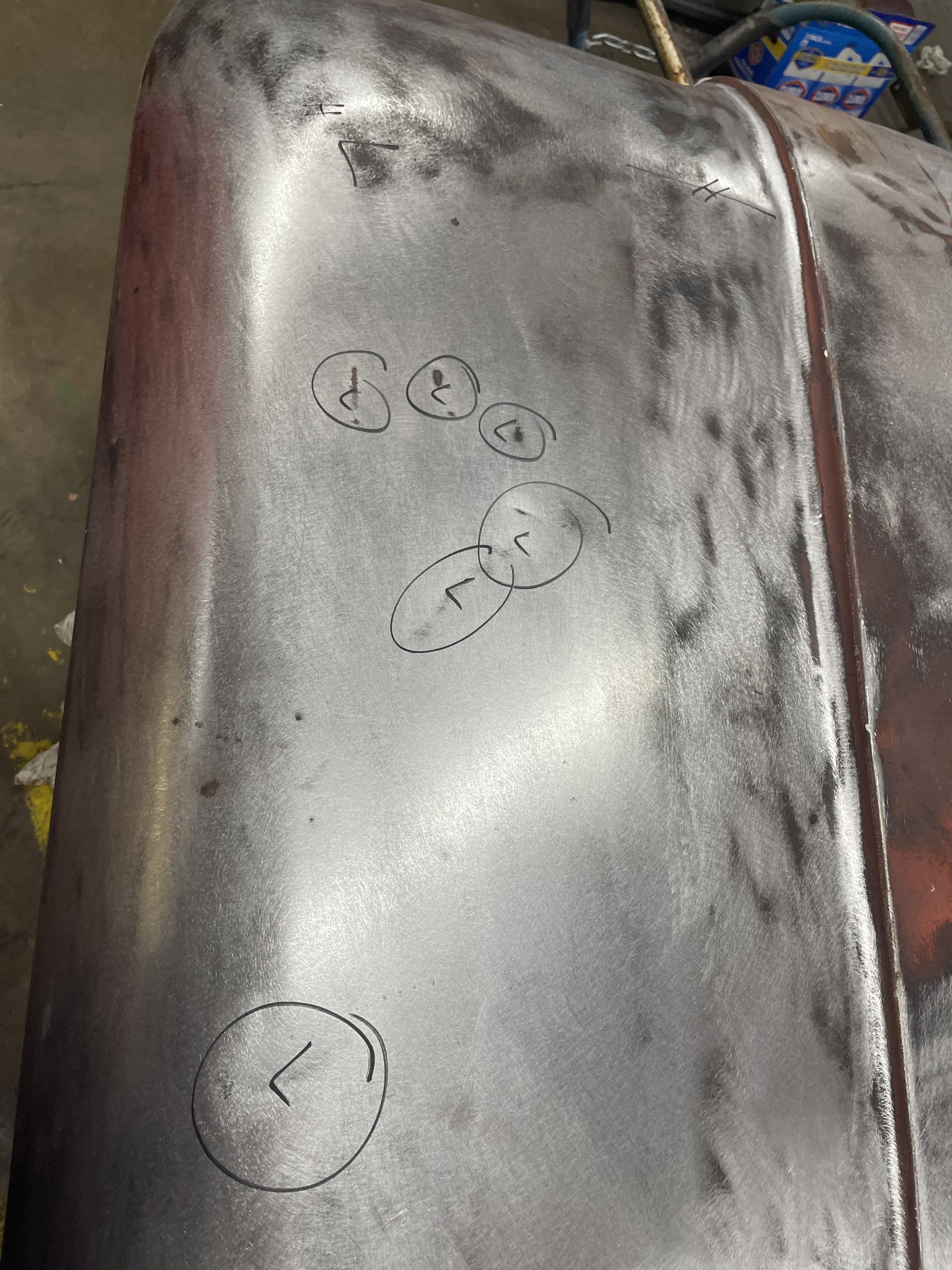

    old beat c10 hood. Has bullet holes. Using it to demonstrate basic metal work.
    young man was learning how to heat shrink.
