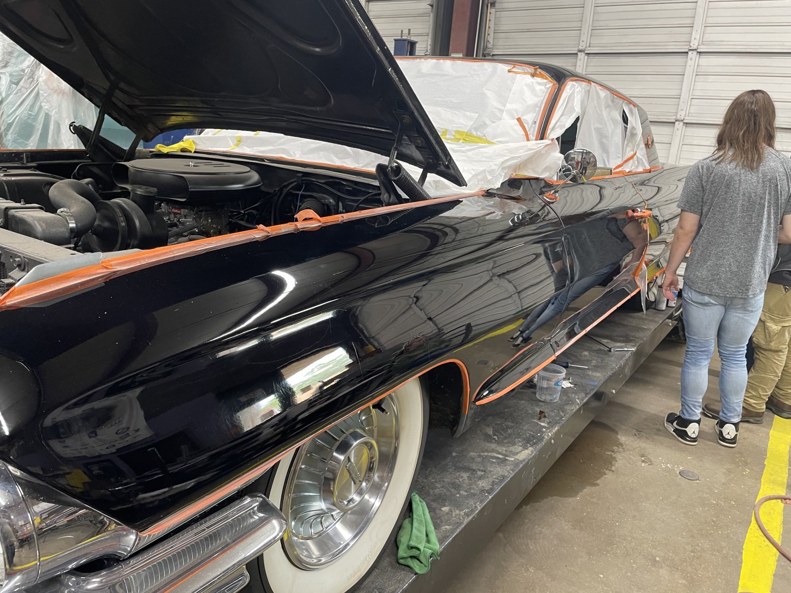

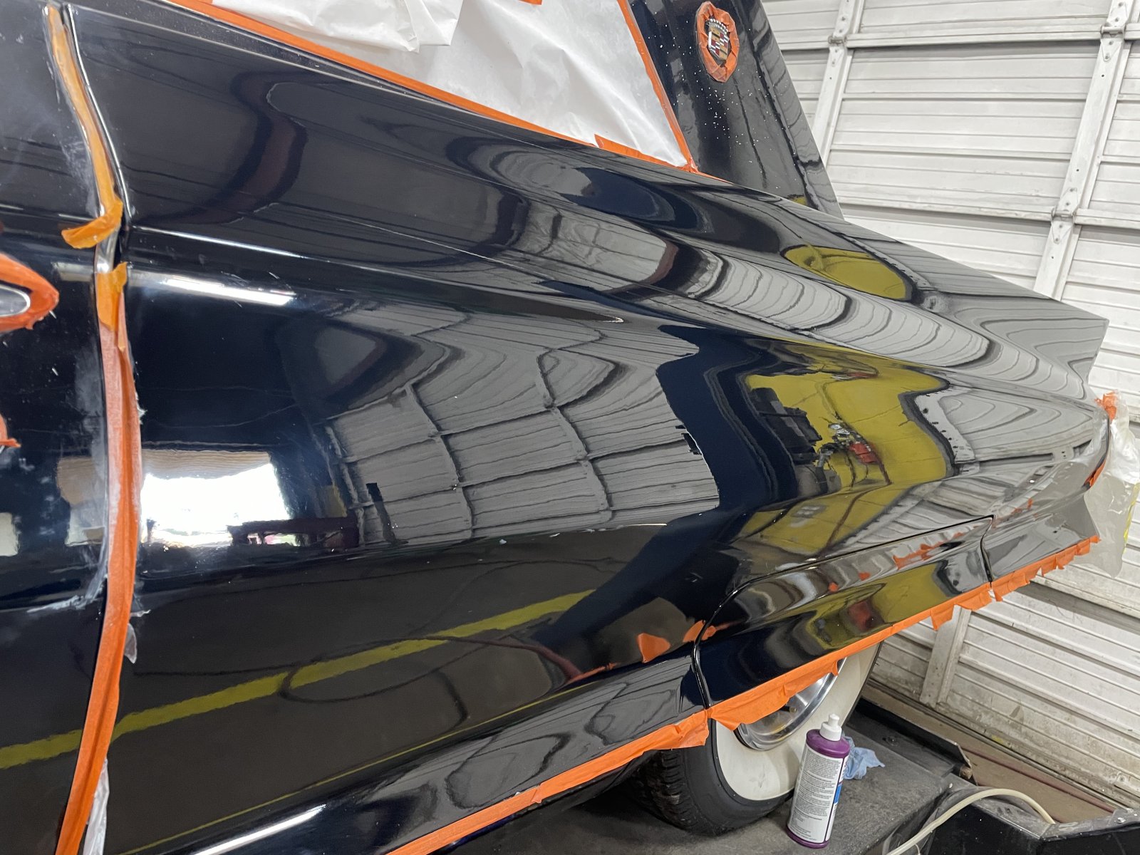

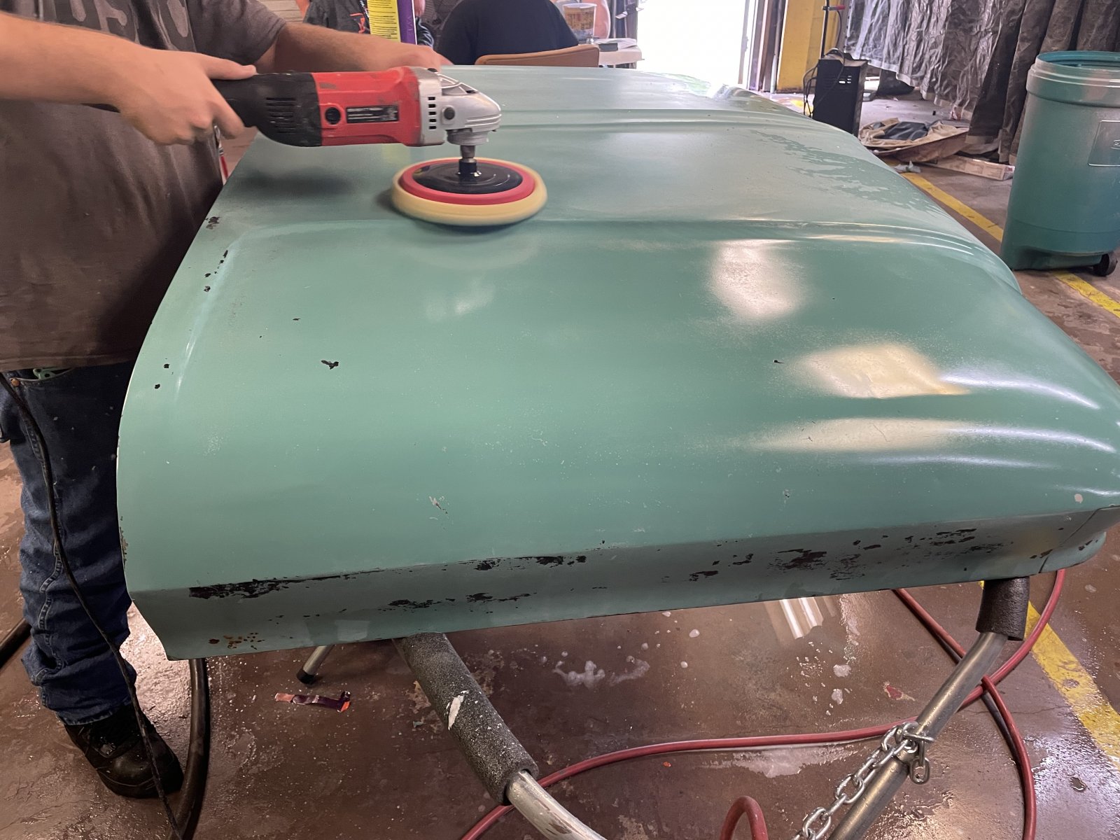

  11. Reviewing buffing today with SRs.
    Both are old paint jobs. Clean, dry, wet sand then buff.
    An old paint job is great because it takes the pressure off for screwing stuff up.
    26BCA753-701C-4353-AA63-6F457F327C57.jpeg 3D3E2D13-3D79-4EE2-BDE8-A36BA87967A4.jpeg 54324AB1-273A-4C04-A679-FADCA868B842.jpeg 889B952E-7DCC-43A7-8B1D-08725670858F.jpeg

  13. Thanks. it’s looking better. 30-40 year old paint.
    It’s not perfect but will cruise

    Reminds me of the batmobile with all that orange tape. :D

    Well that turned out great! I hope the students were proud of their work...

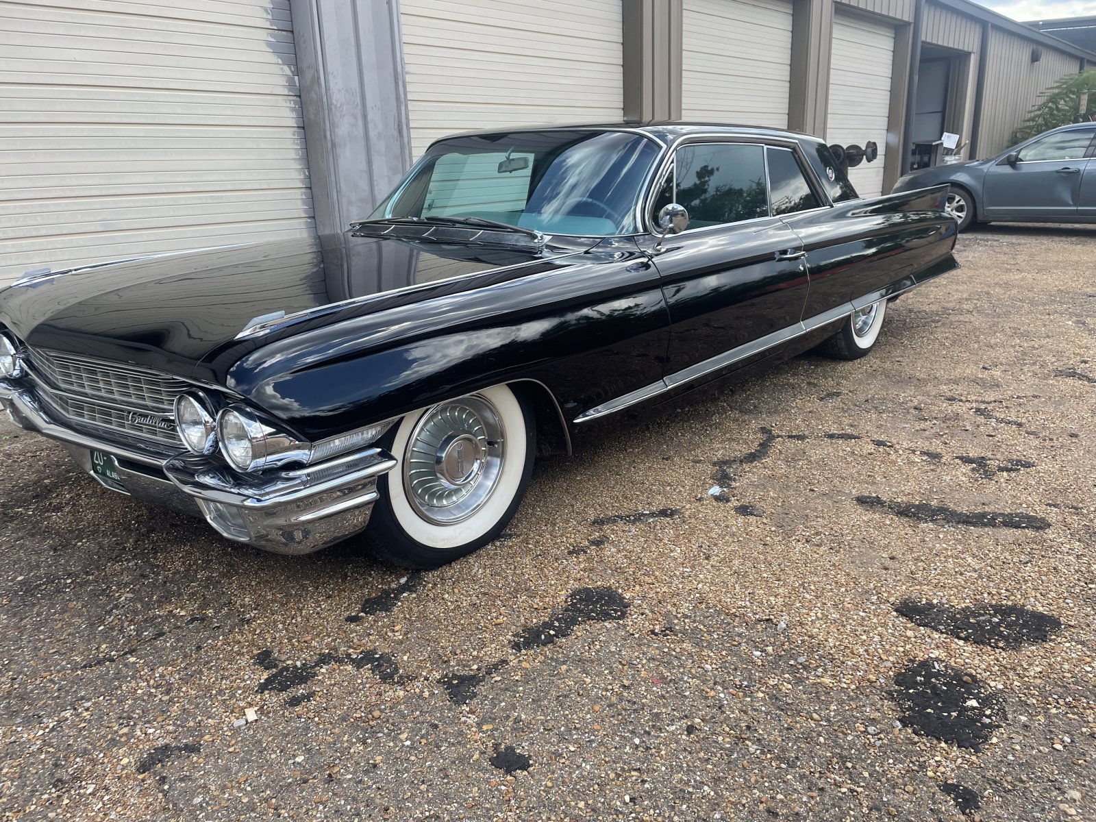

  17. They were.
    We did a light check today. The dimmer switch was fun.
    The trans shift pattern blew their minds. Reverse is where low is for normal cars.

  19. It’s a combo of single stage and base clear. The car was originally metallic green. A previous owner painted it black many moons ago. Up close has pimples, scratches and cracks.
    It’s a car ya don’t mind driving.

    The Caddy looks terrific, as you sometimes say Anthony “I’d drive that” :)

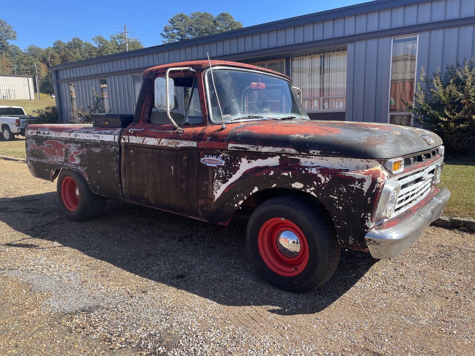

    welding student pulled up in this 65 yesterday.
    Built 460 and DOT slicks.

    Thats cool! With that motor I'm betting the owner could weld some rubber to the ground.
