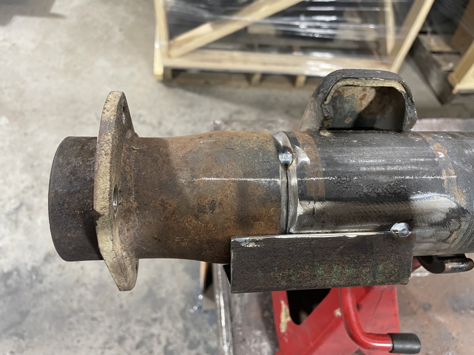

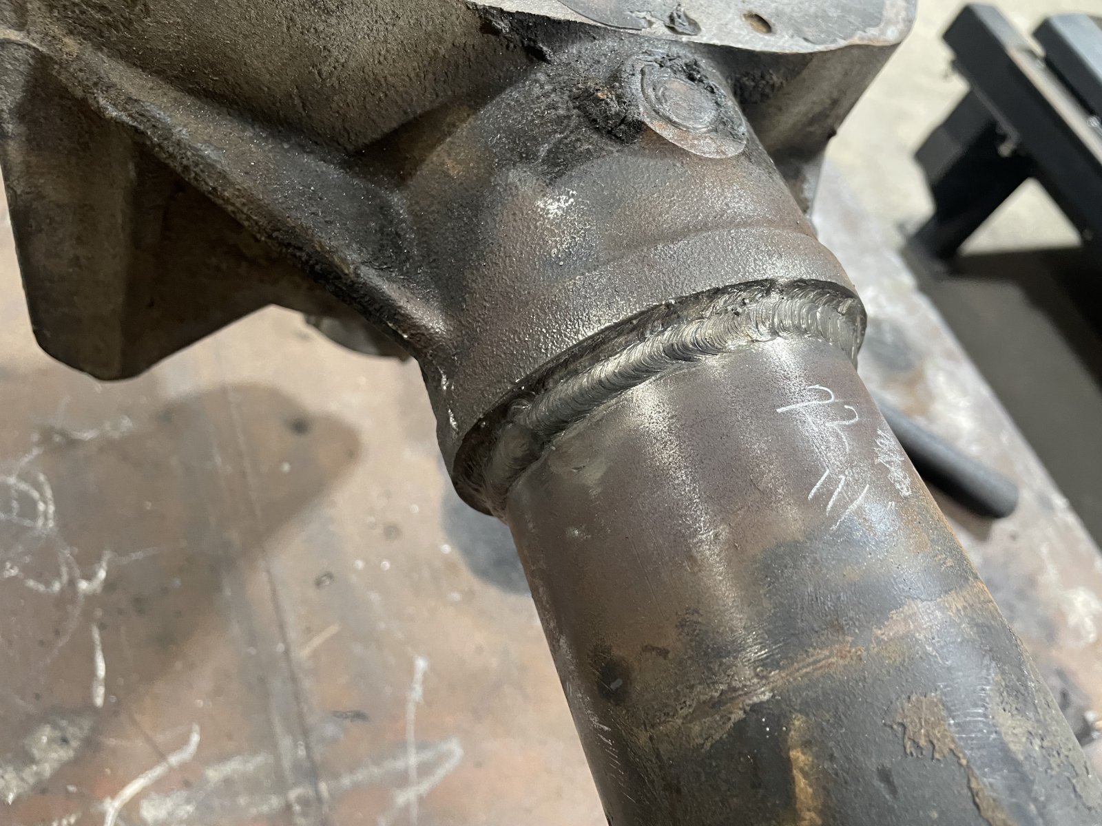

  3. Welding students narrowing a rear axle
    added some welds
    Sky Six, Sharpone, clem and 13 others like this.

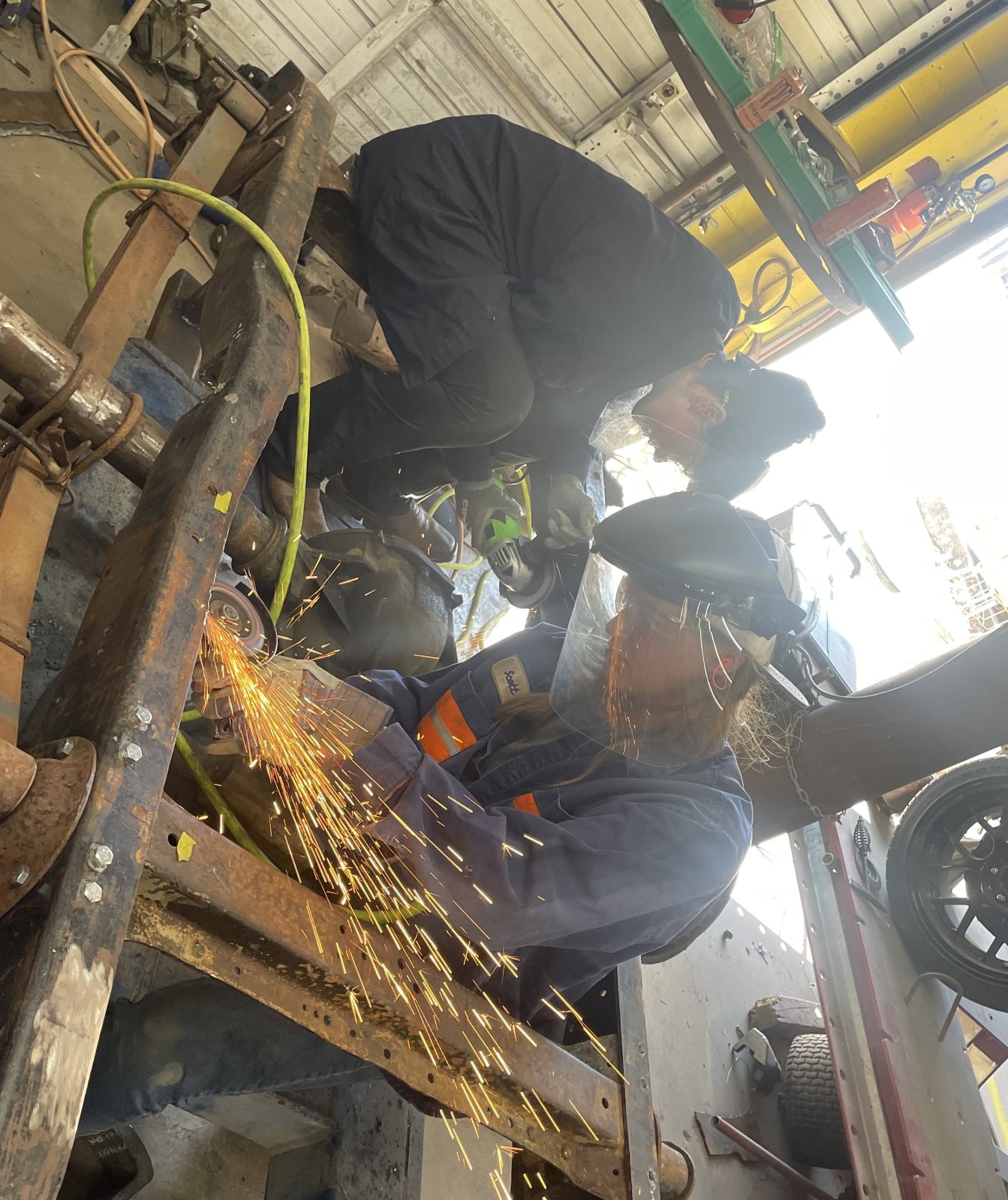

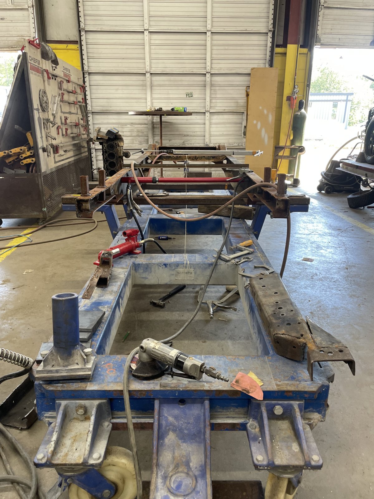

  4. We had a Car-O-Liner frame bench donated. With mechanical measuring. This year we’re covering welding and cutting. This 57 Chevy truck ch***is is one of the projects.
    these make an excellent ch***is build bench.
    We’re removing some poor frame mods.
    Might even do a HAMB era friendly graft with a 64 c10 front suspension set up I have. :):) Ive always liked the rear trailing arm set ups those have. I’d like to install one on this.
    Students located the bench centerline, cut tubing to mount the ch***is, squared the ch***is with a porta-power and tacked in a spreader bar. Center and rear frame sections are now square and centered with the bench.
    welding students cut plates that mount in the side track system of the bench so we can support the rear during the C-notch and front pieces during construction

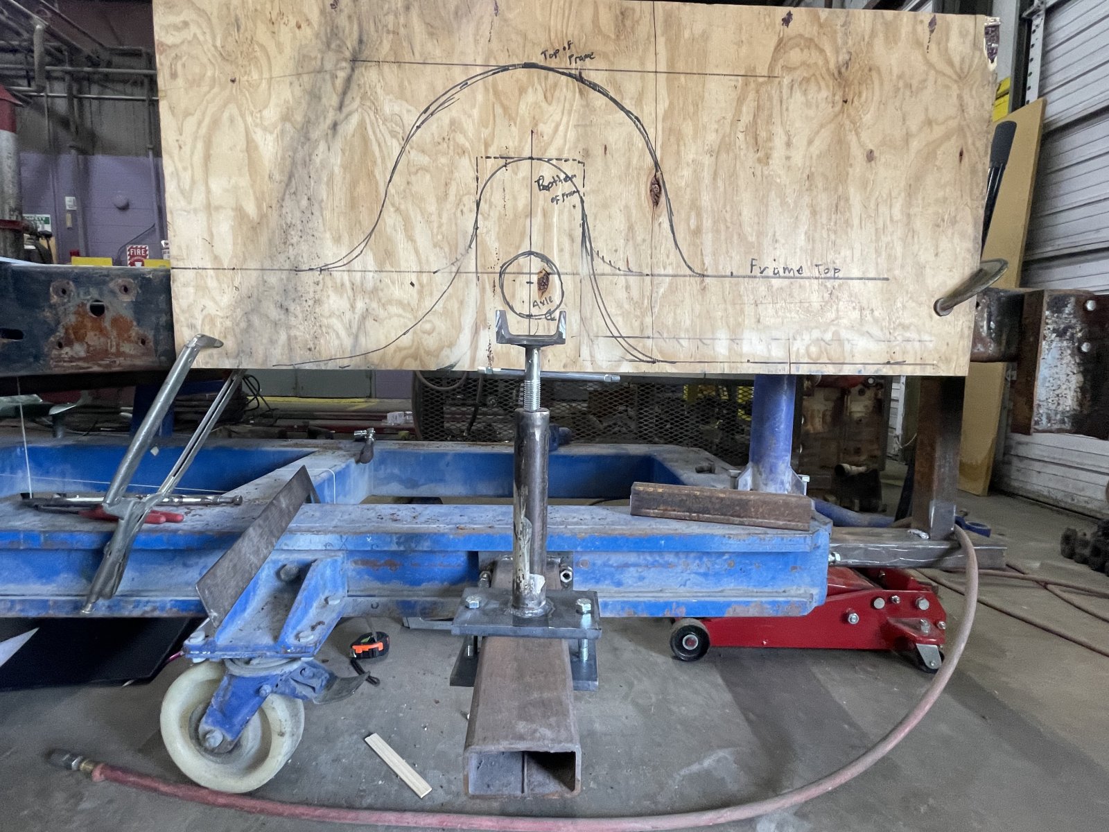

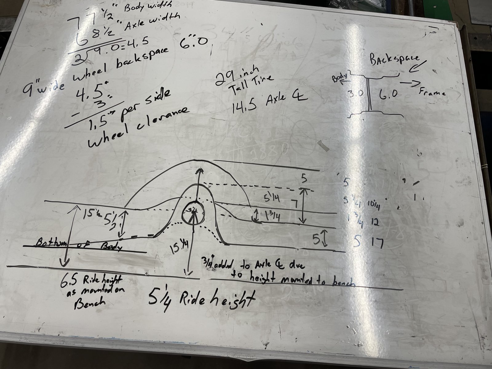

  5. 57 ch***is progress.
    Lowering math cl*** today
    plywood pattern started.

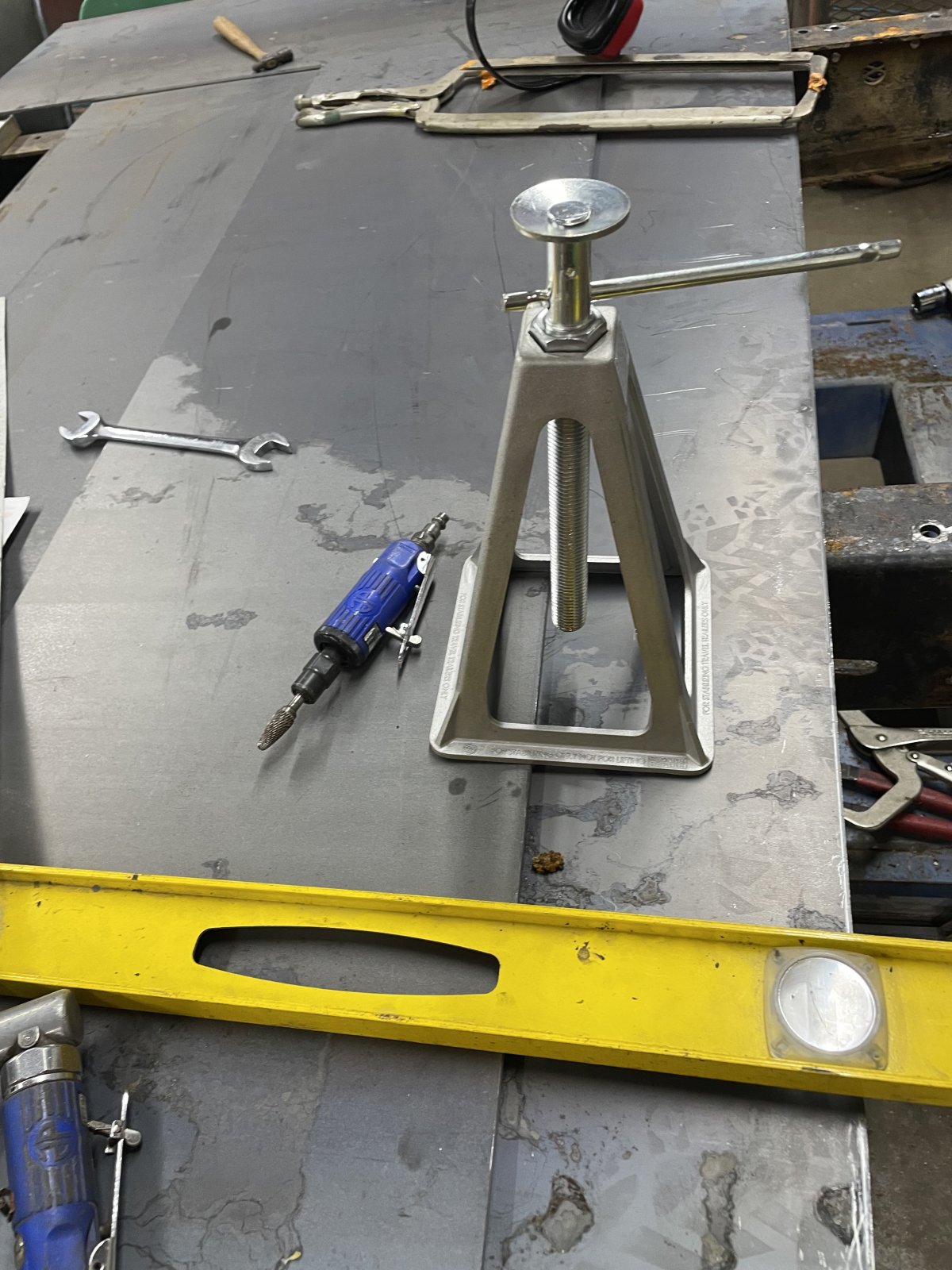

    Welding students built jig platforms and this adjustable rear axle holder
    picked up 4 of these camper stabilizers to build the adjustable fixtures from. $10
    3/16 fresh drops from my s**** yard for $36

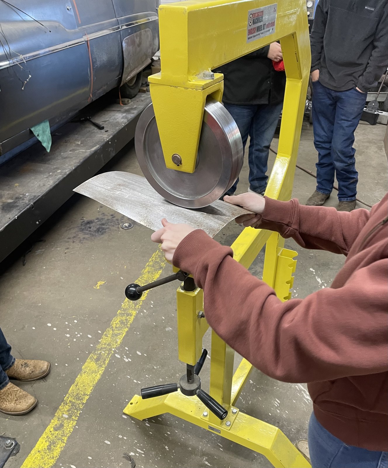

  6. We had an English wheel donated.
    Making some patch panels.
    This HF wheel isn’t too bad.

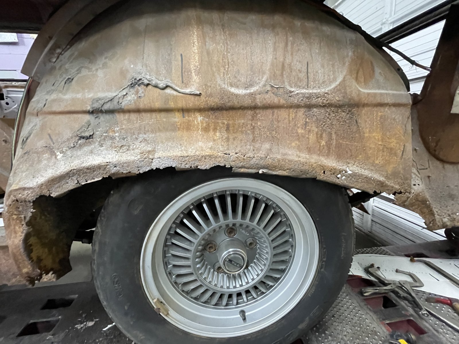

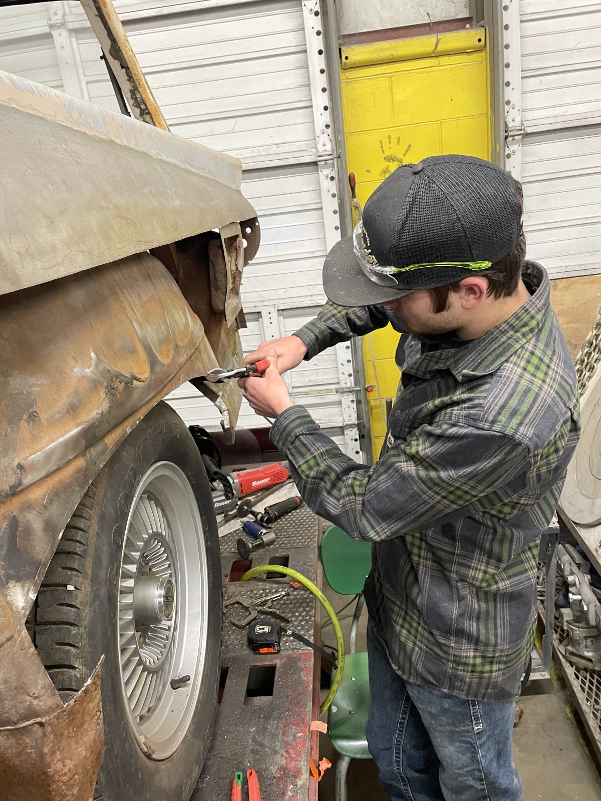

  12. Roughed out a wheel house patch
    Students made the pattern
    Only hammers and a sheer so far
    not bad for about an hour and a half worth of work
    They will fine tune next week

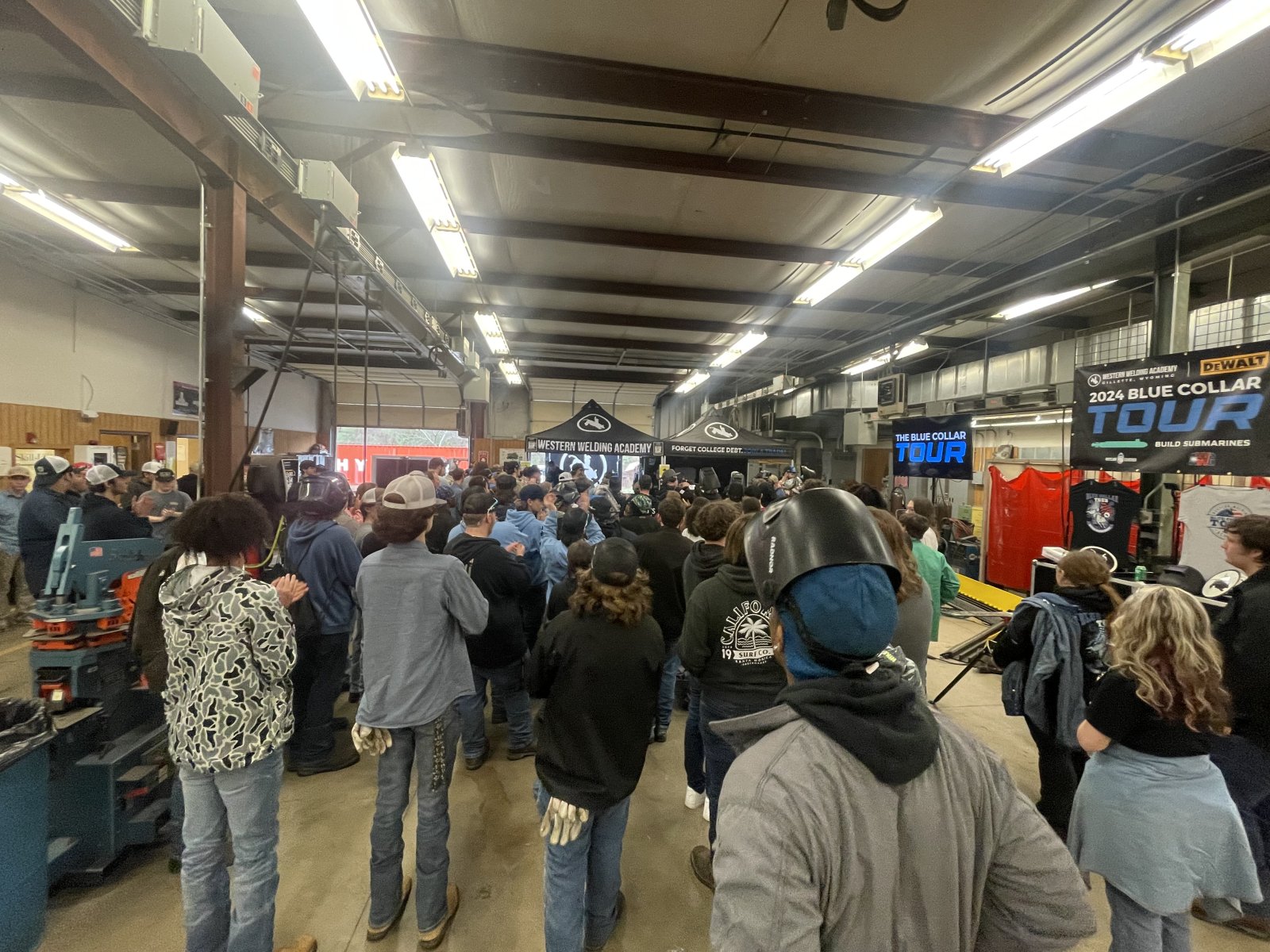

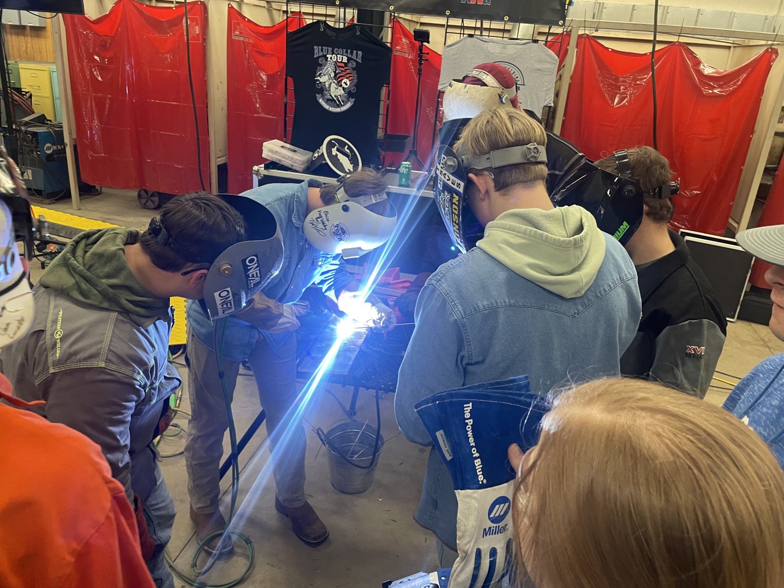

  18. Our school hosted Western Welding Academy
    welding students from around the state
    Real welding along with simulated IMG_7038.jpeg IMG_7037.jpeg IMG_7040.jpeg IMG_7039.jpeg Over 500 students were on hand to talk to several trade unions, schools and job opportunities.
    about 1/3 of the students today
    brEad, Cosmo49, Crusty Chevy and 13 others like this.

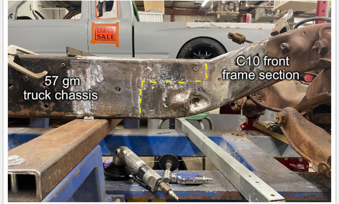

  20. Hopefully a forum friendly graft. 63 to 66 frame graft to a 57 Chevy ch***is.
    It was cheap. Most folks go after the 73 up stuff. The earlier ones are just as easy to mess with
    Both frames are 34 inches wide.
    The inside will be plated.
    The 57 frame was taller than the c10. The graft area was chosen to blend the 2 different heights together.

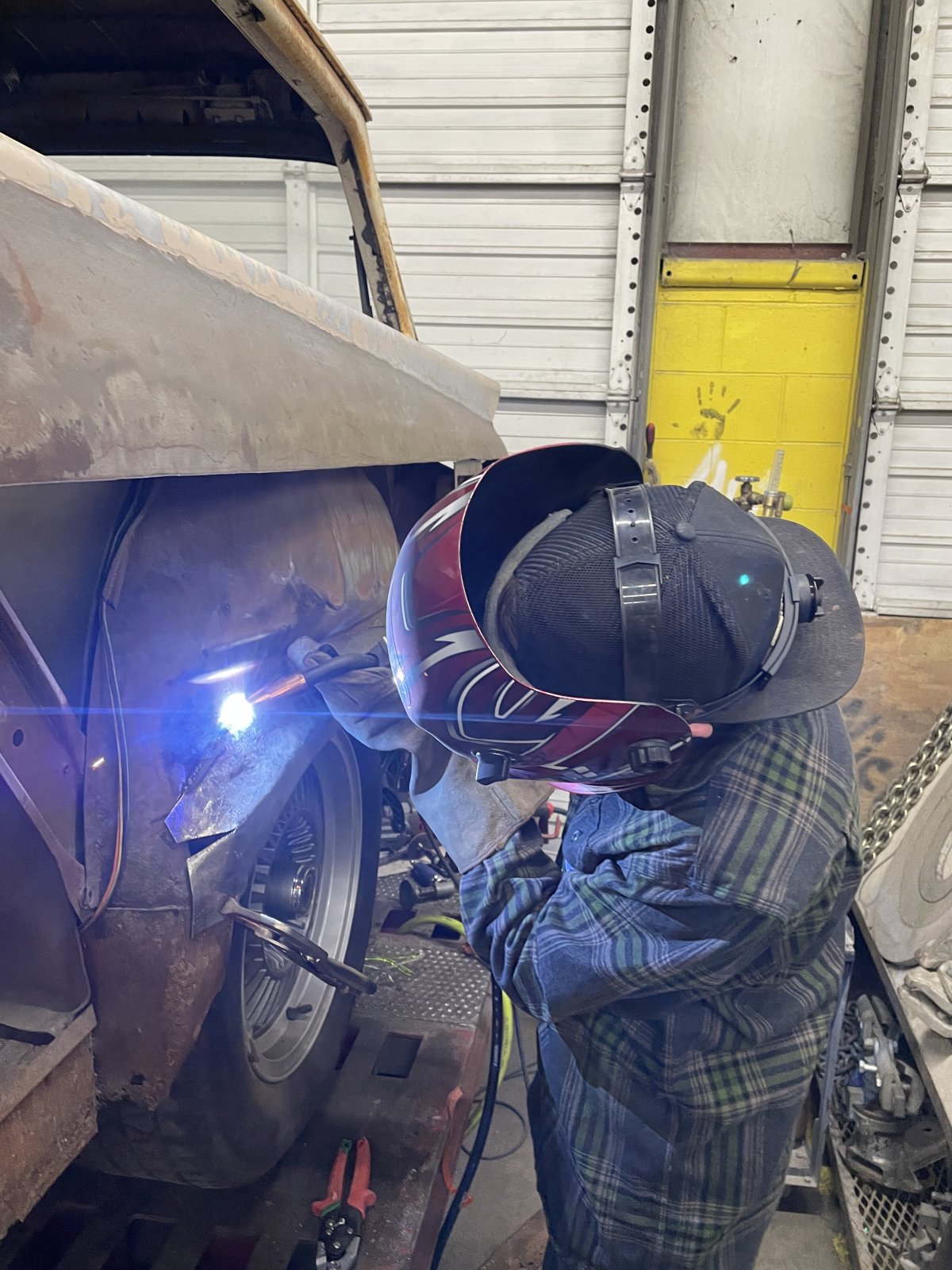

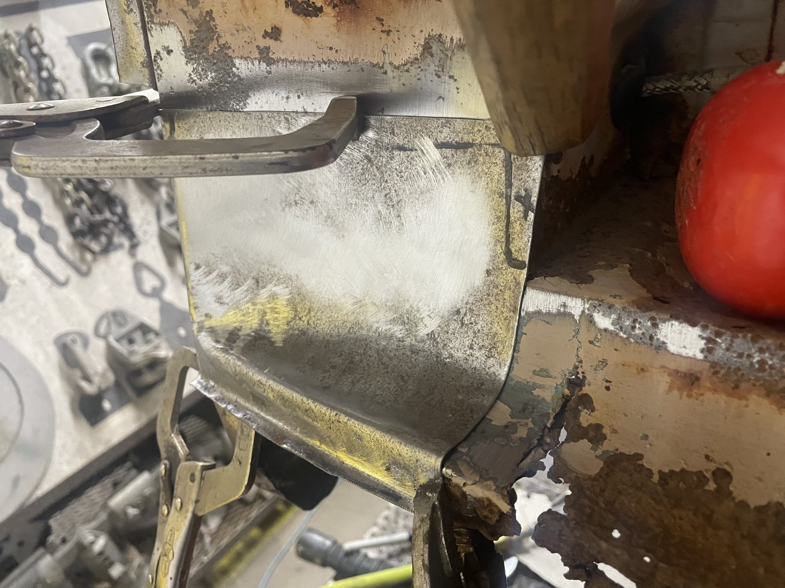

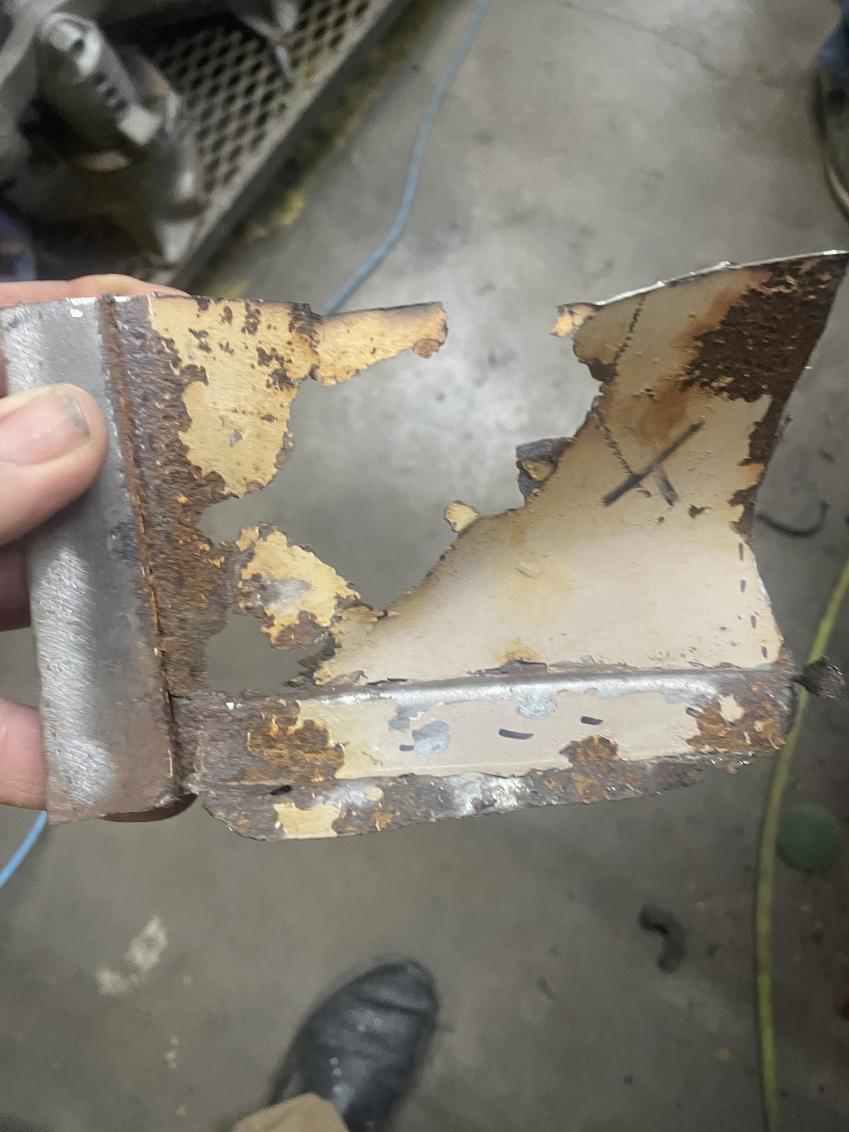

  23. Well, we try.
    No overlaps unless it’s a factory seam.
    It finally clicked for this young man
    Fit, scribed and trimmed the piece on his own. Laid down a really nice weld.
    Biggest gap to fill was probably less then the ,023 wire being used.
    He texted me later in the day for those pics I took.
    I really like when they take or ask for pictures

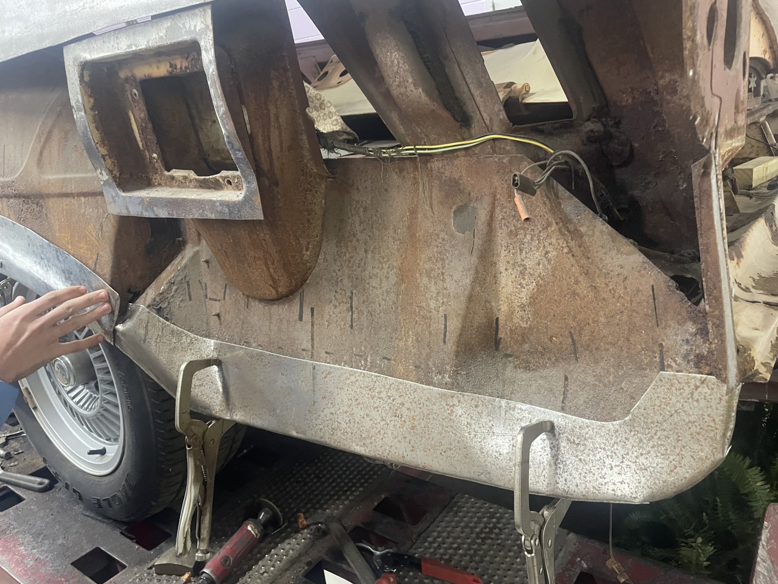

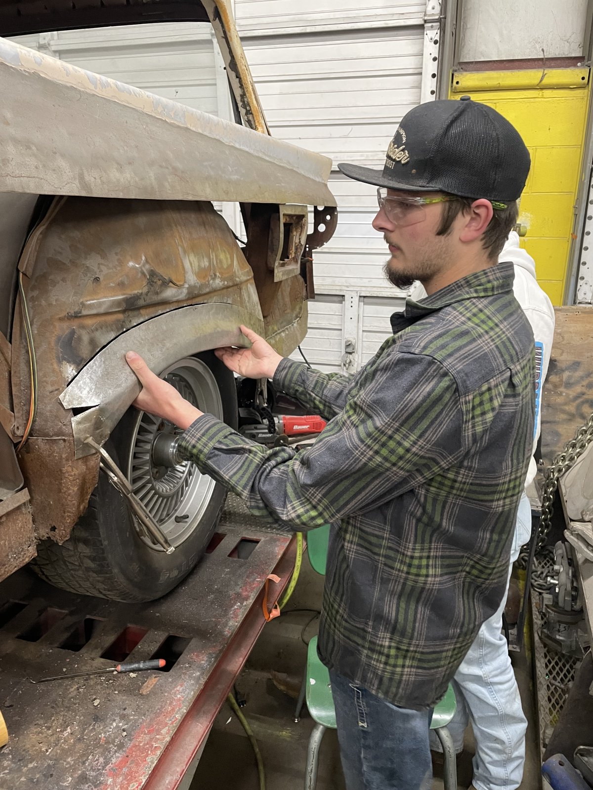

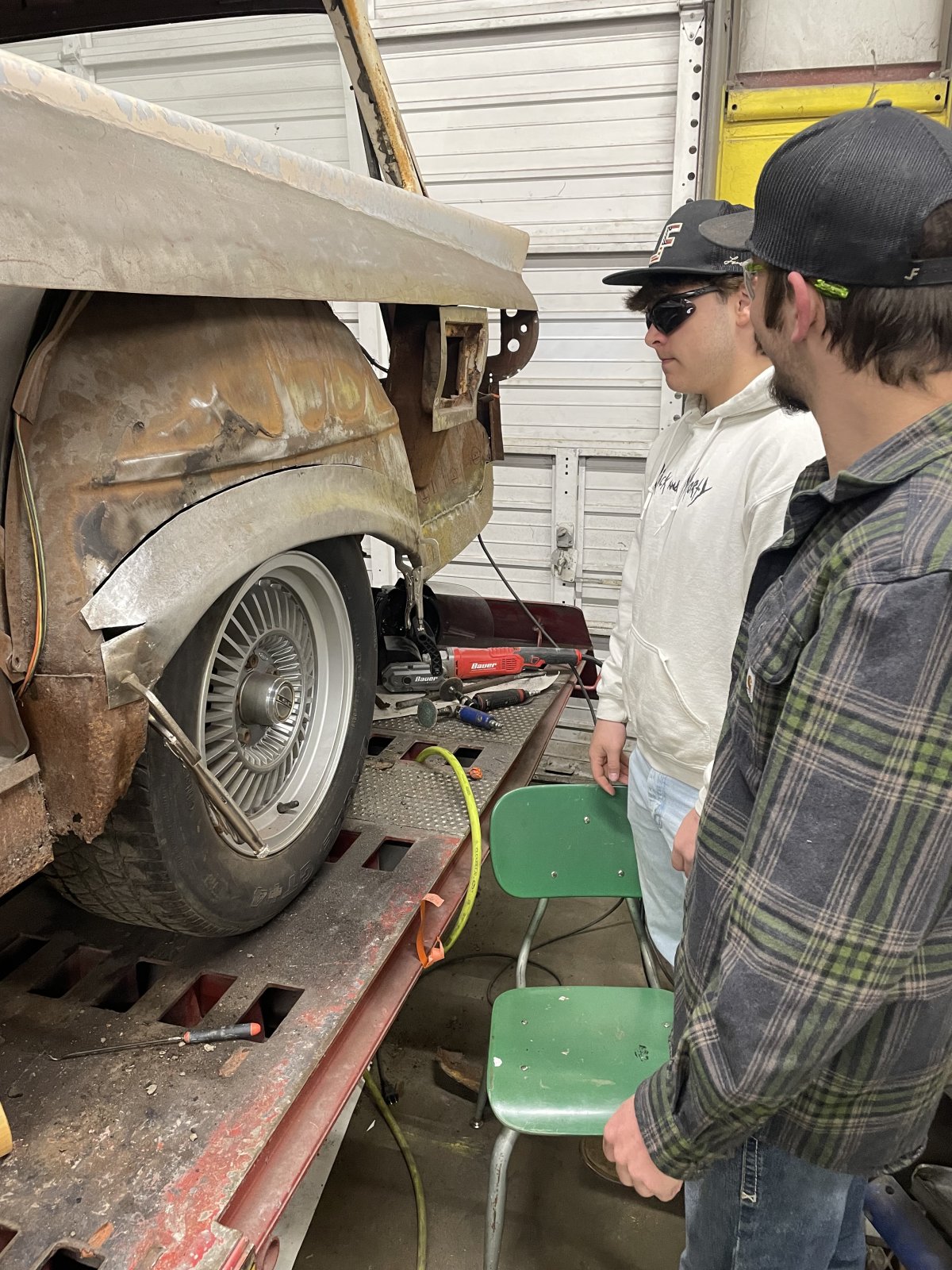

  25. Same student started building this corner for the rear body
    made a pattern had it roughed in our 1.5 hour cl*** period.
