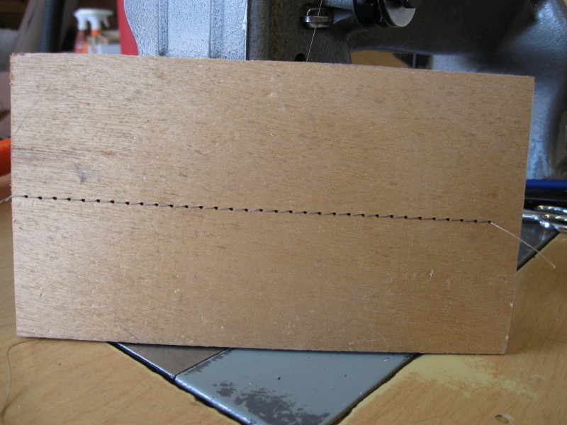

    An experienced sewer may be able to find an industrial sewing machine store that would let them use one of their machines, but I doubt they would let a beginner use their equipment. "Walking foot" is a generic term for alternating presser feet, and is a type of industrial sewing machine, it is not an attachment.
    There is no attachment that turns a machine with a presser foot into a walking foot. Here is a picture of an industrial sewing machine that has a walking foot. The two rear vertical shafts hold the two parts of the foot, and go up and down alternately. (hence the name alternating presser foot) When one is up the other is down and vice versa. That means the machine always has some part of the foot in contact with the fabric and is able to sew the fabric together better. If you look at Dana's machine, it has only one other shaft that holds the foot, so it does not have a walking foot.
    Also, this machine is compound feed, which means it has two or more feeding systems. This one has needle feed and drop feed. The needle pulls the work forward (needle feed) and the upper and lower feed dogs (drop feed) push the work forward. Home machines are almost always needle feed only.
    There are a lot of things you can sew with a home sewing machine, but there are a lot of things you can't sew with a home sewing machine too. The thicker the work you want to do, the less likely you will be able to do it with a home machine. If you want to make a living doing auto upholstery, you need an industrial single needle, compound feed, walking foot sewing machine.

    An industrial machine will easily sew through 1/4" plywood. You can't go real fast, and your needle will be shot when you're done, but it will do it no problem.

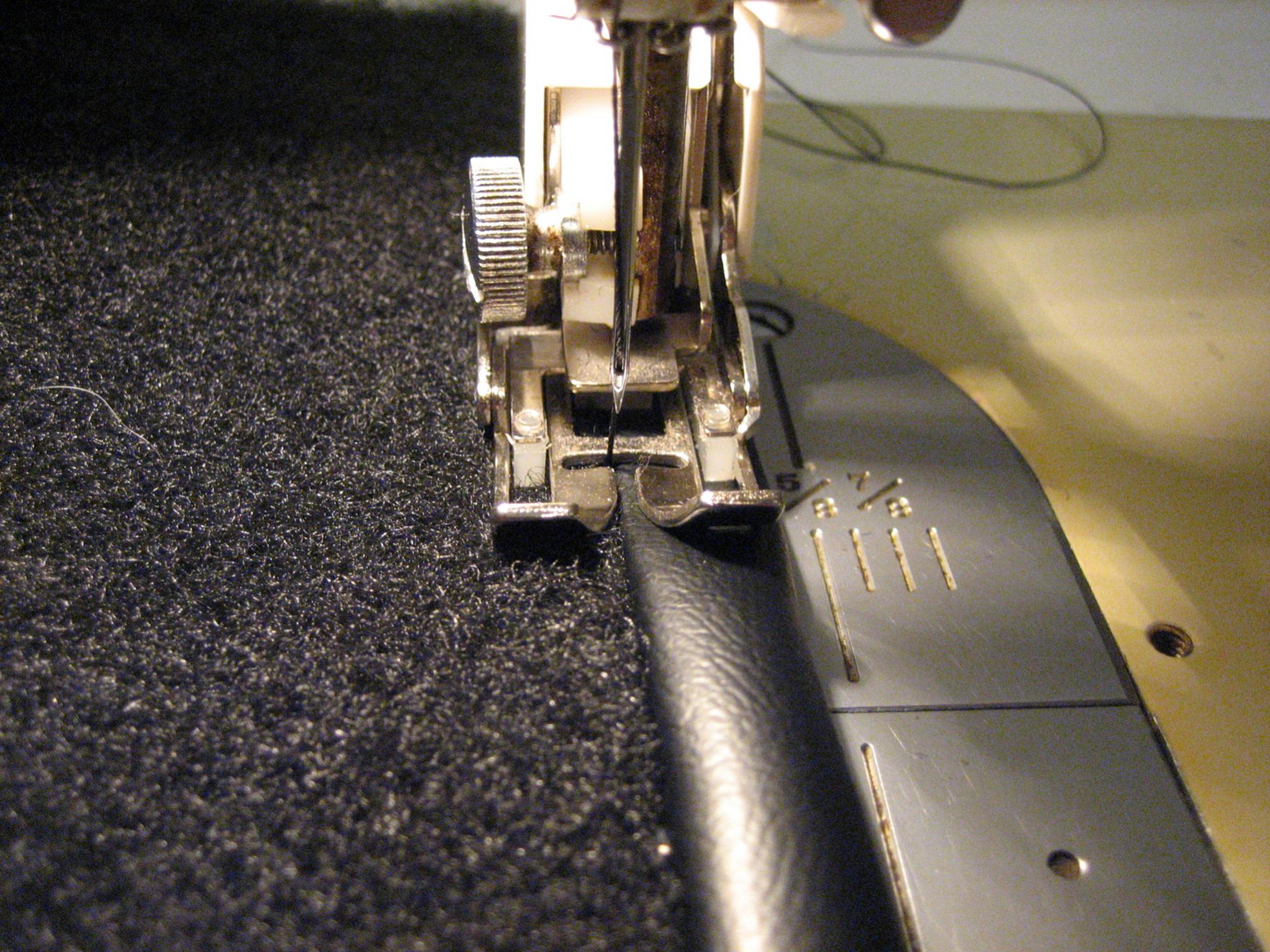

    Got'a make some patterns from paper or cardboard ,leve about 1/8in. to 1/4in. less all around,this lets your binding have room. You'll need to check fit with stuff your using for actul space=test. Deside what parts you need binding on and what part you can just sew together,or lay under others.
    The rug I'm using here is auto carpet from upholstery supply store,it's just like speeker box cover as far as I can tell. There is a few dif types out there,but this one has very small bit of flex that helps bumps,but not much.
    To add binding to rug, I cut a strip of vinyl 1.5 wide and staple it on top of rug ,vinyl upside down close to edge,you can stitch a line about 5/16in. from edge.Then turn it all over and remove old staples,then add new staples to hold vinyl around edge so next you can sew from top in what is called"The Ditch"= sew right along between rug and vinyl,this holds your binding inplace from the back side.:cool:
    This should show what I'm talking about.
    After sewing first line,remove staples,pull around and restaple it under.
    Do not put any staples were your stitch lines are going.
    Last photo shows stitching in the ditch from the top. This also shows how nice the edge of rug ends up looking
    You can cut as I did the extra salvage off from that under lip so there is a bit less bumps under carpet.
    We end up with a pro looking edge to our rugs that is also seen last photo.
