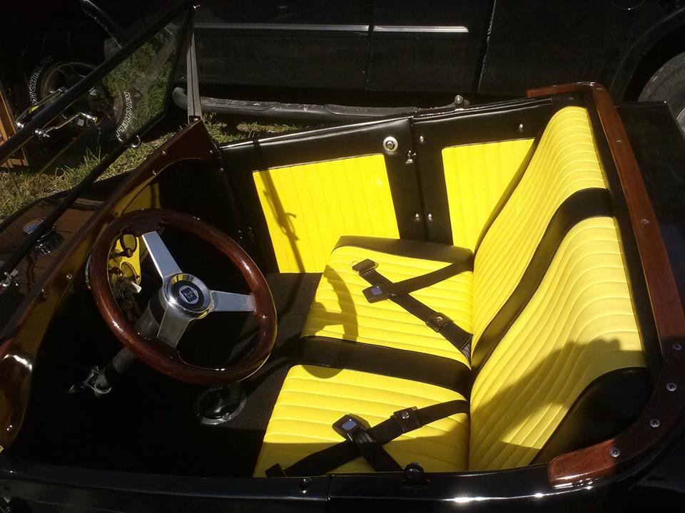

    1412681_565659486857251_679930928_o.jpg Got the old rod up an running:D,still a few little things,but there always is,part of the fun. Will be buffing out the paint an then put the name on "Déjà vu". :cool:
    Here's a shot or two of how its looking now,later I may be able to post a video.

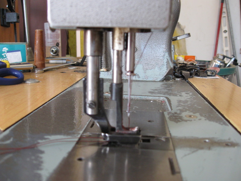

    I hate to rain on your parade, but "walking foot" is not an attachment for a sewing machine. Walking foot is a generic term for alternating presser feet. In order to have alternating presser feet, the sewing machine needs to have three vertical shafts, one that holds the needle, and the other two each hold half of the foot. (see picture) When one side of the foot is down, the other side of the foot is up, they "alternate" so that something is always holding the work down to the table. The only way to have a "walking foot" is for the machine to be built with those three shafts, you can't add an attachment to make your machine something it isn't.
    Also, industrial machines have compound feed, (drop feed and needle feed) that work together while most home machines only have needle feed. Can you sew an interior with a home machine? Sure, but you will be limited by the thickness of what you are sewing because the foot won't lift as high on a home machine. The more thickness, the less the home machine can sew, both because there's not enough room under the foot, and there is only needle feed pulling the work through the machine. When there is too much thickness, your stitches won't be uniform in size.

    I thought my industrial Singer from the 30's would be great to do my own interior. It's a beast of an upholsterer-but not a walking foot model and it's got a simple foot operated clutch that connects the motor underneath to the machine- so it's either off or full speed- not something i want to try as a first timer with a car interior-no way to slow her down. -rick

    That Rex has a foot speedcontrol I beleve, Just like my housewife one dose and that helps a lot{you can run slow],we need that for us that are learning. Also I do hand crank the wheel on the end of sewingmachine with out foot power on when ever I'm running around a corner or a place that is hard to do,so each stitch can be were I want it. Takes more time but the control of hand cranking the wheel is way better.
    I did try one from a dress shop that was as 69fury talked about,I even try slowing it down with def pulleys,but just too fast no matter what I did to it,so gave it back to my buddy who was nice enought to let me try,he dose not sew ether,but had got it from his mother yesrs ago.
    The REX shown is a good for our hobbie,its sold under a few def names but you can tell by looking the one are same with def names on them. The arm opening is same as my Kenmore on most of those,but they do make some with 9in. vs 7in, that 9in. is a little EZer to get more of your sewing through under the arm,but cost about a extra $130 over the $300 type like that REX ;http://www.ebay.com/itm/Alphasew-Po...072?pt=LH_DefaultDomain_0&hash=item5672f75848
