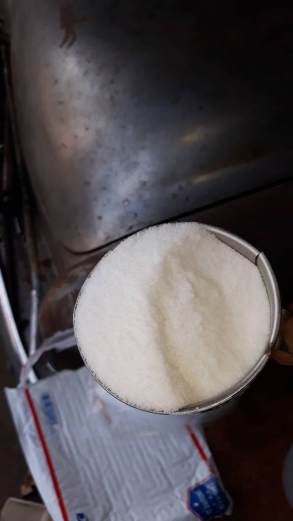

    Im sure what the chrome shop uses for an acid bath is far more potent than this. In fact this stuff is sold for making bath bombs, its that mild. I dont see any reason a soak in soda bathing wouldnt get in the seems just as the acid did, and in turn neutralize any residual. Don't over think it guys, the best way is order some and experiment for yourselves. Its rewarding and kind of fun to use once you realize the possibilities. Thanks for everyones input on the thread, I've learned some things myself. Thats what I like about the Hamb, the sharing of our collective knowledge makes this place a wealth of info.

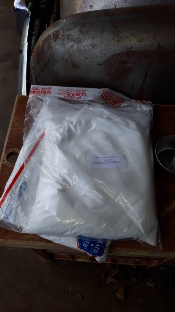

    @Jimbo17 I just went on ebay and search "powdered citric acid" and looked for the best price. The sticker on the bag says www.soapandthings.com I think it was about 16$ free shipping for this 5lb bag. Or If you dont do ebay Algoma56 said its available on Amazon as well. I've only ordered online, not sure of any local retailers.
