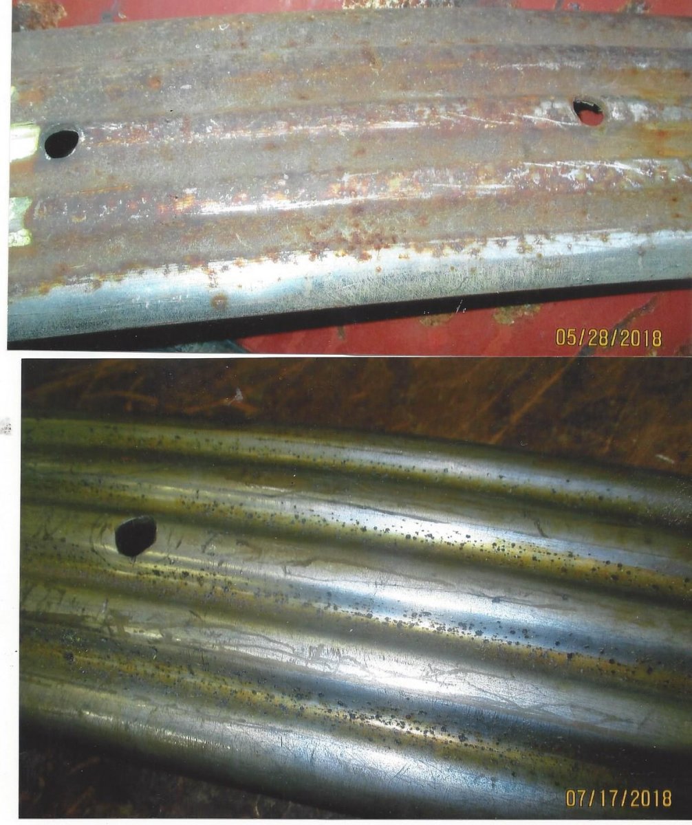

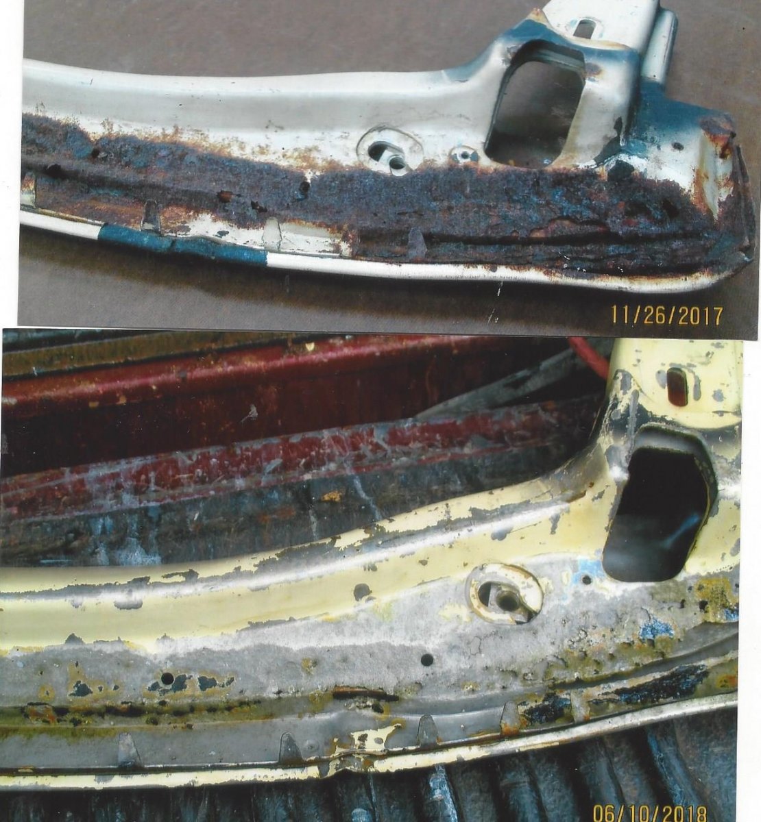

Technical Tech: Simple rust removal with citric acid
