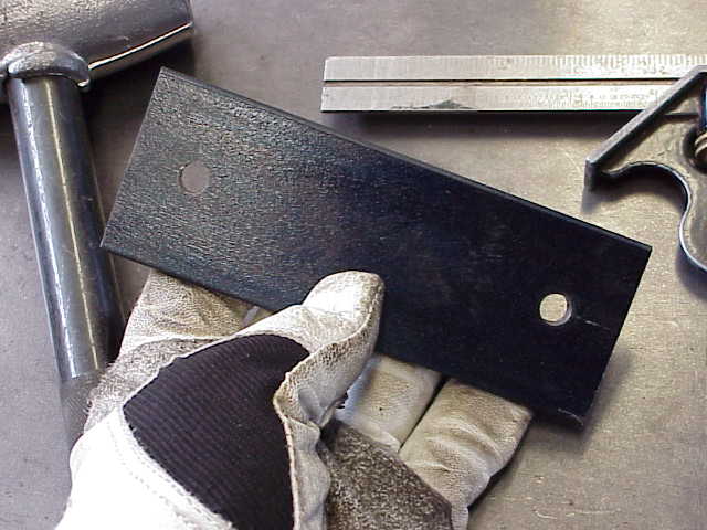

    There was some discussion recently about square holes. Here's a crude way of making holes for carriage bolts. It's pretty quick, and involves a hammer, so it's the kind of thing I like to do.
    I want use carriage bolts to attach the headlight stands on the Ferguson roadster.

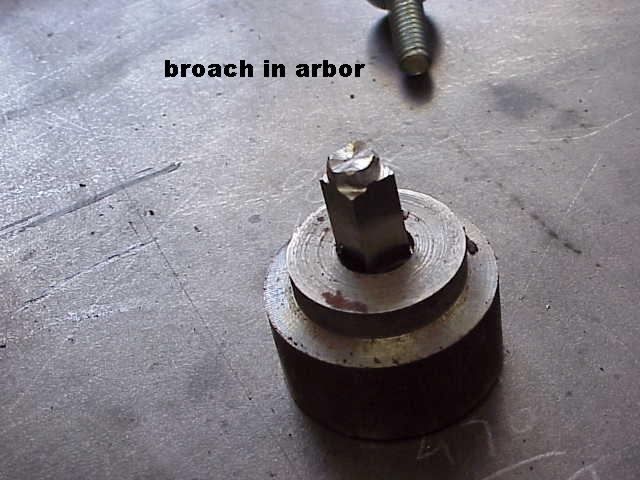

    Start by drilling 5/16 holes in the parts. The square broach is a 5/16 square tool steel lathe bit. I drilled a 27/64 hole in a s**** of shafting to serve as an arbor for the bit. It just presses into the hole. Then using a cut off wheel, I knocked the corners off the broach forming a rough pilot about 5/16 diameter in the center, and leaving sharp cutting edges at the corners.

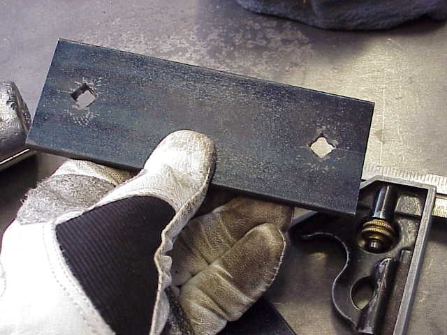

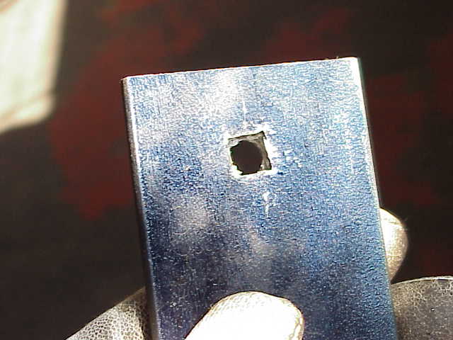

    Using a hydraulic press, push the broach into the part until it marks the corners of the square hole. (I'm using 1/4 in plate for these parts, on thinner stock, or aluminum, you may push the broach right through.) Then remove the tool and clean up the corners with a square nose chisel. The second p*** with the broach finishes the hole except for some minor cleanup with a file.
    Time for 8 holes including making the tool was about 2 hours. Crude but effective.
