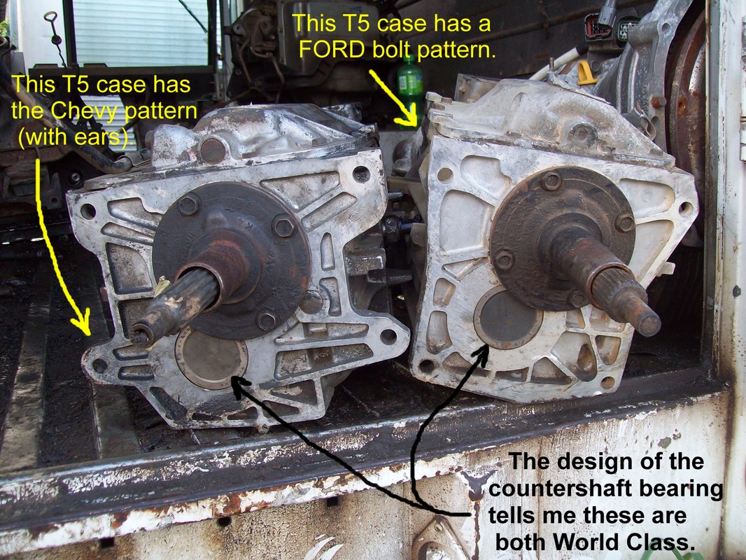

    I have a 93 Camaro/Firebird T5 going into my 63 Ranchero. It has the Ford bolt pattern.
  2. gimpyshotrods
    Joined: May 20, 2009
    Posts: 24,629
    gimpyshotrods
    That's still the good old GM pattern.
    If it were a V6, it would have the Ford pattern.
    The easiest way to discern the two patterns is to just look at them. No camera required.
    Look at the 4 bolt holes that are used to attach the transmission to the bell housing.
    On the GM pattern, the TOP two are closer together than the bottom two.
    On the Ford patten, the BOTTOM two are closer together that the top two.

    I have a 93 s 10 WC that has chevy bolt pattern...I'm told the early 93's were chevy

    The interesting thing about 92-93 s10 the 92 is non world cl*** and the early 93 world cl***.....

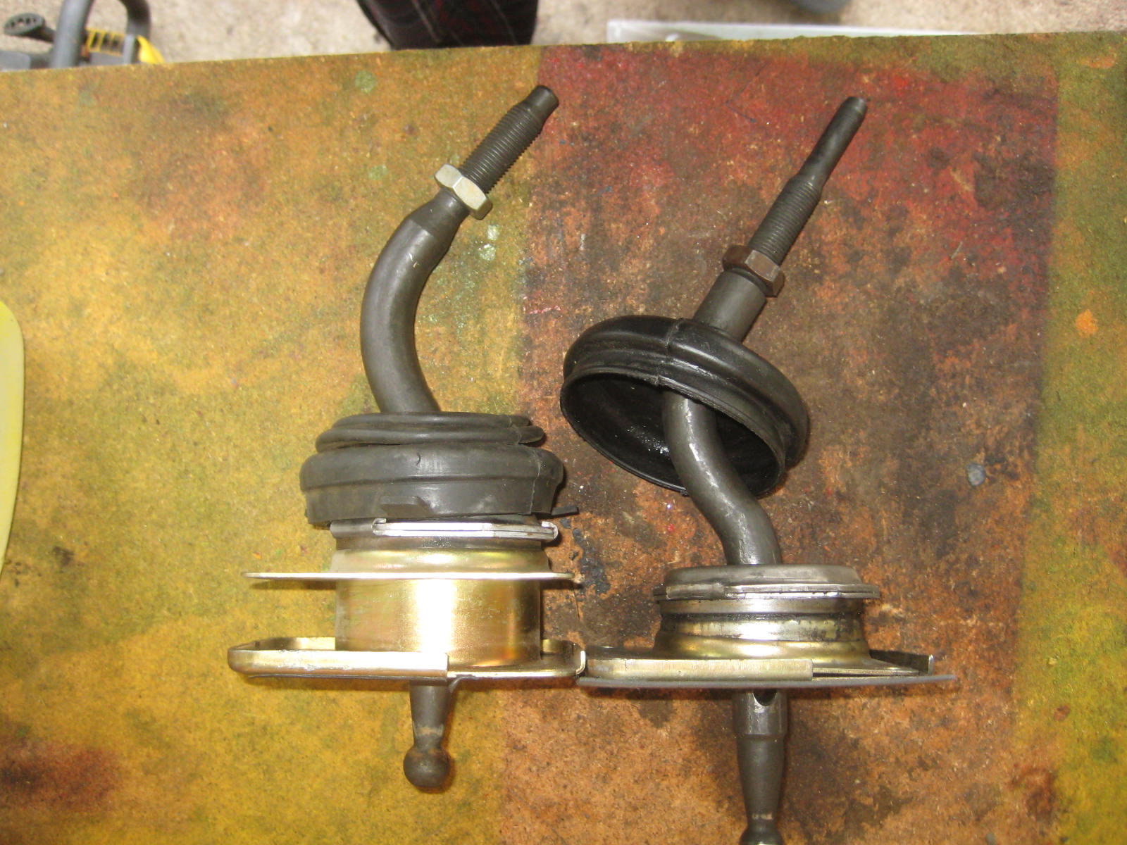

    May be old news but apparently there are two different S10 shifters.
  8. Flat Ernie
    Joined: Jun 5, 2002
    Posts: 8,406
    Flat Ernie
    Tech Editor
    I've never seen the one on the left...appears to be a short-throw

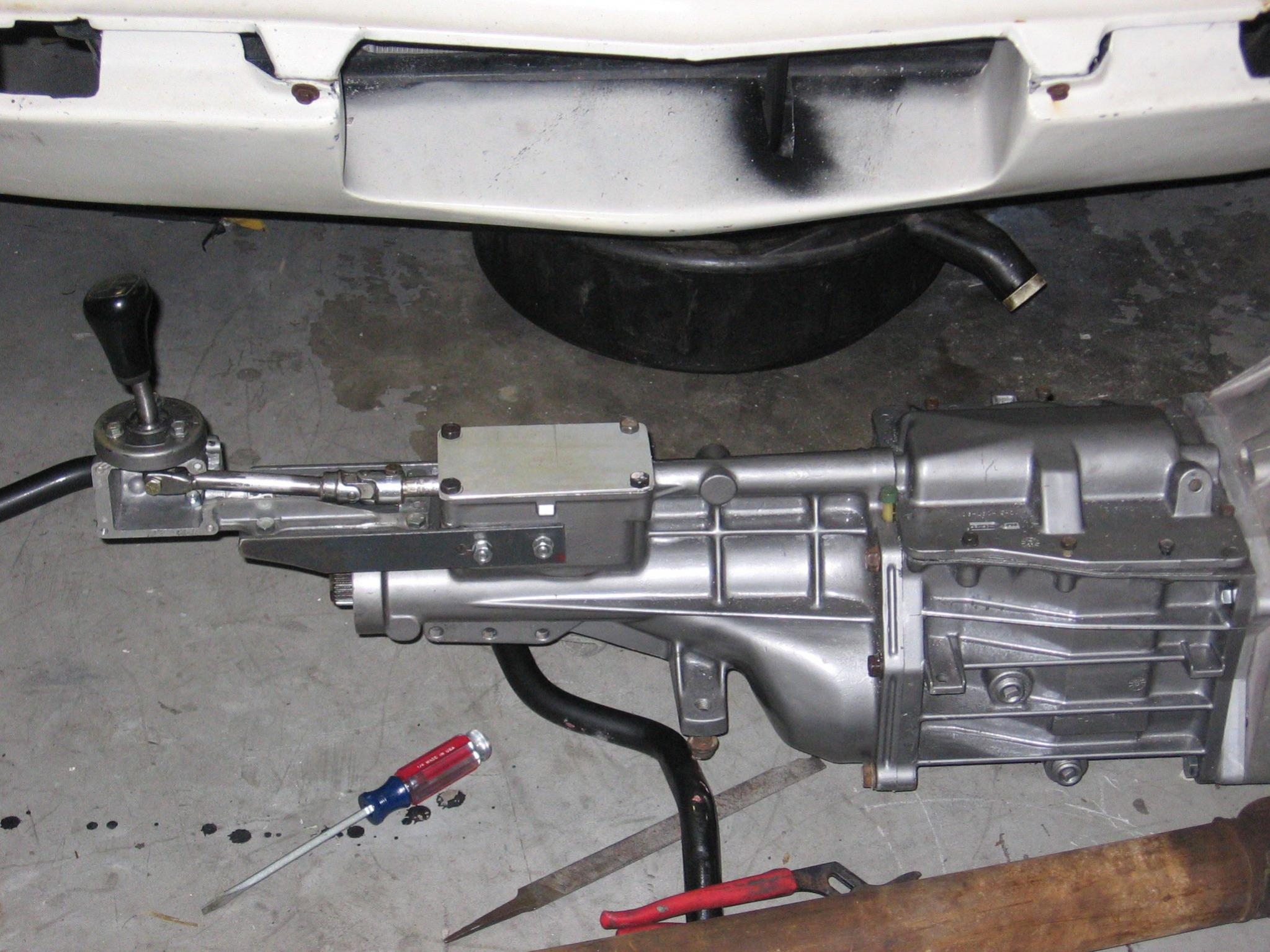

    Are you having trouble finding an S-10 tailhousing? this may be an option for some of you.
    [​IMG][​IMG]
    Joshua Stacy and indianbullet like this.
  11. chrisp
    Joined: Jan 27, 2007
    Posts: 1,363
    chrisp
    Funny you're showing that, it ressemble something I proposed to my ex shop manager (who ended up fired) on some other transmission and his answer was that it was an absolut idiotic idea... Glad to see I'm not crazy.

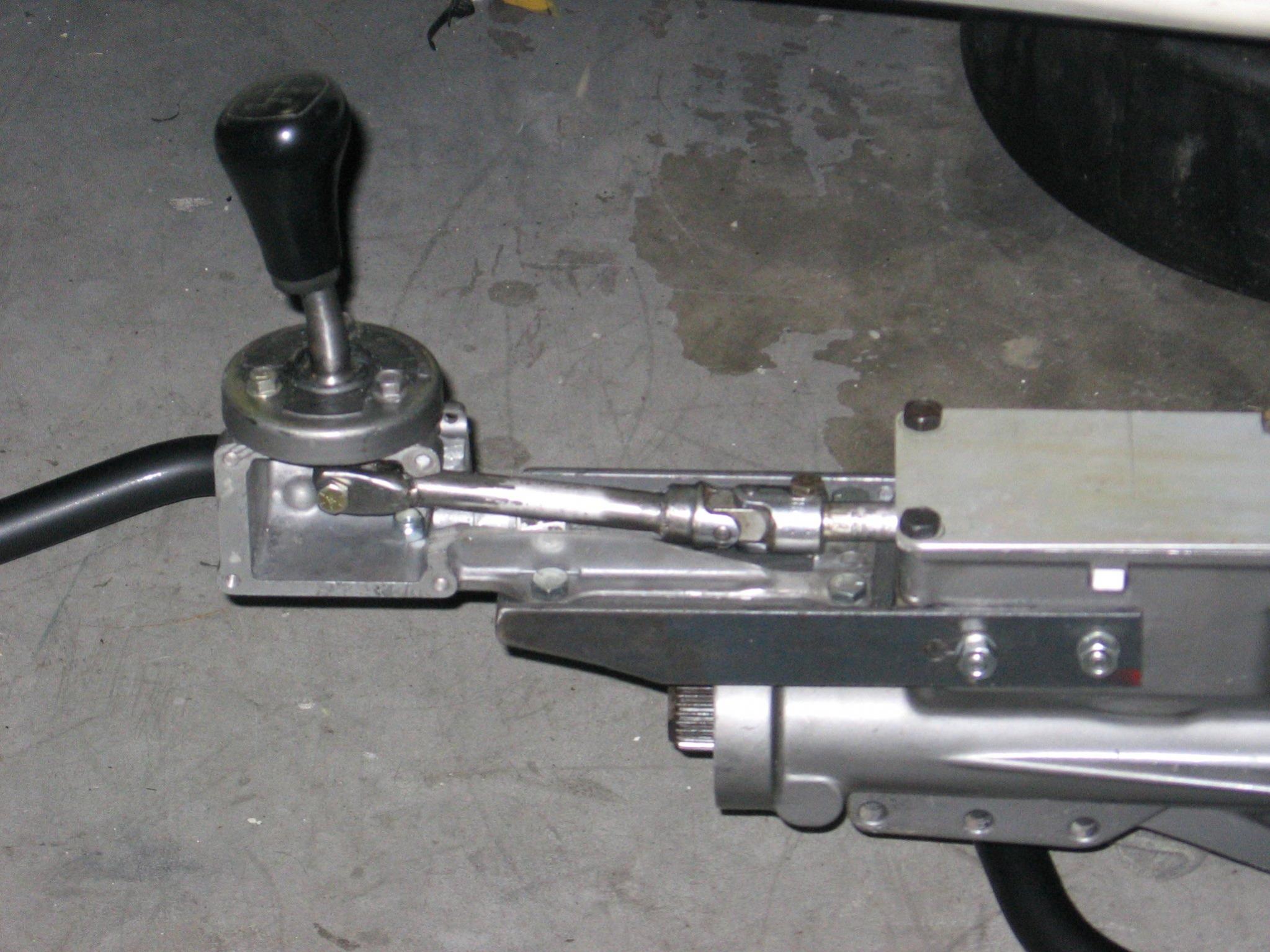

    Most of you are trying to move the shifter forward, but I once had to move the shifter on a T-5 back several inches. I used piece of a Mazda RX7 shifter and an old u-joint socket. I just extended the shift rod out the back of the shift housing and connected it to the Mazda shifter with a homemade clevis. I left the shift detents in the box.
