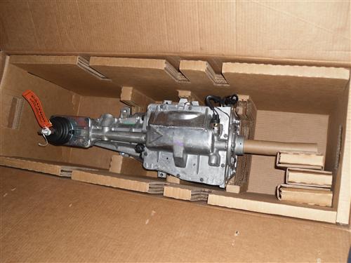

    This is how I get mine, in a box!
    Ford Racing M7003Z T5 Transmission! This Ford Racing M-7003-Z Mustang T-5 Transmission is a great replacement for a blown, grinding, or malfunctioning transmission. This 1979-1993 Mustang t5 transmission is perfect for your Fox Body Mustang build and offer several upgraded features over the factory transmission. Not only does this t5 transmission include higher performance internal parts it is also rated for more power than the factory transmission if your Mustang.
    High Quality Construction
    Ford Racing's heavy duty T-5 transmission has a 300ft/lbs torque capacity to take on the demand of high horsepower Fox Body Mustangs. With improved synchonizers, bearings, and a short throw shifter, this transmission shifts smoother and faster to give you better performance on and off the track. This World Cl*** T-5 5 speed transmission features double mold 2nd speed and 3rd speed gears with carbon fiver 3-4 blocker rings.
    Technical
    This transmission has a 1.0625" diameter 10 spline input shaft, 28 spline output shaft, and a 7 tooth speedometer drive gear. The gear ratios are: 1st 2.95; 2nd 1.94; 3rd 1.34; 4th 1.00; 5th 0.63.
