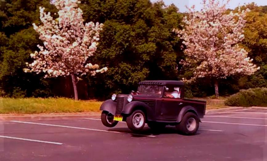

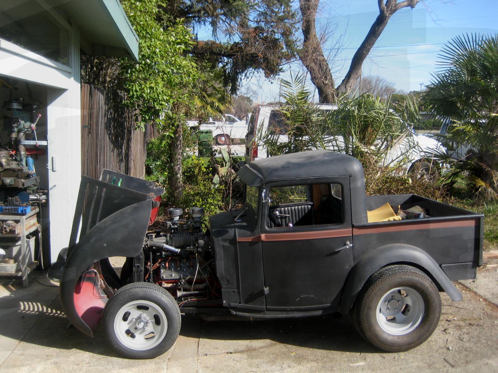

    Blown V8-60 in front, 4.10 8" in rear. 1,600lb. truck with maybe 125hp. Does have 10" wheels and wide street tires in back. It's held up to a dozen launches so far.
  11. big duece
    Joined: Jul 28, 2008
    Posts: 7,220
    big duece
    from kansas
    That is one cool pickup...

    Cool pickup! I've seen a T5 behind a blown V8-60...it was an early S10, so NWC. I think you'll be fine with an S10 T5 too. Two gear sets available and if you focus on the 86-88, generally, you should have the better ratios.
