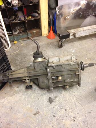

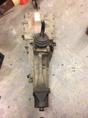

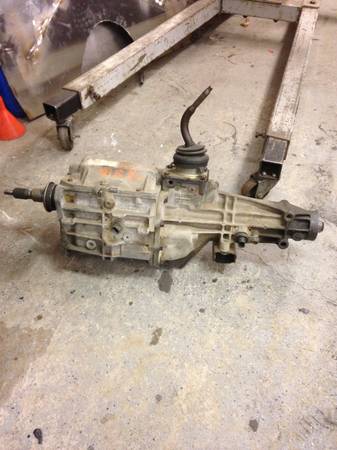

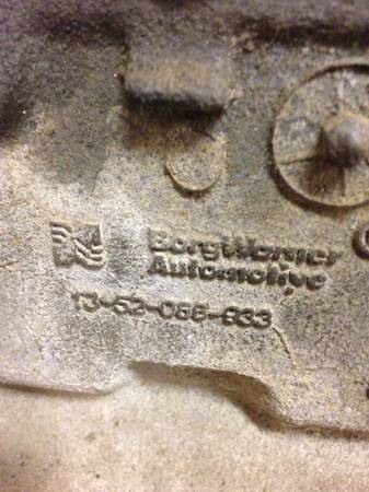

    Is this a Chevy bolt pattern T5?
    Guy says it's a 1995 S10 T5
    I don't have a pic of the front either, but have asked him to send one....
  7. Pete
    Joined: Mar 8, 2001
    Posts: 4,792
    Pete
    Think I answered my own question....
    Chevy bolt pattern would have wider bolt pattern resulting in ears... image.png

  10. Pete
    Joined: Mar 8, 2001
    Posts: 4,792
    Pete
    It's for sale locally.... Cheap
