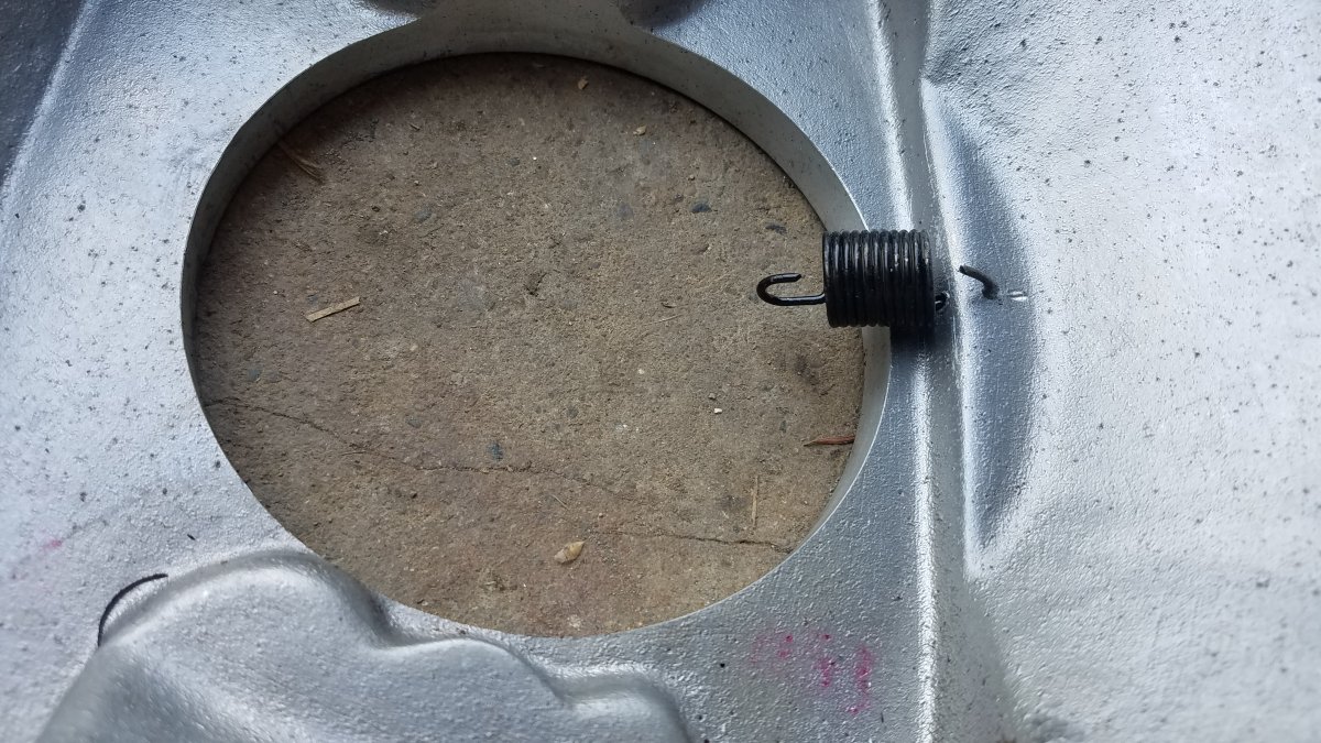

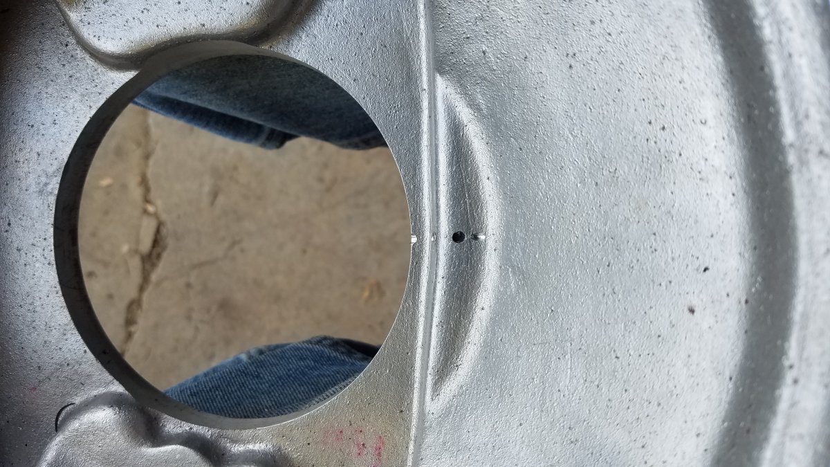

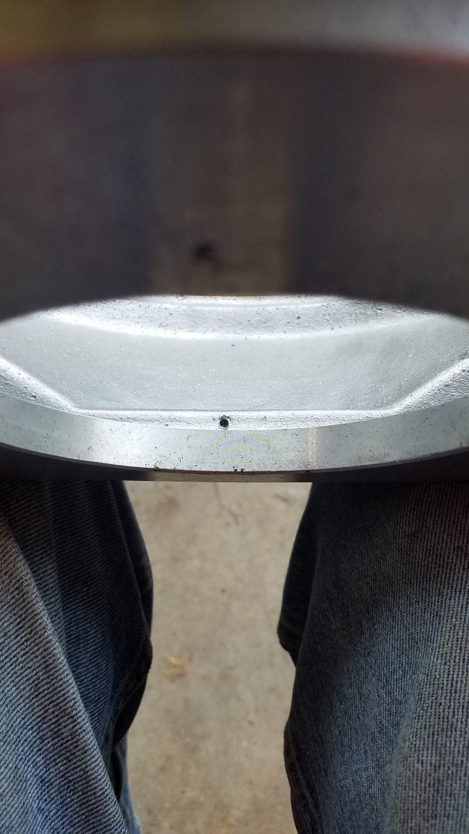

  4. Hurley50
    Joined: Feb 3, 2012
    Posts: 608
    Hurley50
    from NC

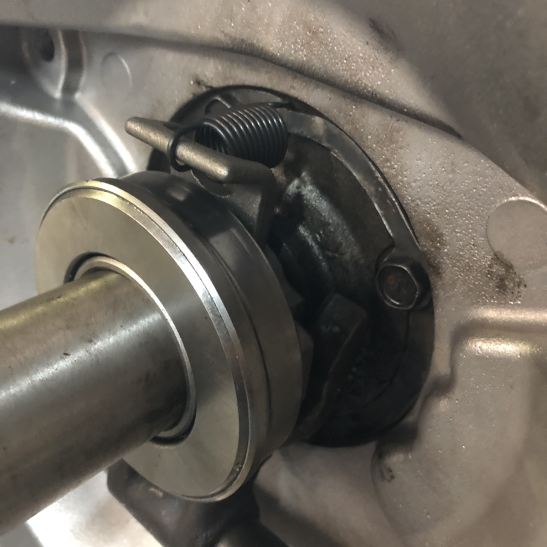

    I like this! This is how I did mine, just a small piece of sheet metal. 8bb5f0f9d384748f43abca0eed6c6764.jpg 335dd22d79da5020423a3150e696c7d9.jpg
  5. big duece
    Joined: Jul 28, 2008
    Posts: 7,220
    big duece
    from kansas
    That's a dam clever idea...

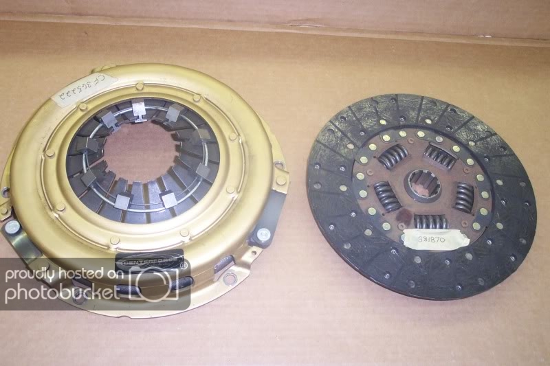

    What throw out bearing and fork are you using with the 3 finger style pressure plate? Yes the centerforce 365222 is a diaphragm style pressure plate that has a Merc B&B style bolt pattern(6 even spaced holes) same as GM too, and mates to the early style big Ford throw out bearing. This is a pic of the PP from another site... DCP_3241.jpg

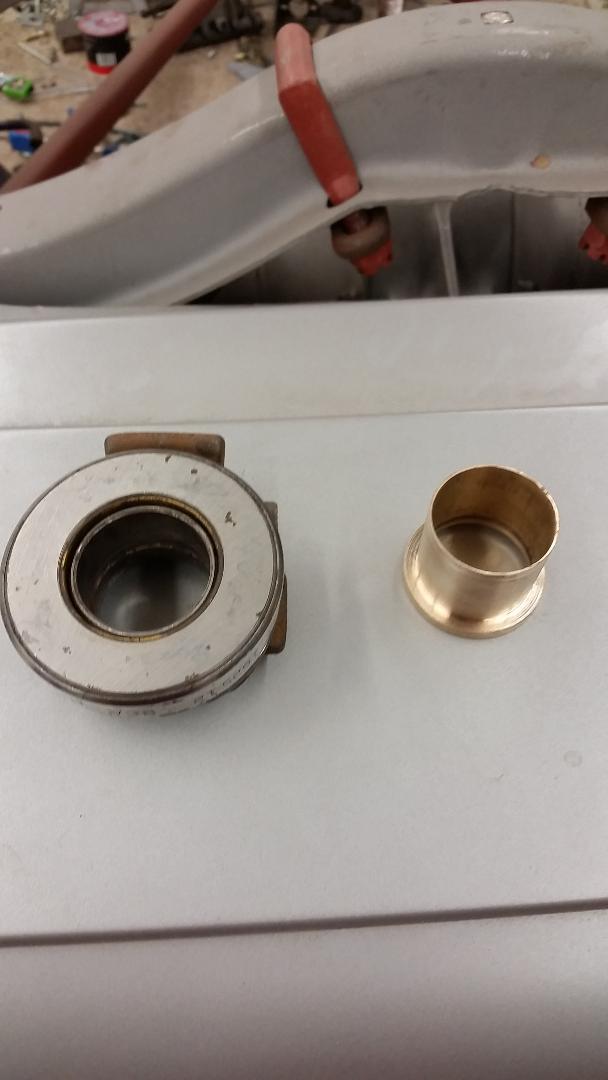

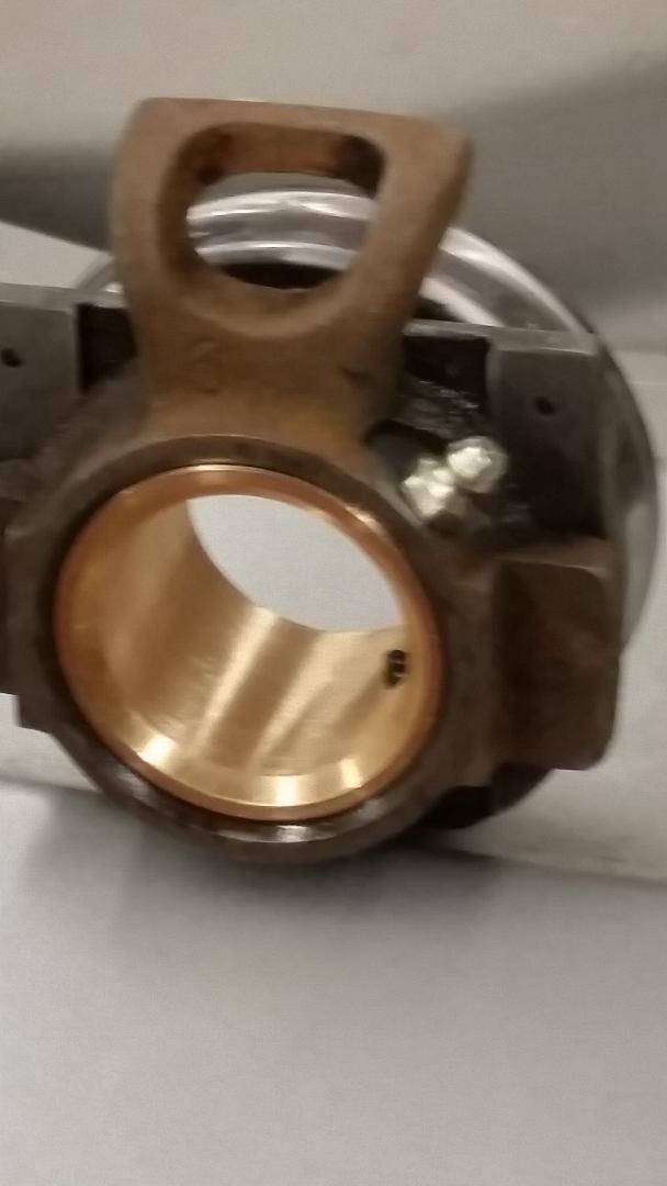

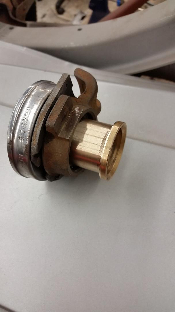

    The stock s10 pressure plate bolt pattern is different than that of GM v8, plus its 9 in diameter. If your using the Ford design with a big bearing, the centerforce 365222 might be a good option, It's 10.4" If the clutch disk you have now is only 9" , I would step up to the speedway one that I posted earlier( 10" x 1"x 14 spline). I am not aware of any small diameter throwout bearing that will work with the big Ford fork like you have, unless you custom make one. I used a stock v8 gm diaphragm pp on my flathead with a small throwout bearing I custom made, but it was a lot of work to make. Mine started out being a small throwout bearing from '51 Merc, since I can remove the bearing itself in the future. Combined with with a bearing collar from the big bearing to mate with early fork. Then made a bronze bushing lining the inside. After pressed in with green loc***e, it was honed to .003 clearance for grease. thumbnail (24).jpg thumbnail (29).jpg thumbnail (30).jpg
    brEad and loudbang like this.

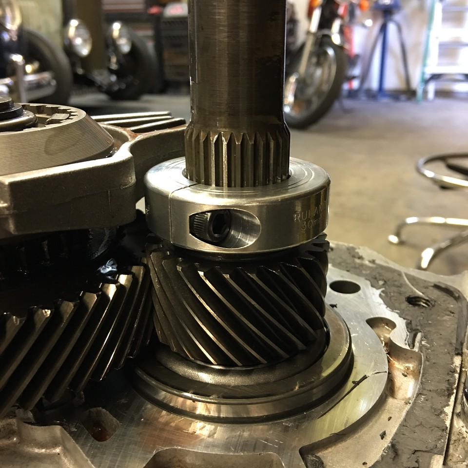

    Since this is THE T5 tech post, I wanted to add my experience. I've been running a WC T5 behind my 327 in the sedan with 3.54 gears for years with great results, but in 2017 I lost 5th in Oklahoma coming back to Austin from the HAMB drags. I made it back in 4th... shifting into 5th was like neutral, but all other gears worked fine. Turns out, this is a fairly common T5 failure caused by a failed snap ring on the output shaft which allows the 5th gear cog to slide out of place. The simple fix was to replace the snap ring with a new one (kinda hard to find), which I did. THEN, the damn thing let go again in November of this year coming back from Pistons and Paint.
    This time I searched for better fixes from the T5 experts, all of which were kluge-y at best, in my opinion. They ranged from tack-welding the new snap ring to the shaft to machining a second groove into the shaft and installing a sleeve and secondary snap ring to reinforce the primary one. I finally settled on a fix found online by a friend... install a new, strong snap ring (once you locate one) and then 'overclamp' the snap ring with an aluminum locking collar that's been machined on its forward face to fit over the installed snap ring. I used McMaster part 9520T16, and Ben at Rancho Deluxe (@lowsquire) machined the relief into it. It's all back together and working fine... time will tell!!
    Hope this helps somebody some day!!
    Pulling the trans -
    The failure - snap ring out of place, and 5th gear cog slid backward on the output shaft.
    New snap ring being installed -
    The collar in place over the replaced snap ring -
    Hnstray, teach'm, brEad and 10 others like this.

    Thx for this one. I can visualize the thrust against that enap ring as considerable due to the helical angles on the 2 gears. I'm ***uming the bolts clamp the collar down to the shaft and prevent the snap ring from expanding and popping outta of the groove so that the steel snap ring is still doing the job of holding the gear from moving to the rear.
    Damn good idea worth using on any T5 before you install it! Do you use a differnt snap ring or a new stock one?
    gearheadwelder and BLAKE like this.
