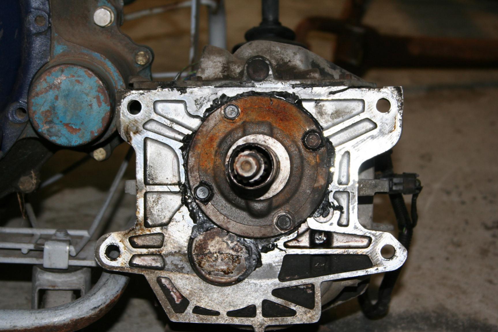

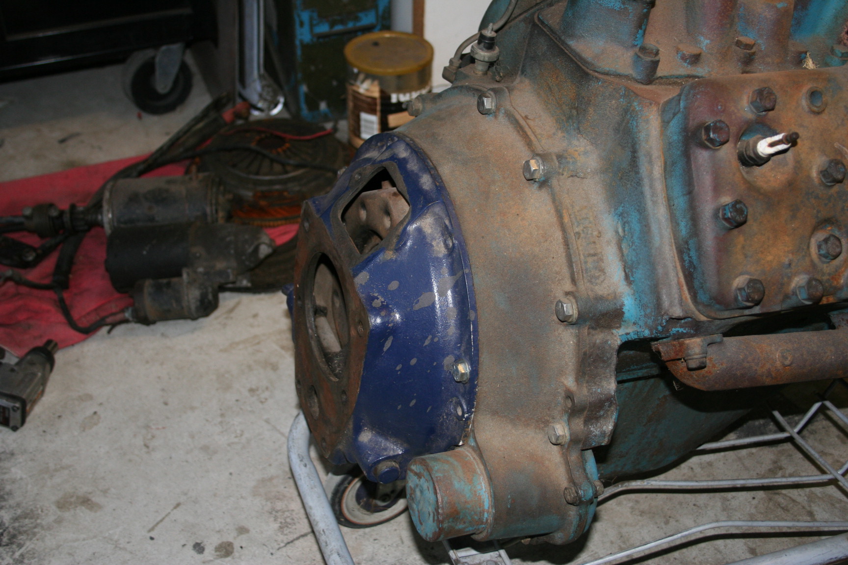

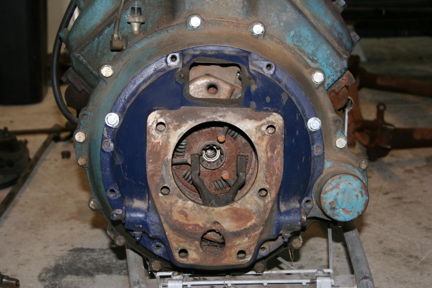

    Ernie, please help me. I have an 8BA Flathead from a truck. A T5 from a 90's S10 truck (judging by the electronic speedo). I purchased the smaller, darker colored bellhousing (attached to engine in pic). I was under the ***umption I was ready to mate the engine/trans. The holes on the bellhousing do not line up with any of the holes on the transmission. The bell housing bolt circle diameter is larger than on the transmission. Is it the previously mentioned Speedway adapter that I am now needing to accomplish this?

    Joined: May 14, 2008
    Posts: 151
    gotmark73
    Sounds like the bell housing is Ford bolt pattern and a Chev bolt pattern trans.
  11. bobscogin
    Joined: Feb 8, 2007
    Posts: 1,813
    bobscogin
    Looks like you didn't need the dark blue adapter to begin with. I think the Speedway / Offenhauser adapter bolts right to the truck bellhousing.
    Bob
  12. Flat Ernie
    Joined: Jun 5, 2002
    Posts: 8,406
    Flat Ernie
    Tech Editor
    No, what you've got there is the big truck mini-bellhousing or "hogshead". This is used with a flat-plate adapter (as sold by Dwight Bond in the write-up or machined per George's instructions). You're partway there.
    This is true as well. If you BUY a Speedway, Offenhouser, Cornhusker adapter, you won't need the truck "hogshead" and it will bolt to your ring adapter.
