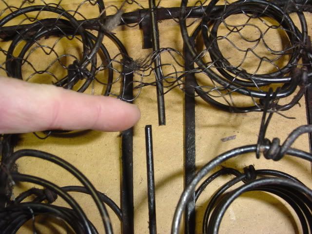

    ^ Broken here…
    ^ and here…
    ^ and here!! This damage is simple to fix, but it’ll need some reinforcing to compensate for weakness that caused the break. Also, at this time, remove any of the steel mesh that covers the spring bed. This mesh is supposed to support the padding so the springs won’t cut into it. The mesh is usually broken and rusty, and I have better solution. More on that after we repair the frame.
    ^ Take some steel brake line that has an inside diameter as close to the diameter of your frame as you can get, and cut a 2-3 inch section of line to act as a sleeve. Clean all rust and paint off the frame and slide the brake line sleeve over one end of the break in the frame, line up the broken ends and center the sleeve over the break. Now braze or solder the line in place over the break in the frame. Be sure to use flux to get a nice tight bond.
    ^ This is the finished repair. I crimped the steel line with side cutters to hold everything in place while I soldered it in place. Repeat these repairs as needed until the frame is done. Take another long look at the frame and straighten any bends. If the springs are sagging in any spot (usually directly under the driver’s ass) they can be pulled out gently to realign them, giving your springs a uniform height. This is now the foundation of your seat so take the time to get this right. If the frame is distorted in any way, your final job will be distorted as well.

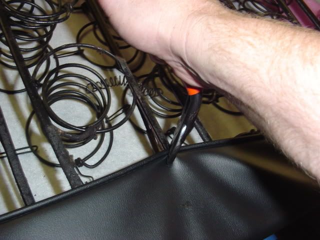

    ^ This is a hog ring in the hog ring pliers.
    ^ By squeezing the ring shut, you fasten the vinyl to the seat frame.
    ^ Lay your vinyl over the seat frame, and start in the middle of a long edge. Hog ring one side using 1 or 2 rings, and repeat on the opposite side. Now go to the remaining short sides and do the same.
    ^ Once the middles of all 4 sides are done, you can move on to the corners. Pull the vinyl snug but not too tight. Continue putting hog rings around the perimeter of the seat frame, spacing them about 2-3 inches apart. Once it’s all secured, trim the excess off, but not closer than ¾” from the edge.

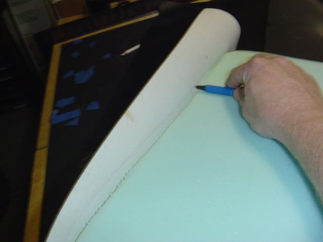

    ^ Lay your pattern on your foam, pin it in place, and trace the edge with a dry erase marker, chalk, a grease pencil or something similar. DO NOT USE A PERMANENT MARKER OR INK PENS!!! These will bleed from the foam, through the vinyl, and to the surface of your new seat covers.
  4. Now you cut the foam to size. Foam can be cut many ways, but the low buck way is to grab a bread knife from the kitchen. An electric turkey knife works very well too, as does a bandsaw. When using a bread knife, cut with the knife at a shallow angle to the foam and draw the knife back smoothly. This will give you a smoother edge. Practice on some scraps if you can get some.

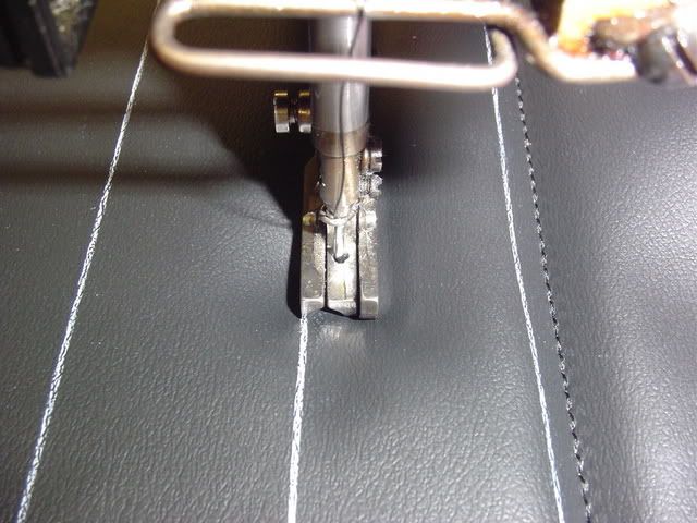

  6. Are you ready to sew? Good, here we go. Start sewing your pleats. Be sure to hang onto your thread ends when you start a stitch so the threads don’t jam in the machine.
    ^ To sew straight pleats, don’t try to line the needle up with your lines. It’s difficult to do and will lead to wiggling pleats. Keep the pleat line you’ve drawn at the edge of your foot. You’ll be able to see the line and keep thing much straighter. Always keep the foot on the same of the line when you sew and all your pleats will be even.

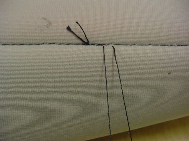

    ^ CHECK YOUR BOBBIN REGULARLY!!! D'OH!! When you run out of bobbin thread in the middle of a stitch you end up with holes that have no thread. Now you’ve got to sew this again and hit all those holes with the needle again so your mistake won’t show. I’ve made this mistake enough that I’ve mastered the technique for fixing it.
    ^ Look at the threads at the back and pull out some stitches so both threads are in the back of the cover. Pull stitches until you have enough slack to tie a knot.
    ^ Tie a square knot (left over right, right over left) so the threads are secured.
    ^ When you’re ready to start sewing the pleat again, give yourself plenty of thread so you can repeat the procedure again. IF you don’t there’s a chance your stitch could unravel later.
    ^ Carefully place the needle into the first hole that doesn’t have a stitch showing. Hold your threads snug and SLOWLY advance the machine so the needle will hit every hole that was left open. After you’ve gotten past the last empty hole you can continue to sew the rest of the pleat.
    ^ Now go back to the long threads where you started to fix the pleat and tie the ends off on the back side, like you did when you ran out of thread.

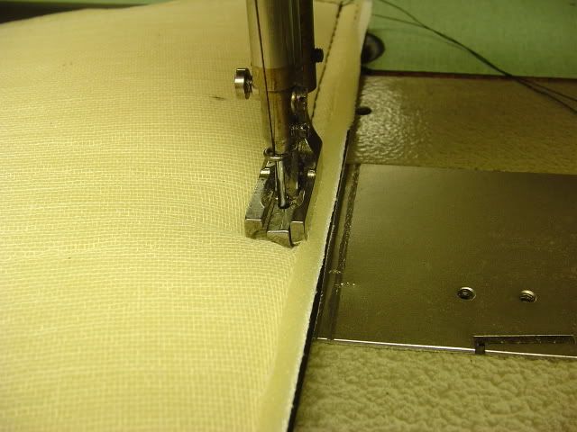

    ^ Tape your pattern down to the pleated panel, making sure your center line is aligned with a pleat. Check both end of the pattern to see that the pleats are symmetrical. If you don’t do this now, you’ll end up with uneven width pleats on the ends of you seat. When you’ve got the pattern where you want it, trace around the edge with your spit pencil. Take the pattern off. DON”T CUT IT YET!
    ^ Sew around the edge where you’ve marked aligning the edge of your foot with your line like you did when you sewed the pleats. You must sew this step so that the pleats don’t unravel after you’ve cut the excess off.

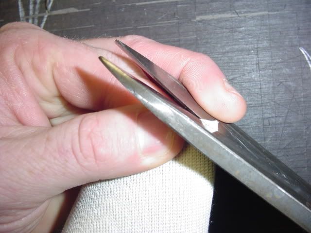

    ^ NOW you can cut the excess off. Keep your cut about 1/8” away from your stitch and keep it even all the way around. This is now the edge of your cover and if it’s crooked you’ll end up with a crooked seam after you sew the skirts on.

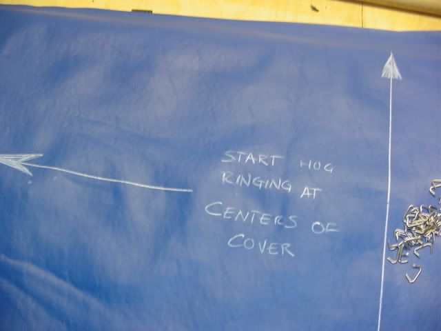

    ^ Starting at the front center of the seat, pull the cover over the frame so it’s snug and hog ring the cover to the frame at the center. Now repeat this at the sides and rear of the frame, making sure the cover isn’t puckering along the skirts.
    ^ Working from the centers, continue to hog ring the cover to the frame.
