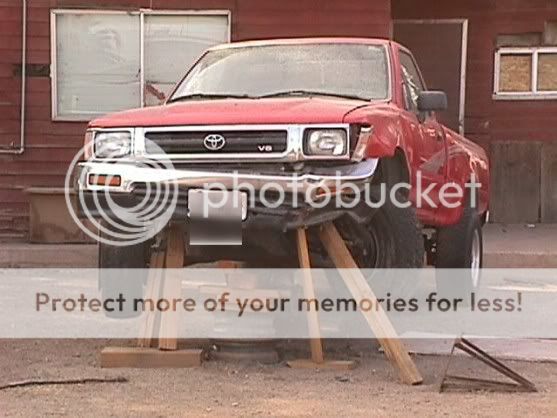

TECH Warning: 3 footed jackstands can kill you
Discussion in 'The Hokey Ass Message Board' started by Bugman, Mar 7, 2006.
  1. Just an add on to Bugmans post.....
    The OEM jacks that come with your late model vehicles, are totally unsafe to even use to change a tire with:mad:......... -so it sure to hell aint any good to work on your car lifted up by one of those!

    3.
    This one is more recently.
    Brand new garbage Chinese Jackstand.
    Gave way after I put the weight of a Car on it.
    That really surprised me, untill I looked a little closer.
    The castingflash wont let the lock fully engage...( see pic )
    Thats enough scary moments for me...

    PLEASE DONT EVER TRY TO SAVE MONEY BUYING CHEAP ***, ASIAN SLAVE LABOR CAMP MADE JACKS OR JACKSTANDS!!!!! Why......
    In addition to the example pic in this thread, I recently had a cheapo floor jack pop apart while I was taking a last jackstand from under the car. Once the axle and wheels popped out, it immediately tipped over causing my 2+ ton ride to slam to the ground, resting on the sideways jack. I was luckily kneeling right next to the car, and it really scared the hell out of me. If I was under it, i'd of been crushed.
