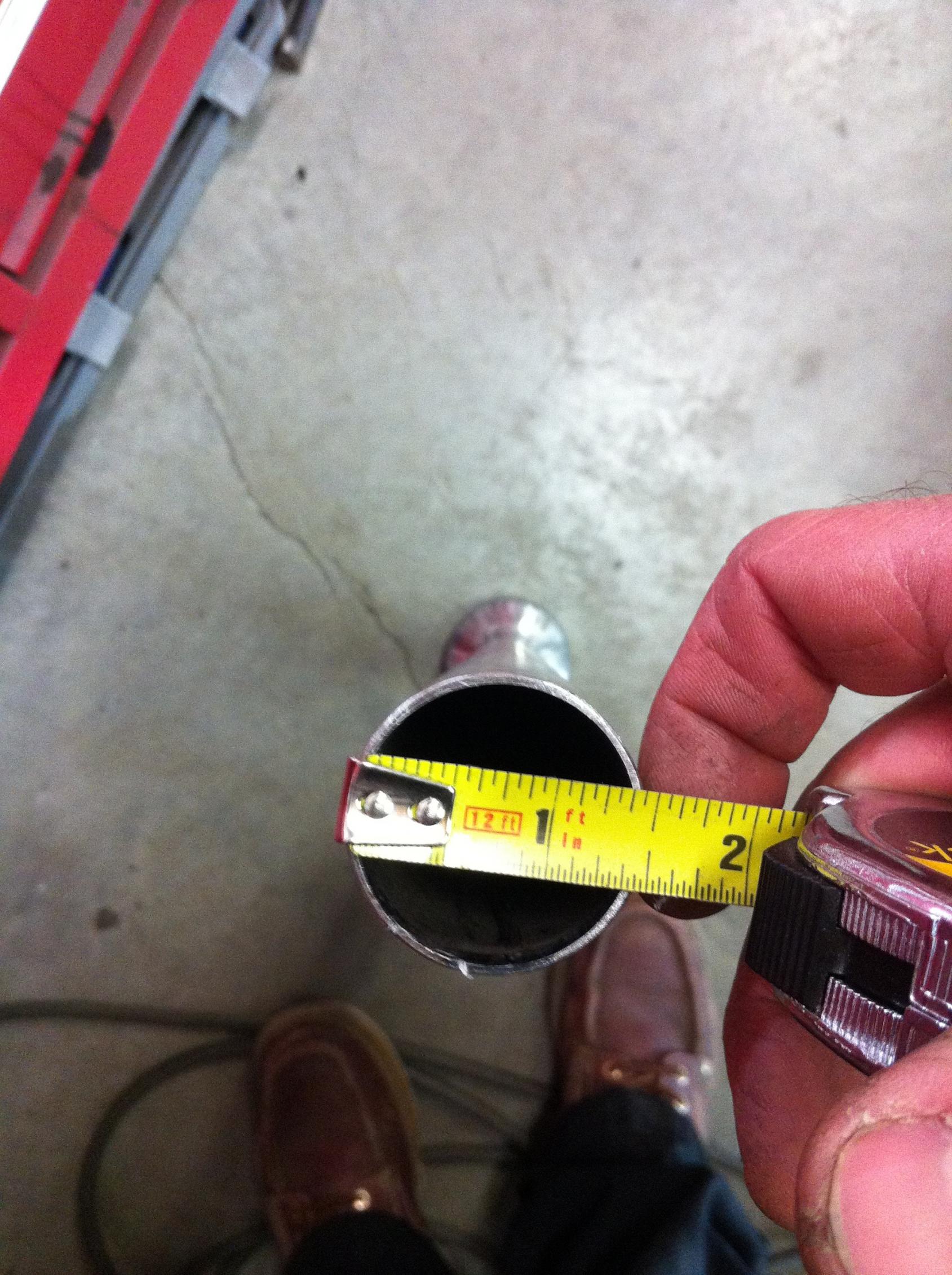

    Very nice...but how did you get a 1-3/8" bearing into a 1-1/4" tube?

    The piece on the right is just to show there are options as far as cups go. I went with the round one for this one, fits better for a futuristic look!

    He used the one on the left...not the right.

    Fits like glove without ANY tapping! just a push with the thumb!

    Are you sure that's a 1-1/4" tube? That's a whole 1/8" difference.

  20. He must have taken a pic of the wrong label. That one is for square tube 1 1/4" x 1 1/4"
    Nice work Ian! (I mean on the column not the wrong picture:D)

    Sorry guys.... Hopefully this human error won't make my tech obsolete! :(
