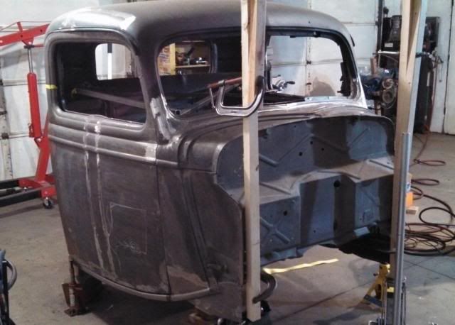

    So here we have my 37 Ford pickup project. The goal is to create a one of a kind full-fendered custom with a factory look. Part of that plan includes stretching the cab 4". Here's the story so far:
    Of the 3 cabs I had, the 35 was by far the nicest. Besides, I like the way the cowl transitions into the windshield on the 35 and the curved rear edge of the hood.
    My fearless assistant is up for the task:
    First task is to install the hidden hinges and align the doors before cutting up the cab. Anybody who's done this before knows it is a tedious and time consuming job.
    I found the peak of the crown on the door split it down the middle there and added in a 4" slice from the center of a donor door. The jog at the bottom is necessary to avoid a step in the bottom edge profile.
    This is the other door after welding:
    Together with the stretch, I wanted a mild chop. I like the look of a 3" chop on a full-fendered truck. With the 4" stretch, a 1" chop gives me the same length to height ratio of the window. With the door frame tacked together, the top edge looks a little flat. More about that later.

    Next up is to slice and dice. I found the high point of the crown on top and cut 2" forward of that. On my donor roof (from the 37 cab), I cut 2" back. That would provide a single seam down the middle.
    I've never been a fan of mail-slot windows, so I decided to leave it uncut:
    The cab has a taper front to rear, so lengthening the cab changes the taper angle. That has to be corrected in the roof and the rocker panels, and the doors actually close further:
    Not a bad start:

    Next up was surgery as required to make the cowl of the 35 cab match the V in the 37 roof for a very unique split window:
    I merged the 35 and 37 cowl vents together:
    The dash will get reworked when I mold in the 50 Dodge instrument cluster
    Remember that that flat door top edge? I decided to cut the windshield posts and extra 1/4" to tip the front of the roof down. That resulted in a nice gentle curvature:
    This is how it looks today:

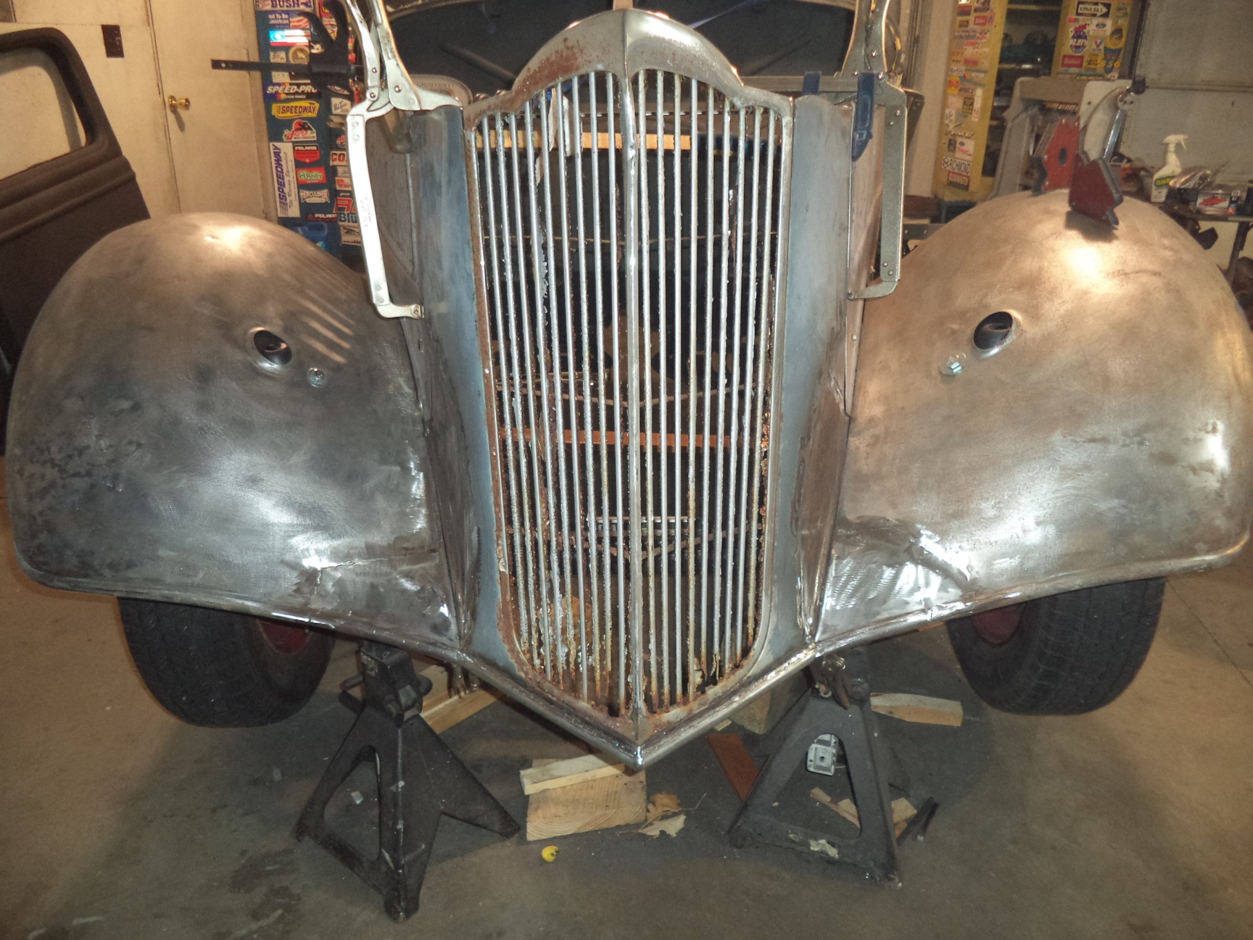

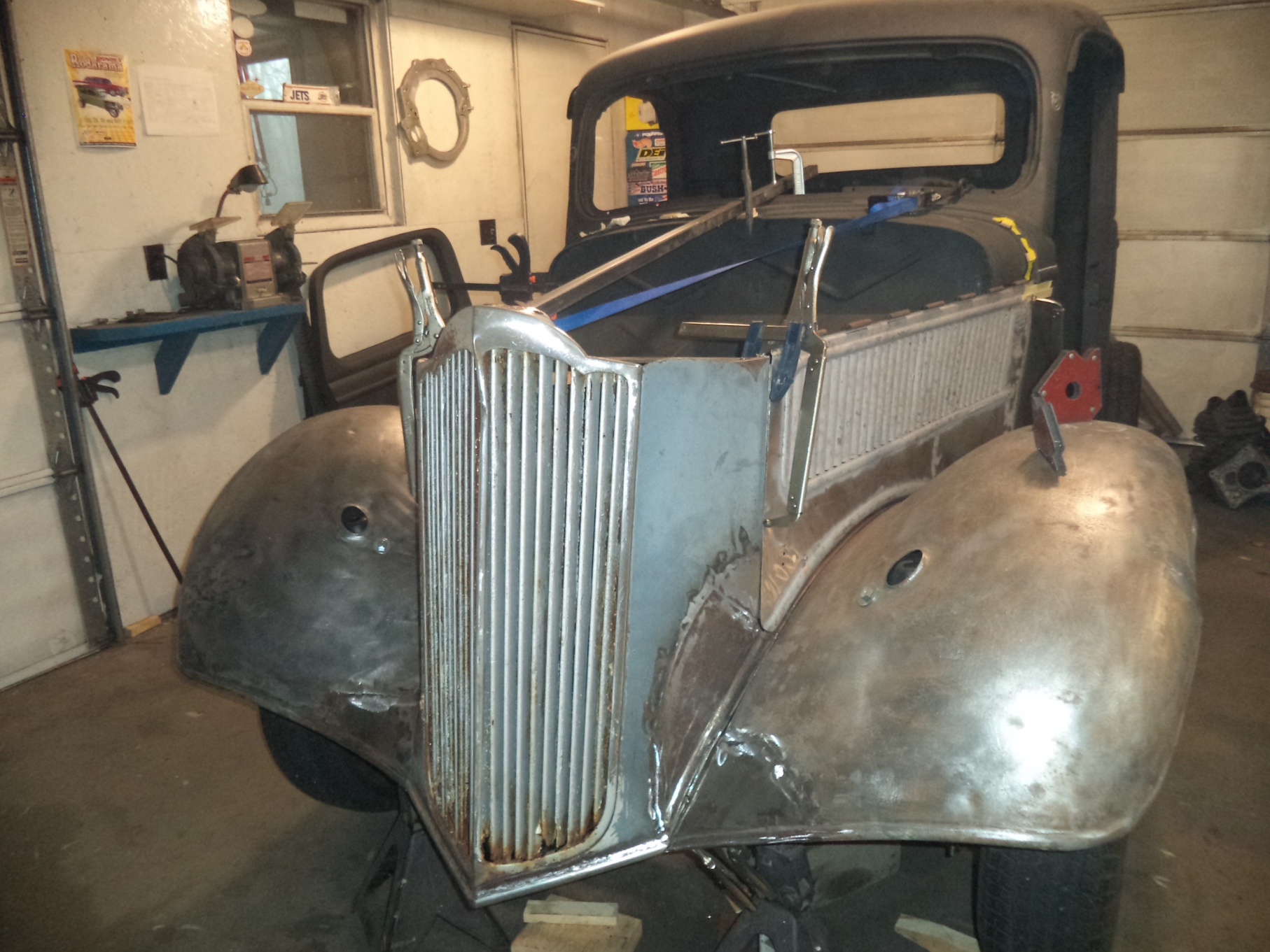

    Winter again in Minnesota,so back to the project.
    I wasn't able to find a decent 37 grille, but I did have a 40 Packard out in the yard......
