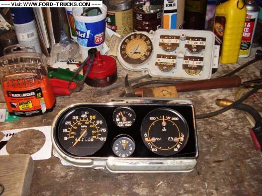

    Great thread!! Great tech!
    I did something similar on my 49 F1 truck. My long term goal is to adapt a gauge cluster from a 58 Pontiac into my dash. In the mean time I needed some gauges so that I could drive the truck. My original cluster was toast so I took some measurements and headed out to the wrecking yard. Since I'm running a 500ci Caddy and also using a GM fuel tank with sender I limited my search for GM stuff so that the fuel gauge would match the sender.
    I found that a mid 90's GMC van gauges would fit my original cluster housing. I had to pay $9.99 for the cluster. Then I stopped a local plastics store and, for the price of a few cold drinks for the shop guys I was able to find a thin piece of black plastic and another thin piece of clear acrylic.
    I stripped the Ford cluster, cut down the GMC cluster to fit, laid out and used the thin black plastic to cut out a surround for the gauges, cut the clear acrylic to fit the Ford cluster face and put the whole thing together. I've got just shy of $20 into this cluster.
    The only thing is the clock didn't work, so I set it for 12:05 so that it was always on "Beer Time"

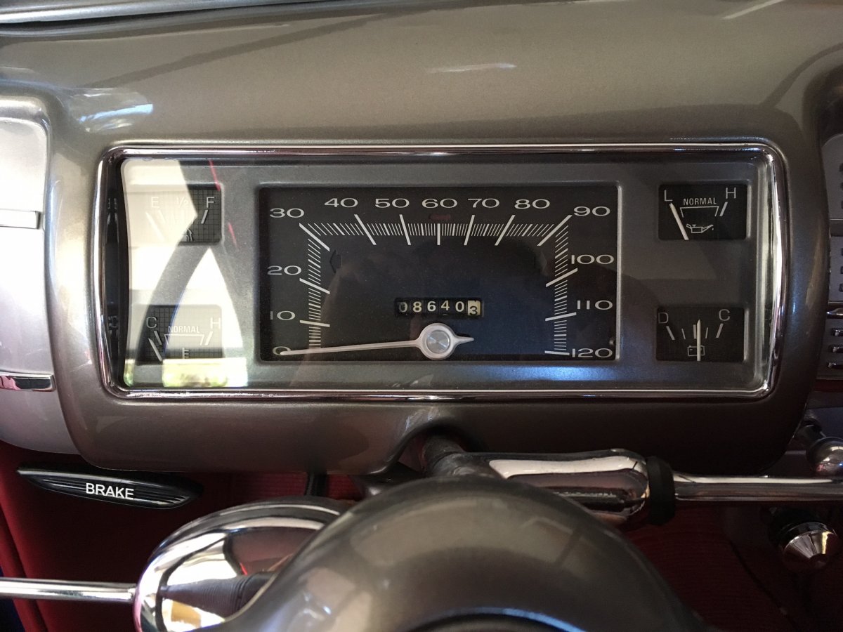

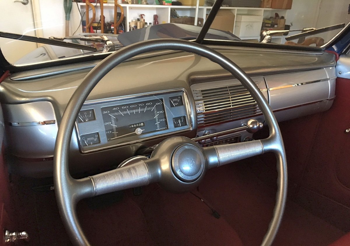

    One of your clusters as finally installed in my (avatar) car:
    ...and the whole dash:
  26. TomT
    Joined: Dec 11, 2003
    Posts: 4,668
    TomT
    Looks great - I have had one nearly complete for my 40 pickup project. Yours really looks good - any pics of it lit up at night?

    The 39 guy
    Looks better than factory Tony! Great looking dash too!

    No. The illumination is kinda uneven; doesn't yet look good.
    Thanks! That really was my objective going in.
