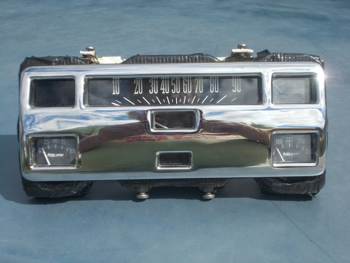

    not trying to hijack this post, but here is the F1 pick up speedo in a '40 cluster.
    I cut off 1" long sections of 2" exhaust pipe, I split it length wise, that lets me spread or squeeze them to pinch the gauges [pic]...used 80* sweep gauges [mock ups shown]. DSCN1296.JPG
    I used silicone to anchor the gl*** to the bezel.
    gauges in with gl*** and bezel.... screws run through the F1 plastic housing. DSCN1316.JPG
    hot rodded deluxe speedo / gauge cluster.
    DSCN1430.JPG cluster mounted in the half '35, half '40 dash, '56 V8 emblem, '40 ford hood script. silicone the ashtray's doors closed...
    ...now, back to your regularly scheduled program...

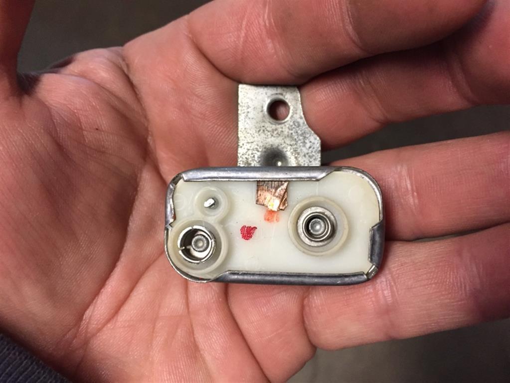

    On the voltage regulator, which connector is 12V in or 5.1V out ?
    Or does is matter?

    As you can see from the photo there will four leads into the regulator. The side with three leads will be feeding 5.1 volts to the oil, water temp and fuel gauges. The side with a single lead will be 12v coming in to powering the cluster. Reg 40.jpg

    the-rodster
    Ah, thanks, I should have noticed that.
