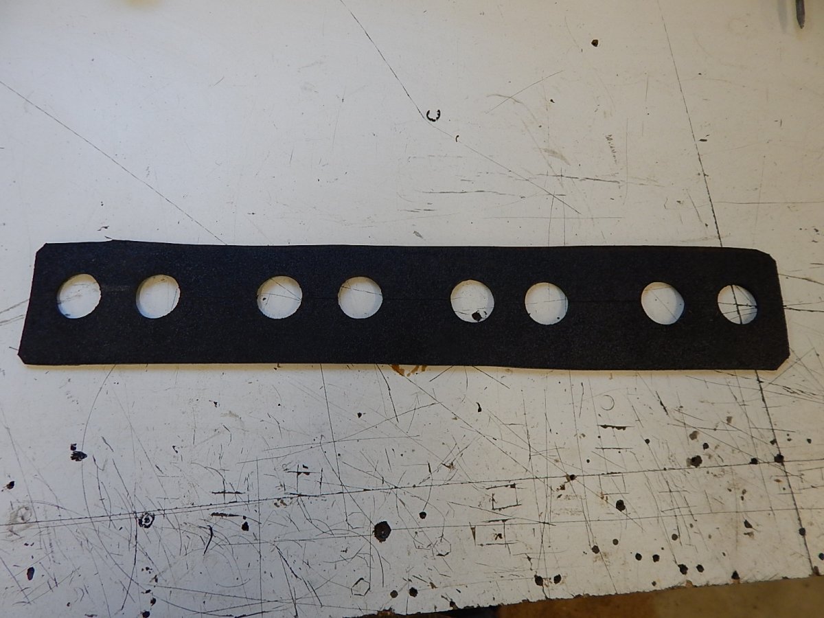

    I came up with this a couple years ago when trying to adjust my valves with the engine running.......holy **** what a mess!
    This setup will let you adjust them without all the mess.
    NOTE: I made this for a Small Block Chevy with stock rocker arms, but the basic idea should work(with some tweaks) with any stud mounted rockers....
    Onward!
    I used a stock 70's Chevy valve cover and cut the center rib out of it with a cutoff wheel and cleaned up the edges. The opening ended up roughly 1 3/4" x 16"
    Next you need a piece of flat, thin material a 1/2" larger on all sides than the opening. you could use aluminum, steel or whatever. I'm using some 1/8" thick ABS i had on hand. Make a centerline lengthwise offset about a 1/2' to one side, then measure and layout the stud spacing on the centerline. Now you need to drill some holes 15/16"where you marked each rocker stud. I use a hole saw for this. It should end up looking like this:
    Put a deep socket on each end rocker nut and slide the piece over to check dry fit. Adjust or trim as necessary. Now you need a bead of silicone around the perimeter of the opening. Set on with the sockets to locate. Tape it in place and let it dry.
    Now we need some thing to keep the oil from splashing out the holes. 8 deep sockets would work great, but I don't have that many. So I found that 3/4" CPVC pipe is exactly the right size to slip over the rocker nuts.....so I cut 7 pieces about 3" long.
    Now you are ready to adjust your valves! Simply swap the socket for the tube on the next valve you want to adjust.
    Thanks for looking!

    I like your idea and thank you for posting the details of fabrication. Would you think it possible to use the steel valve cover with only the stud access holes cut into it and not have to make the added part? The ‘tubes’ would of course still be needed and used as indicated.
    Ray
    Stogy, Deuces, D-Russ and 3 others like this.
  7. RMR&C
    Joined: Dec 26, 2009
    Posts: 5,039
    RMR&C
    from NW Montana
    Yes....with a couple of "if's". If you had a valve cover that was totally blank on top. The stock Chevy ones that I used have a PCV hole/baffle and a filler hole that would need to be removed/welded up.
    Also you would need to accurately locate the rocker studs.
