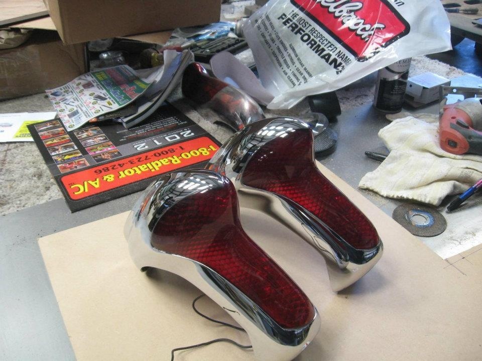

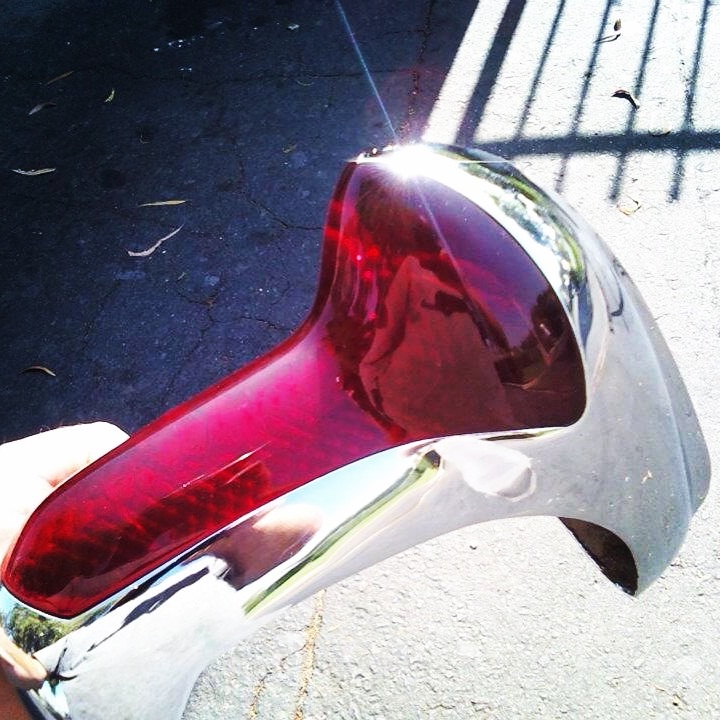

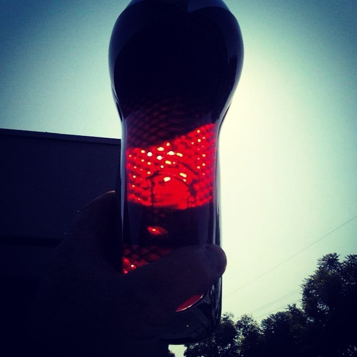

    Matt, The latest pictures you posted the lens have the cl***ic diamond crosshatch pattern, how did you achieve this? You had mentioned in an earlier post you were going to try to get that pattern, really curious how you did it. Thanks for the tech article and your time and effort.
  8. slddnmatt
    Joined: Mar 30, 2006
    Posts: 3,691
    slddnmatt
    Malcolm , you cruise over to Ace hardware or lowes and you buy a kitchen light roof panel, one is a very nice diamond design. Cut to size and set on a cookie sheet. Seal the sides and mix up some silicone mold rubber and pour about a 1/8" coat over the pattern. Then you stretch that over your guard mold and secure it in place.. Then pour you resin. It's all alot of fun. If you look up Palle Johansen on the CustomCarCronicle he built some for his caddy, he got real high tech and machined a mold. They turned out great..
