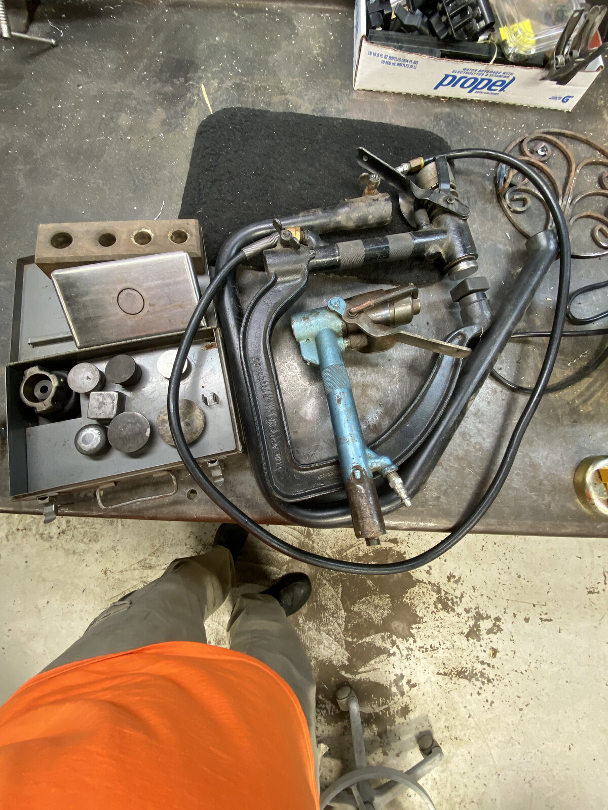

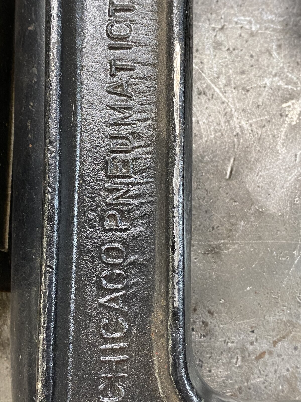

    What brand is that pneumatic planishing hammer?
    It is short and stubby compared to an air hammer.
    Thanks,
    Tom
  5. 1-SHOT
    Joined: Sep 23, 2014
    Posts: 2,903
    1-SHOT
    from Denton
    5DFEFEE0-0CEF-4771-A9B3-F0E22A1CFFA5.jpeg 1C744556-F6CA-453A-B57D-E275D436EBA9.jpeg It looked like a CP they came with 2 different length arms so you could reach deeper, and multiply dollies to match the radiusI still have mine and it works great even after 62 years
