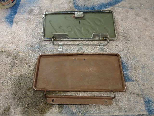

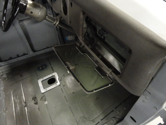

    What did you use for the portion of the hinge that attaches to the dash lip? Thanks

    Rich:
    I fabbed a piece of 3/16" round stock to mimic the original hinge since
    a friend wants the original. I had cut the back out because the door
    was to heavy for the magnetic catch.

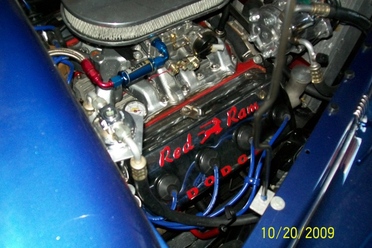

    Dave: Just a pic I pulled from the HAMB. I see them on e-bay once in
    a while.
    Rich

    Thanks; three little hinge pivots, good idea; I was trying to figure out a way to make one wide pivot like the stocker.

    Rich, The two outside pivots are actually spread out to the corners to keep the
    glove box door from moving side to side. I just threw those on for the pic.
    Take care, Rich
