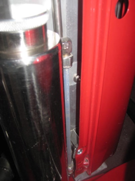

    RADIATOR OVERFLOW LEVEL GAUGE. Some clear plastic 1/4" tubing and 90 deg. fittings.

    from pgh. pa.
    IMG_1030.jpg IMG_1031.jpg IMG_1030.jpg IMG_1031.jpg I'll try
    Level indicator for radiator overflow bottle. two 1/4" fitting and plastic tubing.
