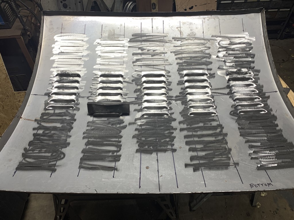

  8. the-rodster
    Joined: Jul 2, 2003
    Posts: 6,960
    the-rodster
    Hammer, hammer, hammer...
    And take a look at the front side to check the progress.
  9. the-rodster
    Joined: Jul 2, 2003
    Posts: 6,960
    the-rodster

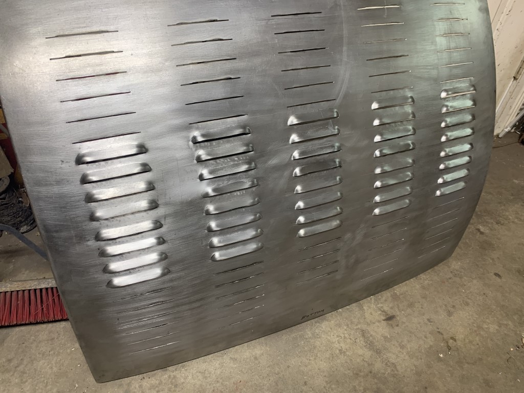

    and check progress.
  10. the-rodster
    Joined: Jul 2, 2003
    Posts: 6,960
    the-rodster
    Yes, it is very time consuming.
    If you have a guy with a louver press and the right die in your area, DO IT.
    But if you're patient, and take your time, you can end up with great results
    After all the hammering, there will be some need of dolly work.
    This is my results with no hammer/dollying, that will come next.
    Good Luck!
