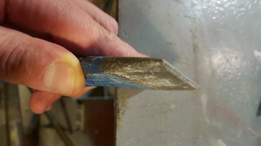

    Like all chisels, this has a beveled edge and I've found that a straight edge works best.
    So, before laying out the shape, I knocked down the bevel. Like I said, this could be done with all different tools. A hand-held grinding wheel would work, for sure.
    I knocked down the edge afterward.

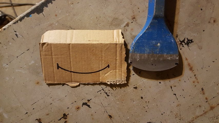

    Again, this can be done a bunch of different ways. I used the cutoff wheel.

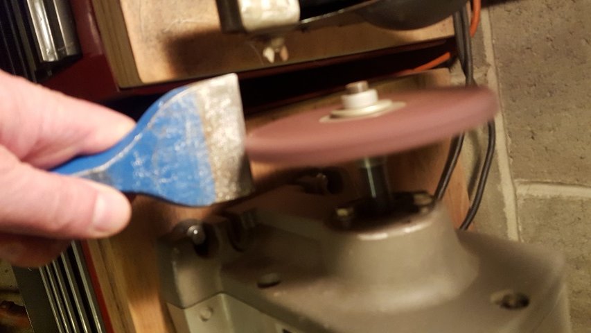

    After cutting off the corners I took the chisel over to the bench grinder and shaped it.
    I traced it a couple times and would put a straight edge across the ends to see if it was a fairly equal shape. Once I got to a shape that was acceptable, I cleaned it up, i.e., I removed any sharp edges and made it smooth.

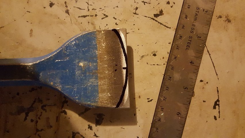

    Oh, I don't want to step over this. I put a mark on the center of the punch. and hit it with ths grinder so there's an indentation. A marker or paint park will just wear away. It's on both sides. BUT, I try to pay attention and keep the punch facing the same way, always. so the louvers come out as similar as possible.
    There's a lot of room for errors in hand-punching these. Unlike the consistency of a machine that pops the same louver time after time. You can mess these up, easily if you aren't attentive.
    Now is a good time to say that the size of the louver is NOT 2-3/4" like the chisel. After shaping it, the punch is 2-5/8". I laid out the louvers accordingly.
    Obviously this is a dirty old piece of s****, which is good for practice or demonstration. It does have some drawbacks. Size is one. The amount of real estate around the sides of the s**** allow for the metal to deform much easier than a bigger piece. I practiced on a s**** Chevy hood and it was easier to focus on actually punching the louvers.

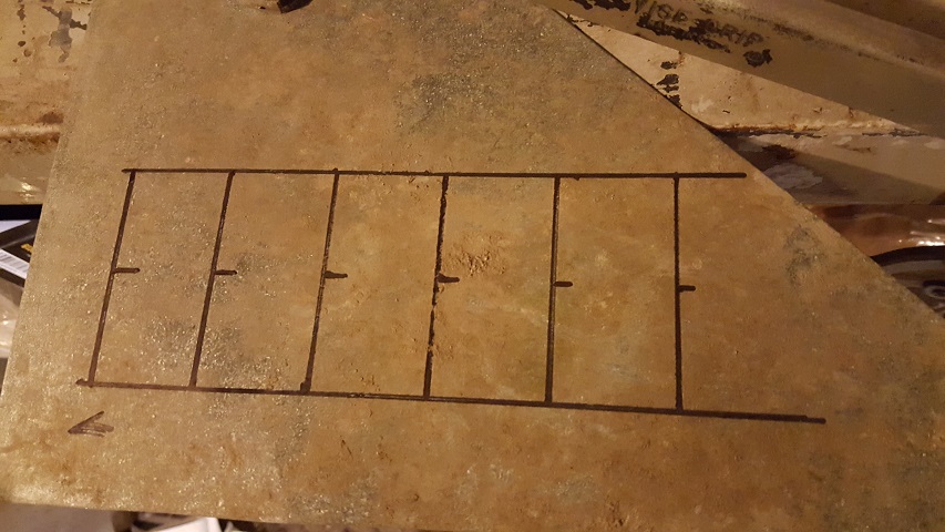

    Since I've been practicing I've learned a few things. You can drill holes at each side. I didn't here but if you're nervous about the cuts, I recommend it. Also, thin cutting wheels work best, for me. It looks the cleanest and clean-up is less. If you do use a drill, match it to the size of the cutoff wheel. Seeing the remnants of drilled holes looks shoddy.

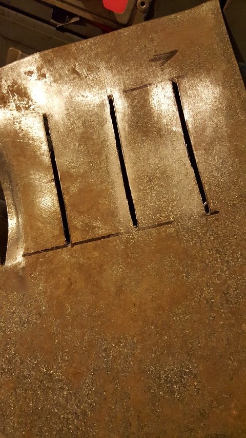

    The above cuts are even thicker than I usually use, now. Admittedly, I didn't want to fire up my compressor and use a different set-up. The kids were sleeping.
    The ends of these cuts should get hit with a file or a hacksaw blade if you don't have a narrow file.
    I'm holding the punch and trying to get a decent pic. Before hitting the punch I did square it up better.
    You can tell how junky the left louvers are. We'll talk about those more in a bit.

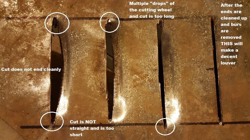

    Cleaner, straighter cuts. you can see the end of the cuts, where there is material still left on the opposing side of the workpiece. Take a slim file or a hack saw blade and clean this up. It will result in a better louver.
    Okay, now for some horrific looking louvers. This just shows you how skilled a guy like Andy is and how not being focused can result in hack work. I'm telling you now so there's NO EXCUSE. There are all sorts of problems here.
    I have mentioned the cutting issues (on the three left) but there's also hammering issues. You need to hammer straight. It's not the end of the world if you don't but you will have some extra work to do. The three louvers on the right show different issues. One is hammered off-center, the center one is pretty clean and the furthest right, I didn't hammer fully. All things that can be adjusted/fixed. The louvers to the left, they would draw someones eyes right away even if they were surrounded by a hundred perfectly hammered louvers.
    See what I mean? Bottom three have issues. The top haven't been worked on, yet.
