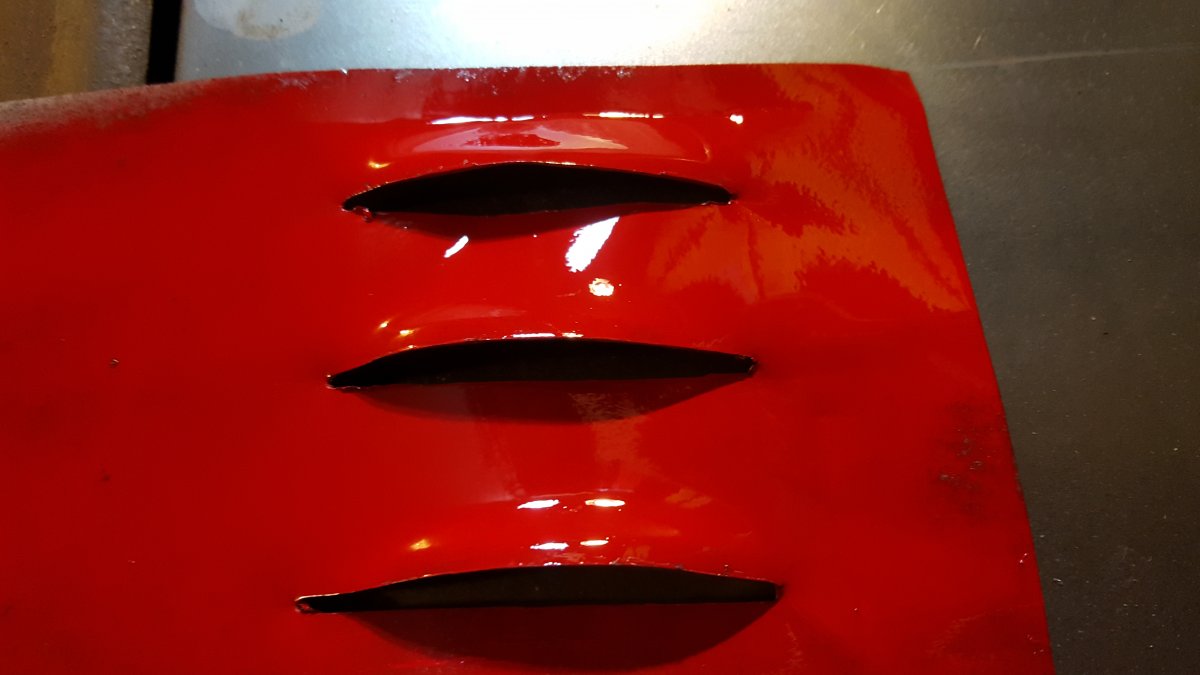

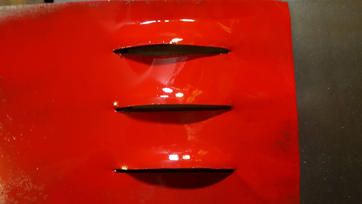

    Hey Brent here is my first attempt at hand punched louvers I will make some changes as I go to my process I need to use a smaller drill bit for the ends and work on straight cuts/ layout but this is awesome I am really looking forward to using this on my build! Thank you for the tech Jim
