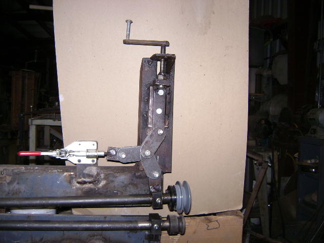

    Excellent info. I need to build doors for 2 roadsters I found off in the brush. I have had My modified Harbor freight bead rollers for about 8 years, It started jerking instead of rolling smoothly. I pulled it apart aand the shafts were gauled, I polished them and Drilled and tapped and added grease zerks to the bearing blocks.. the first thing you should do to a chepo bead roller. I also added a quick release to mine The links were from the wrought iron aisle at my steel supplier, 49 cents each. for an easy tipping die I bought a pully for an elect motor with 22 mm bore from Burdens surplus supply. the pict is before grinding it. to the shape I needed

    I like the quick release , that would be awesome doing art work and running beads.
