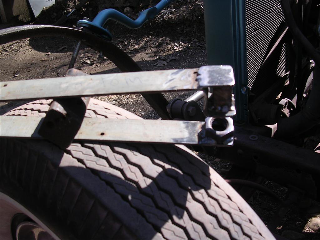

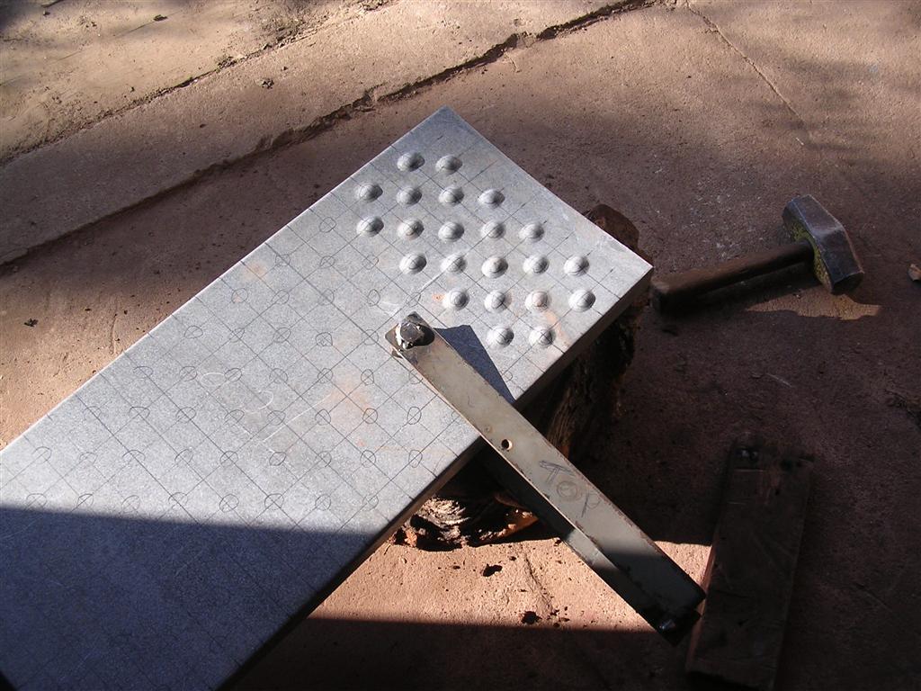

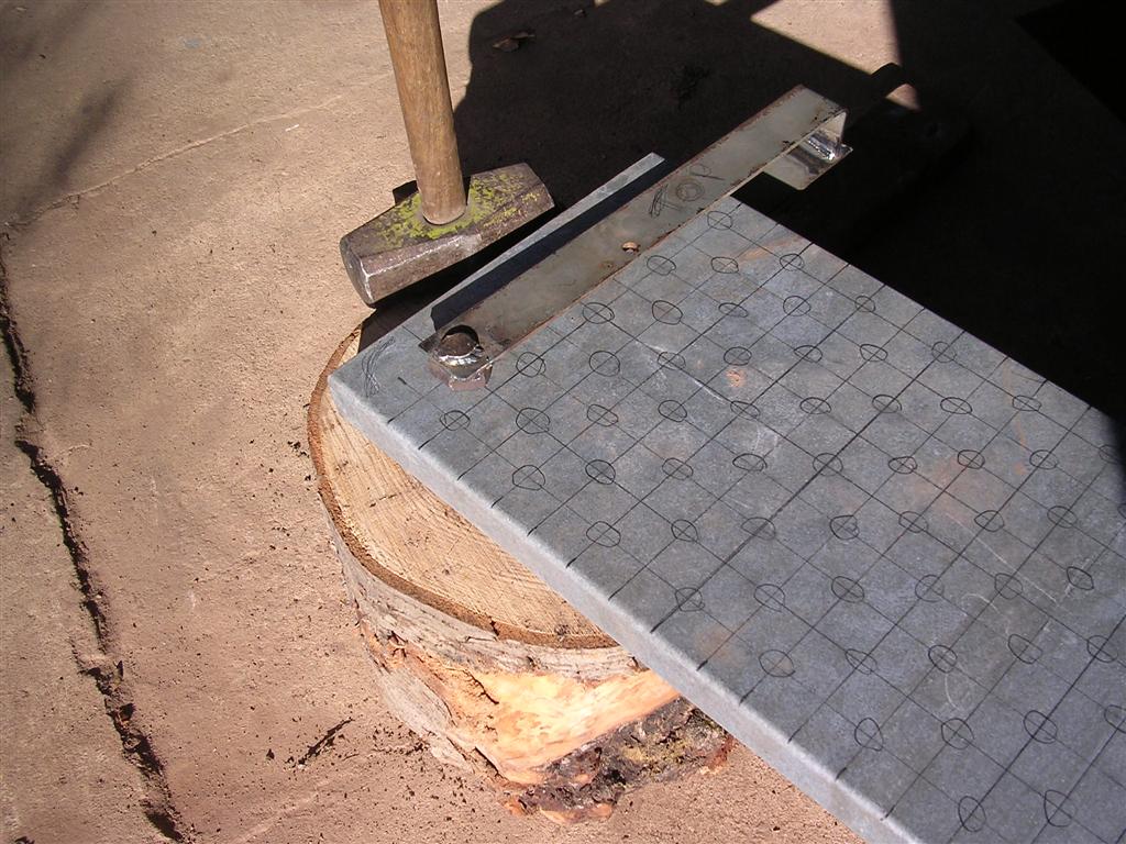

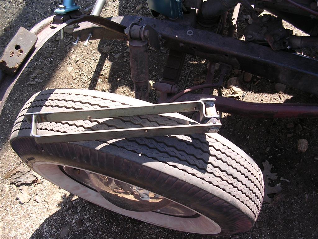

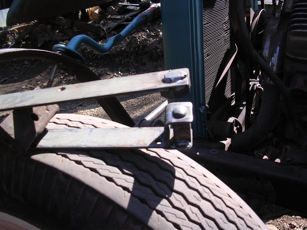

    No, I actually hate making tools that are good for only one job, then become forgotten on a shelf, but I finally realize that by slaving to make a tool, you can now make the part in just minutes.
    Here is a tool I just made for putting odd oval bumps on some 1921 Republic truck running boards I had to make.
    There are 97 bumps per board..so making a tool that can be aligned very quickly, paid off in labor saved.
    The male die is an old big dome head carriage bolt that I ground to an oval shape.
    The female die only needs to be an "outline" of the oval shape. I could have used a short piece of flattened pipe, but did not have the right size, so I found a big flat nut that I smashed two sides inwards to make an oval.
    Now find a way to align the 2 dies before hitting with a big hammer; I made a tool, looking like tongs, from old flat steel. There is no hinge, it is welded, and that ends up with some spring tension to keep the dies together and aligned to each other perfectly.
    (first 2 pics I have a block of wood spreading the tongs, so you can see the die shapes)
    I made grid lines on the running boards with a pencil, and aligned the two points of the nut on one grid line, and a saw mark at the front of the nut, to align the die to the 90 degree grid line. Once you get the hang of it, it goes quickly to be able to align the dies then hit with the hammer.
