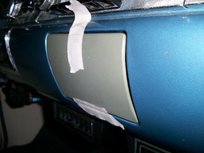

    got some more pics today,, heres why you dont use the stocker as a pattern.
    its not exactly square!
    mines not perfect but I think it will do.

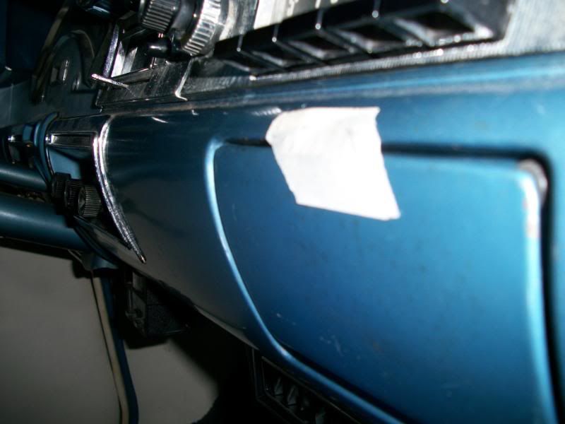

    now for the contour, I tried for a while to get a decent pic but camera is dumber than I am and wouldnt focus .
    anyway, it doesnt show well but the upper portion is off by 3/16".
    this ones dead on. the gap on the right side isnt there when its bolted to the hinges, the tape slipped a bit, or at least thats my story.
