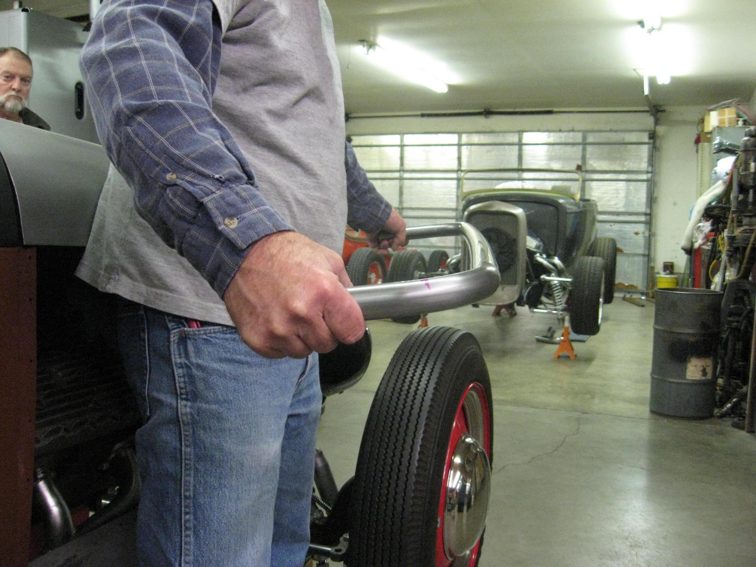

    Building a rear bumper for a friend's Model A roadster.

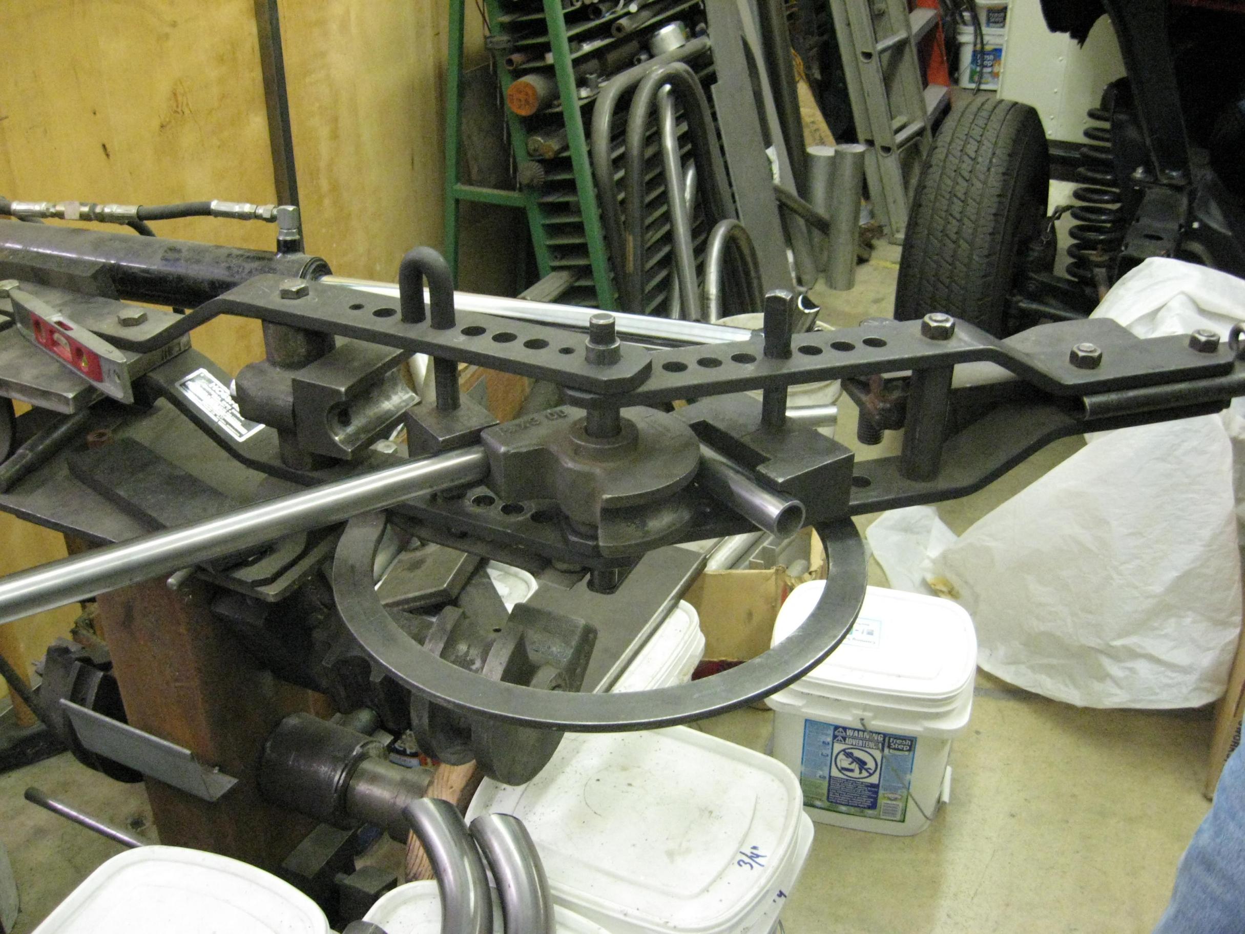

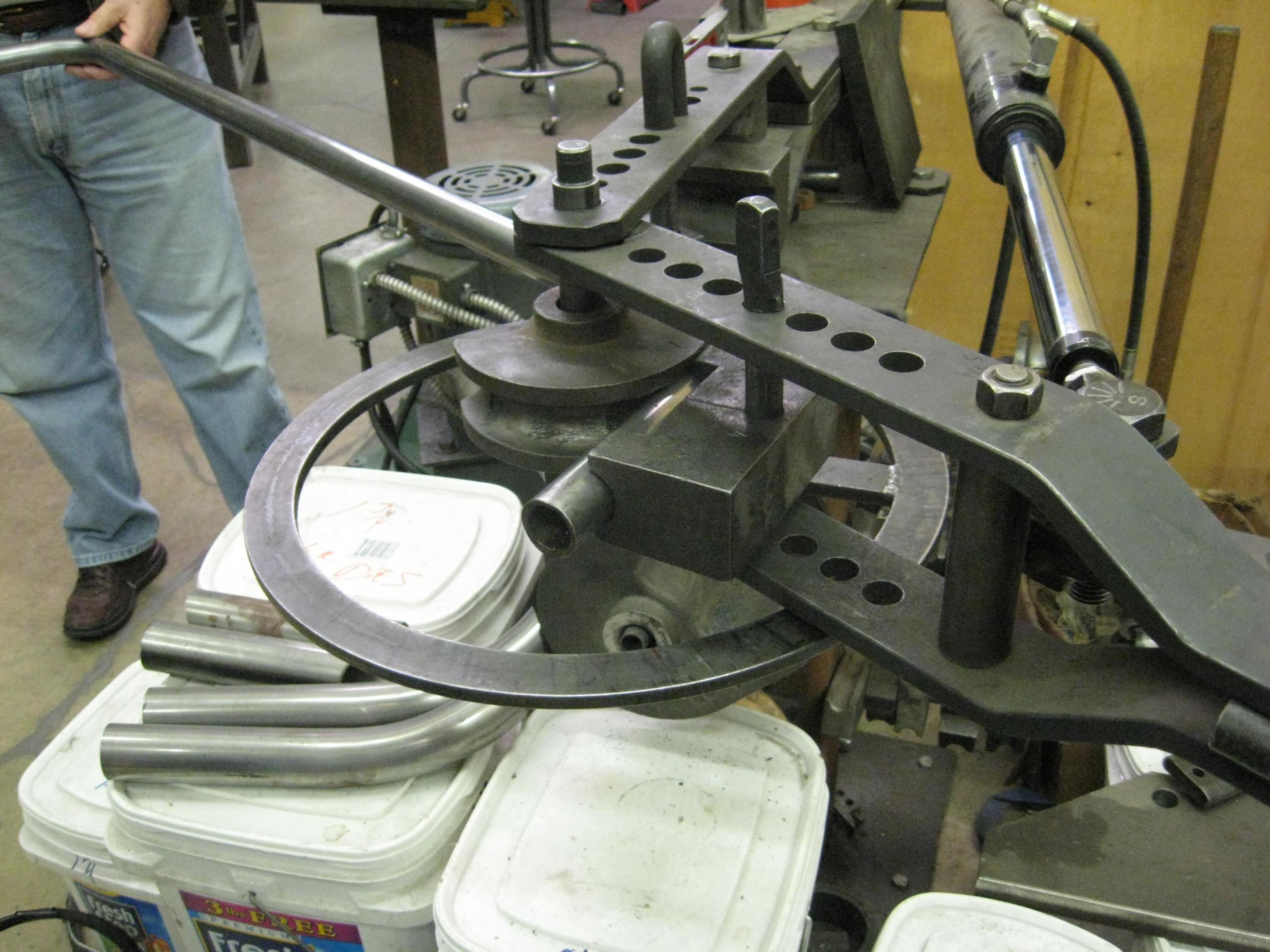

    - Started with 1 1/4" .120 wall steel tubing. Bent both ends 90 degrees in a hossfeld #2 bender.
    - Used a HF tubing roller to fit to the contour of the rear panel.

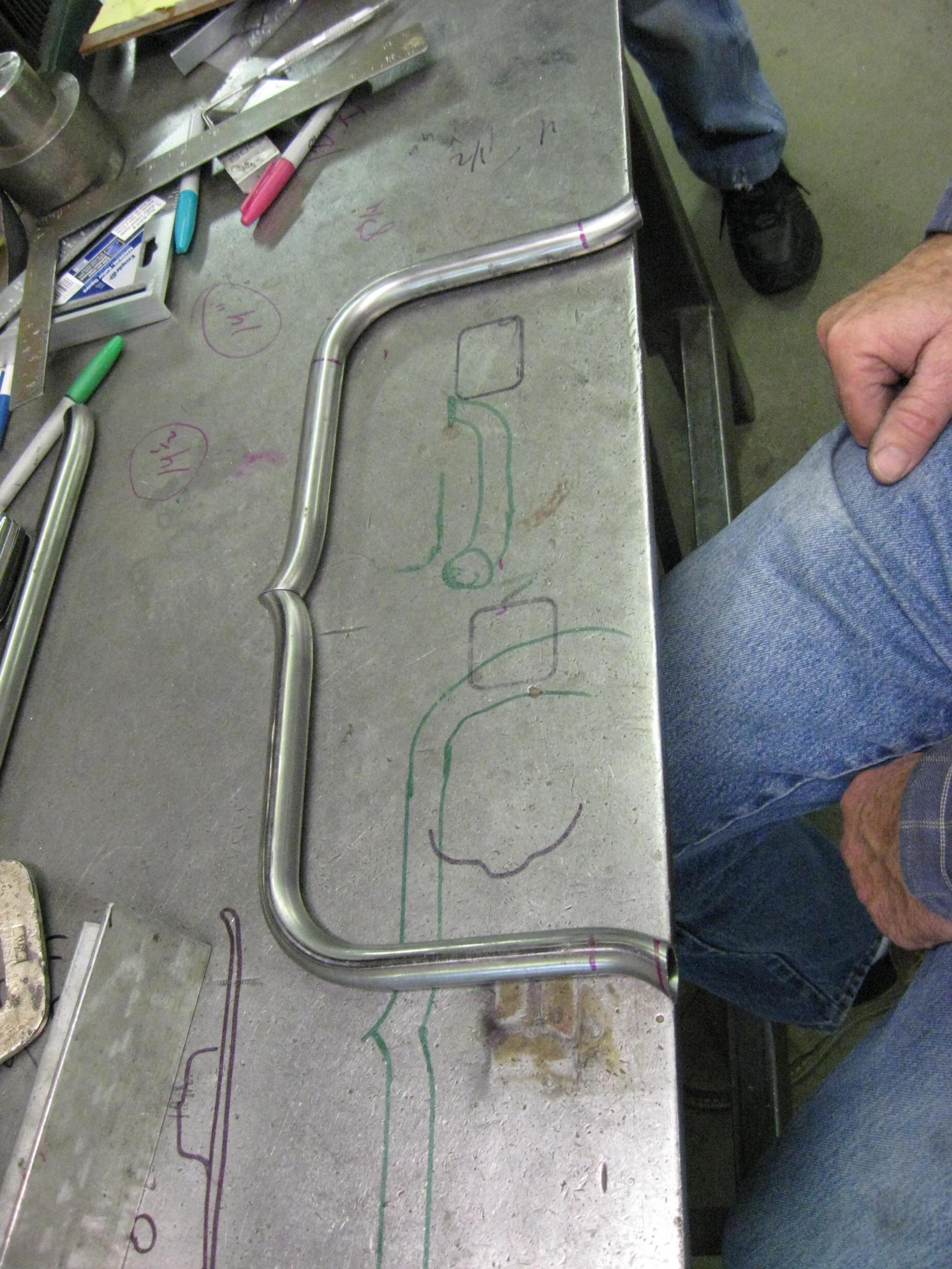

    Marty Strode

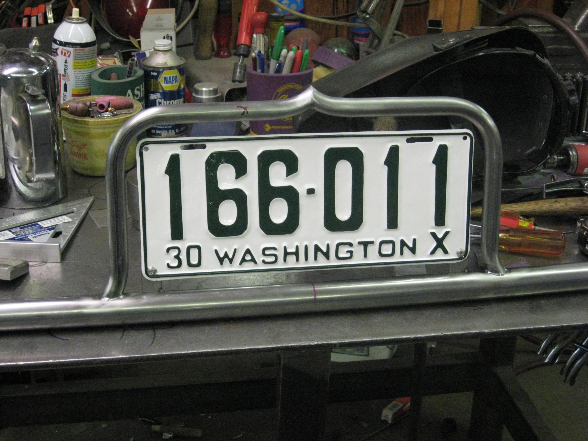

    Now I'm building a license plate surround.
    -Layed out and bent 2 pieces of 3/4" .065 wall tubing, 3 bends on each.
  3. Marty Strode
    Joined: Apr 28, 2011
    Posts: 9,850
    Marty Strode

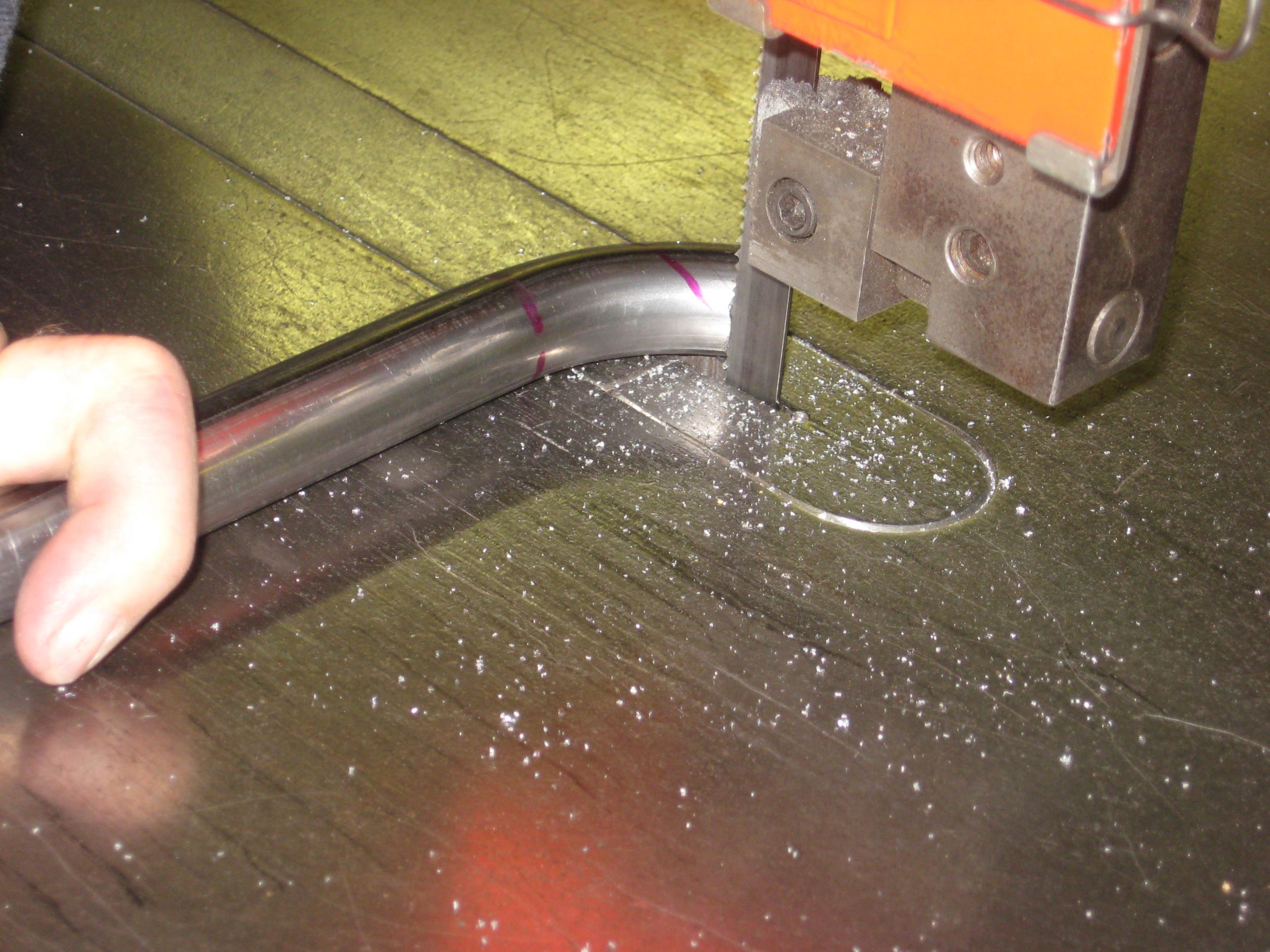

    Now I trimmed, coped, and welded the 3/4" tubes to shape the license plate surround.

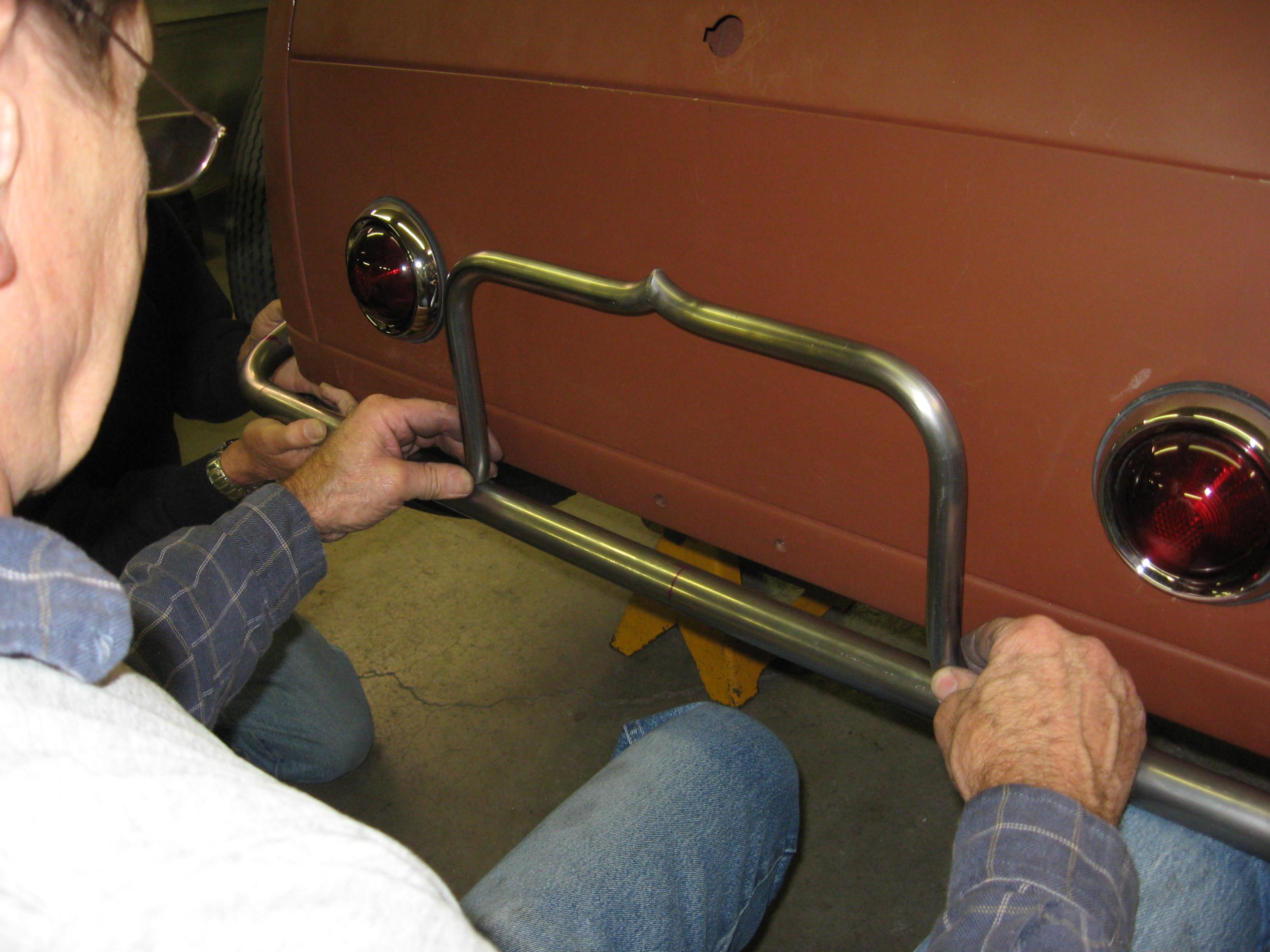

  5. Marty Strode
    Posts: 9,850
    Marty Strode

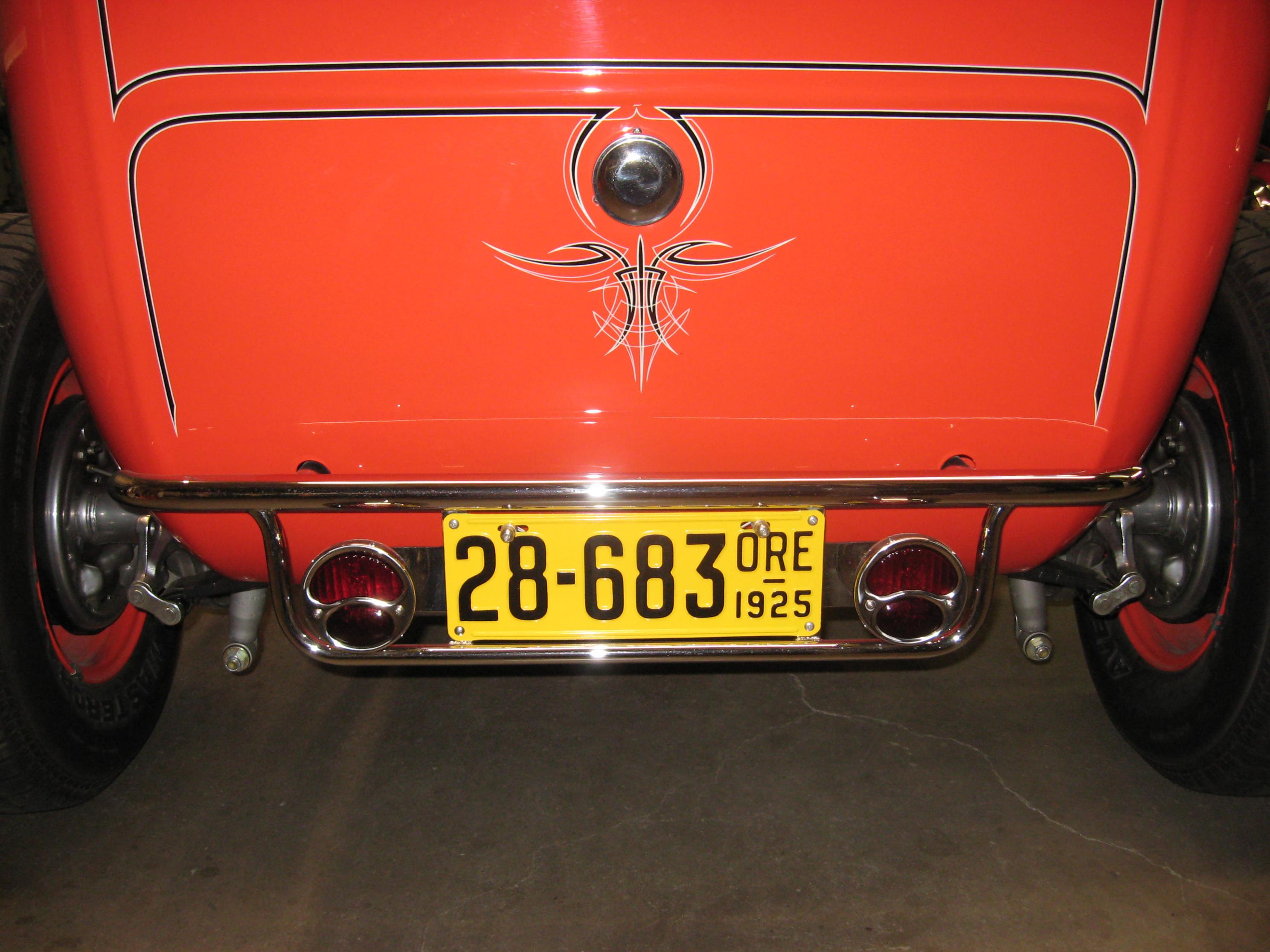

    I mounted the license plate surround to the 1 1/4" bumper tubing.
    - Mounted it to the car with 1" .120 wall tubes, bent to attach to rear cross member. Trimmed and capped the ends.
    This is the finished product. I am developing profiles to fit other early Ford body styles. They will be available in kit or complete form.

    dirtbag13
    looks great !curious what you did to the ends of the inch and a quarter to cap it ? just curious we did something similar and i turned half spheres w the ends stepped down to press into the tubing , hard to tell from your pics if you just used flat plate to cap them or left them open ?
  8. Marty Strode
    Posts: 9,850
    Marty Strode
    I have a Di-Acro turret punch with a 1 1/4" die, it leaves a nice dimple in the center. Works great.
