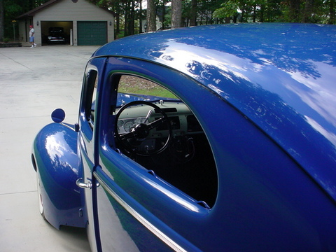

    This is a series of photo's of how everything looks after the car was painted.
    I will report in that Steve's 40 sedan has weathered the rain very well.
    It is a thousand times better at keeping the rain out better than no gutter or rail at all,remember the original gutters were shaved off for some unknown reason before Steve acquired the sedan.
    This was the easiest way of making a repair and 99% of the people that have seen the car never noticed the difference until pointed out.
    I'm sure there are other ways to accomplish this but this is just a simple way of making the repair. HRP
