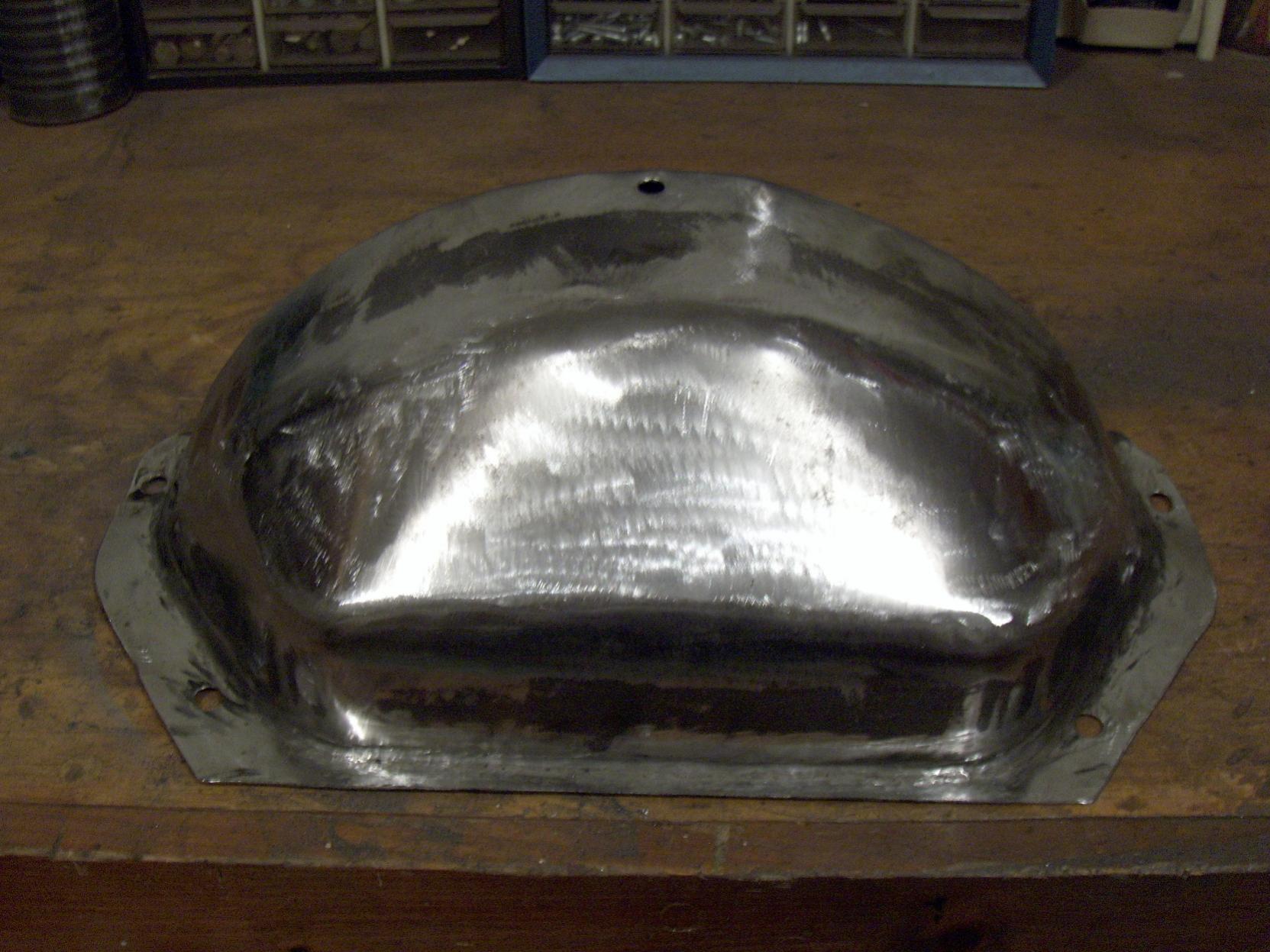

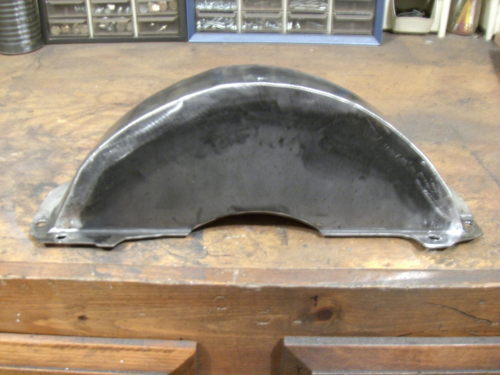

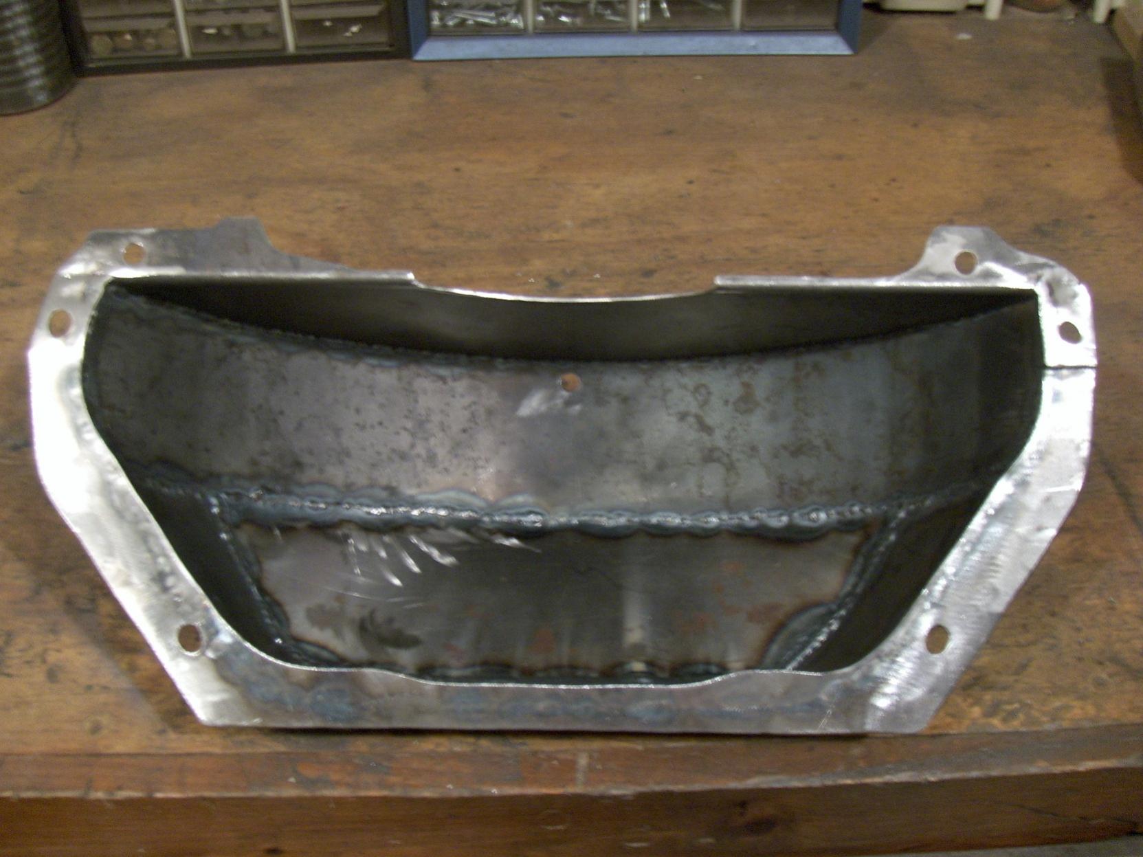

    Well here goes, my chance to be technical.
    T5 behind a Nailhead in a Model A
    I'm using a Bendtsen's bellhouse kit for this install. The kit does not provide a lower bellhousing cover. I could not find a OE or aftermarket cover. To solve this delma I made one.
    The trans is a Mustang T5 with an S10 tailshaft housing. The speedo location on the Mustang tailshaft does not match the location of the S10 (2 inches difference). I used a Dremel, a drill and a No. 10 AC crimp collar to relocated the gear. The dia. of the shaft where the gear is originally loacted is 1.110 inches the machined downed area where the gear needs to be relocated is 1.050 inches. A .030 wall thickness collar is needed. The AC crimp collar has a suitable ID and the wall thickness is .031. I used the Dremel to grind through the hardened shaft (about 1/16 inch) and then drilled a hole for the factory lock clip to secure the gear.
    Attached pictures show the bellhousing cover and the reloacted speedo gear.

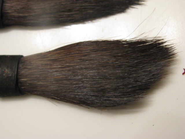

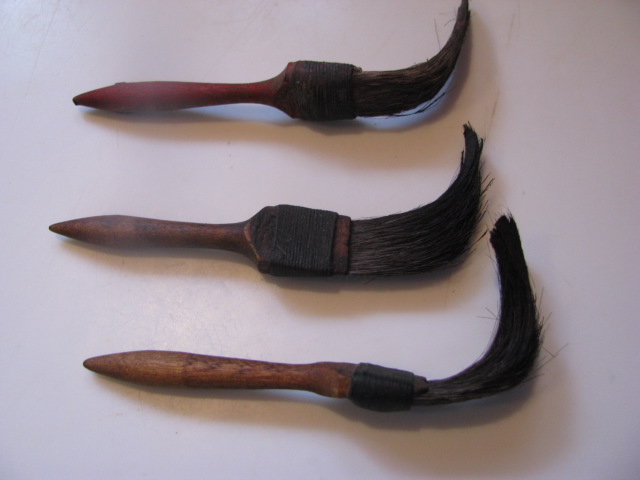

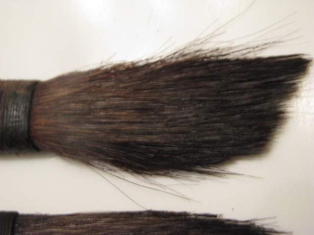

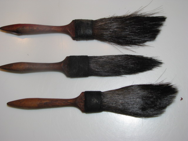

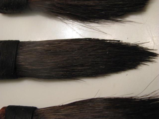

  26. This post will describe in detail how to take a pinstriping brush that has been maltreated by allowing it to sit bent over for an unspecified amount of time and return it to usefulness once more.

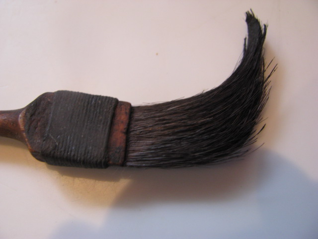

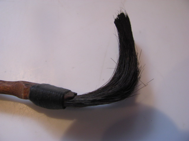

    To begin:I acquired these 3 brushes from a friend of mine who operates an antique shop nearby and is always on the lookout for stuff I collect.
    The first few pictures show how badly bent and distorted they are.I thought at first one of them was beyond repair but figured to give it a go anyway.

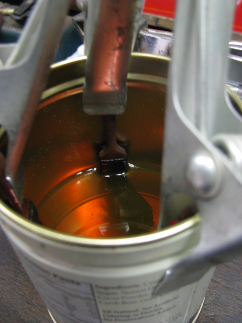

    I began by selecting a can I had laying around the shop that was a bit longer than the brushes themselves.Taking some clamps used to hold fabrics I clamped the brushes to the side of the can and filled the can with lacquer thinner just up to where the brush hairs meet the wrapping.I didn't want to submerge the wrap as I thought the lacquer thinner might soften it an cause the hair to fall out.

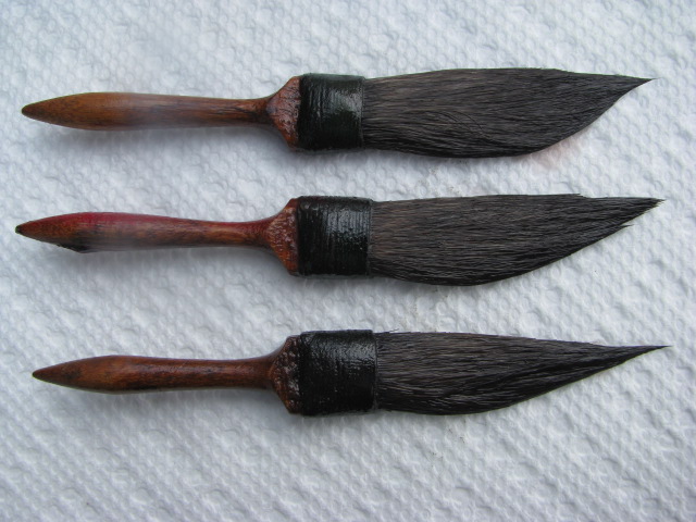

    I would periodically check the brushes to see how they were coming.After a couple days of soaking,I pulled them out and using a cleaning brush(similar to a toothbrush)with nylon bristles, very carefully started cleaning the brush hair working from the heel of the brush to the tip on both sides.If there seemed to be more residue,I put them back in to soak a little longer.
    After I was satisfied that they were as clean as possible I washed them out with warm water and liquid dish soap and dried them.I then worked more liquid dish soap into the hair and shaped them as they are supposed to be and let it dry. Then I set them aside for a couple days.
    I then cleaned out the dish soap by rinsing them in warm water and drying thoroughly.I took them out to the shop and liberally applied some oil(a mix of neatsfoot and Marvel Mystery oil)and stored them vertically(hair up)to allow the oil to "wick" into the hair under the wrap.This helps if paint gets in there;the oil will keep the paint from drying and ruining the brush.

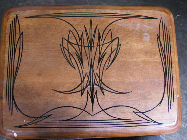

    After a day of soaking I selected one of the brushes(actually the one I thought couldn't be saved)and cleaning it with mineral spirits and loading it up with some black 1-Shot started pulling some lines.
    The results;while not perfect show that with some getting used to this will once again be a serviceable brush.
    I hope that others who have similarly damaged brushes will try this method.It will definitely save you the price of replacing a brush.
  27. Here are the pictures of the test piece I striped.Not the greatest but with a little practice with this brush I should improve.
