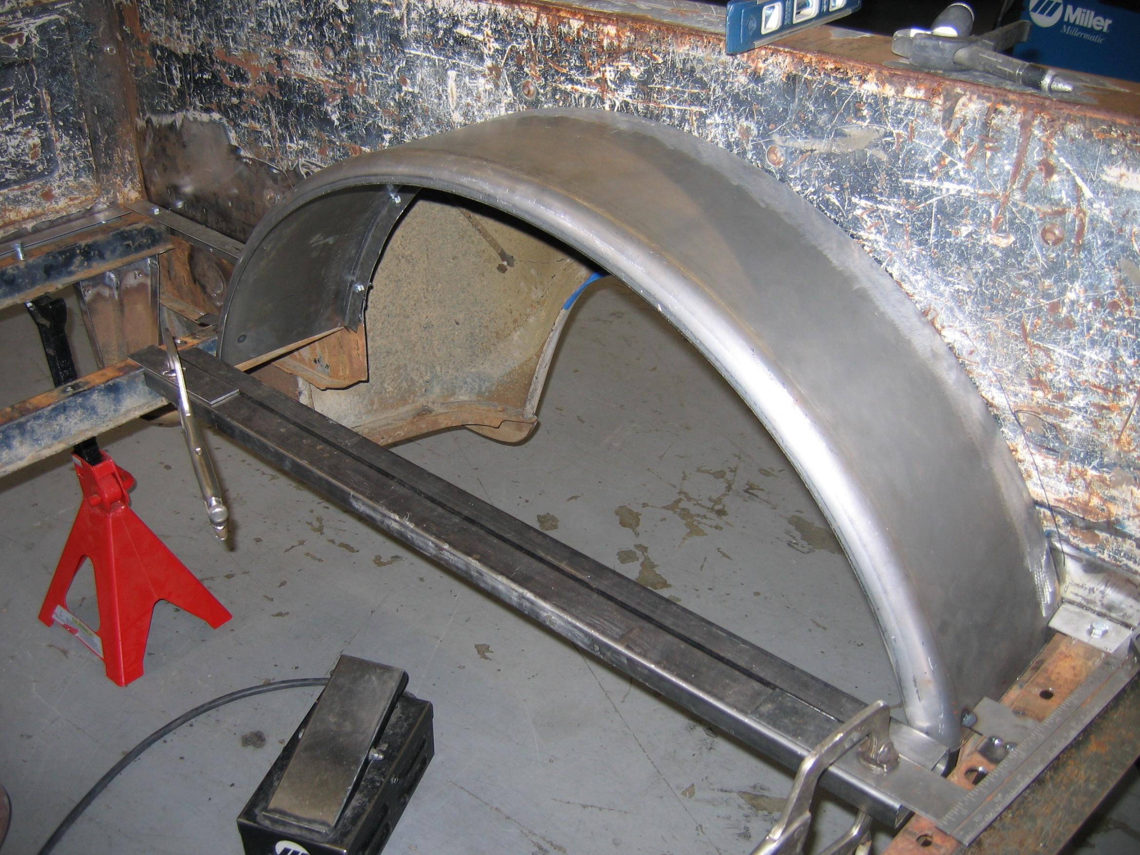

    Well here is my Tech Week Submition. Need nice rolled edge wheel tubs or inner fenders for your hot rod? Here is a great looking and cheap solution with no real special tools or skills needed. In this example I needed wheel tubs for an O/T build 55 truck. Bought 2 trailer fenders 16 gauge steel for 17 bucks a piece. In this case the fenders I ordered had a nice rolled outer edge and a flanged inner that I drill for mounting. I took a 2 inch section out to get the width I wanted. I've used a cut off wheel, a jig saw or a plasma. Welded back together flush, You can also overlap and spot weld from the inside. Then I trimmed the fender to length and drilled and bolted the fender to the bed side. Then took a piece of 16 gauge and put a 1 inch flange using a brake, and held it up to the mounted fender. Scribe the inside, cut and check fit. Weld a section at a time to keep from warping, grind and done! I've used this method many times to make wheel tubs, inner fenders, even small fenders to make trans humps. Works great, looks great and is cheap. You can buy double rolled edge fenders and split down the middle for narrow tubs or wheel wells. Motorcycle fenders work well too but are usually more expensive than trailer fenders. Hope you can use this.
