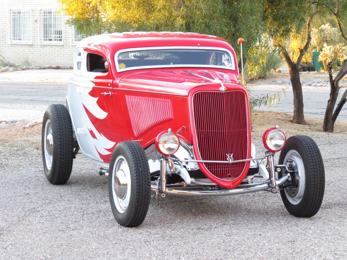

  13. IMG_1555.JPG Oh yes. It's been done for quite some time. You have to play around with linkage lengths to get it right. I suggest making an access hole in the bottom of your bellhousing so you can see the throw bearing and the distance between it and the pressure plate. I made a 1 inch hole and used an expansion plug to fill it . The only way to get your linkage right without burning up the TO bearing. I had to find the right clutch arm for the shaft. I'm using early ford style stuff from Mac's in New Zealand. It's kind of a bitch but it can be done. Not much room under there to work. The Mustang MC was a loser. I took it out and went with a Corvette MC that has a much bigger bore. Now the car stops.
