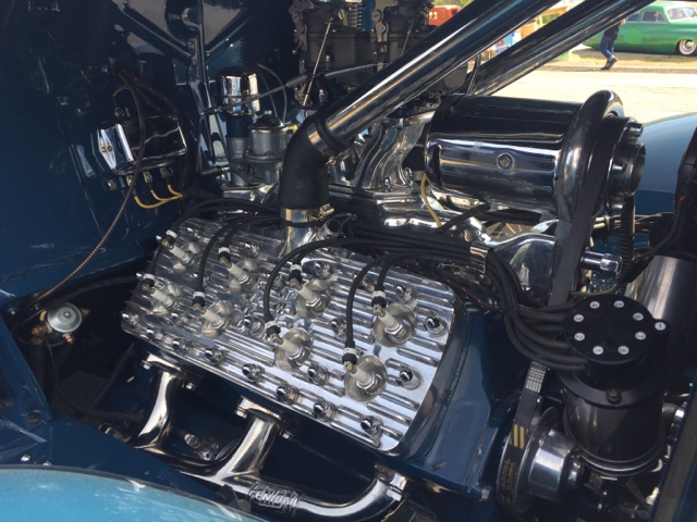

    7BA9DDA5-0928-4692-BA72-2387776B3B95.jpeg Gr8 planning and even gr8er if not spectacular MACHINE workmanship,BUT, correct if I am wrong; the main or sole purpose for having dual plugs is to “fire” or “ignite” any and all remaining fuel that was left over or did NOT get totally burned by the first plug!! Right or Wrong?? Looks like a lot of work and prep that will make little difference in the outcome of the cool flathead. I am not trying to bash your beautiful machine work, just wondering what effect(if any) dual plugs on a Flatmotor will show??

    Pete, I just discovered this thread. Great work, truly innovative. To comment on Flatheadjohn47's question there is more to it than just two sources of ignition to complete combustion. Twin sparks allow one to increase the burn rate of the charge, to reduce total ignition lead, and thus reduce the "negative work" done by having to ignite the charge against a rising piston.
    I do like the fact that with two separate distributors there is the opportunity to stagger the timing. Perhaps one needs more advance than the other? Have you tinkered with varying the timing between the two Pete?

    Pete, thanks for answering my question concerning the dual spark plugs on the cool flathead.

    I did say right at the beginning of this thread that the usual costs involved far outweigh any gains, and it’s for that reason I did my own, well that and I don’t have the money anyway.
    What the twin plugs did do though is smooth out a very lumpy idle.
