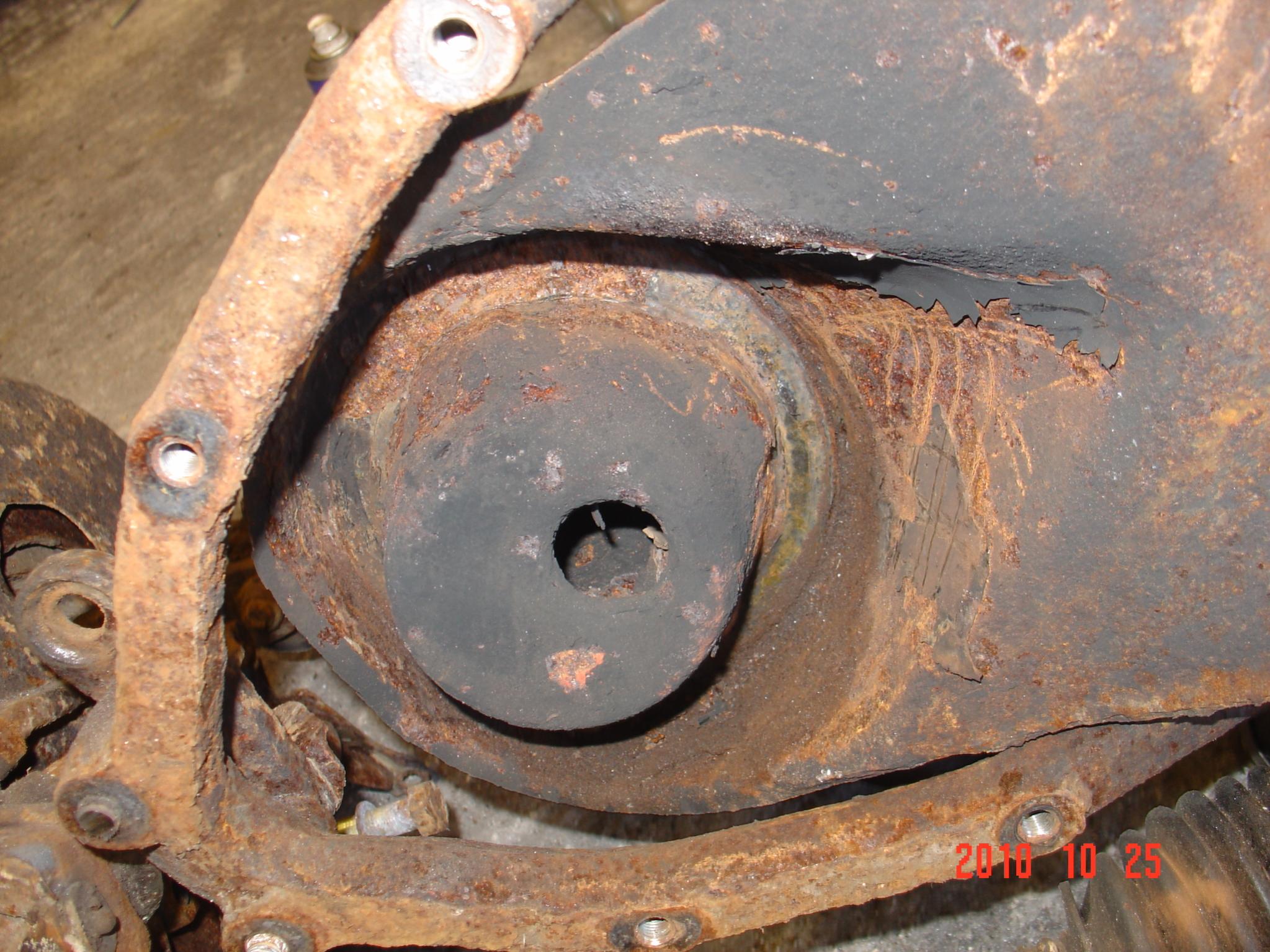

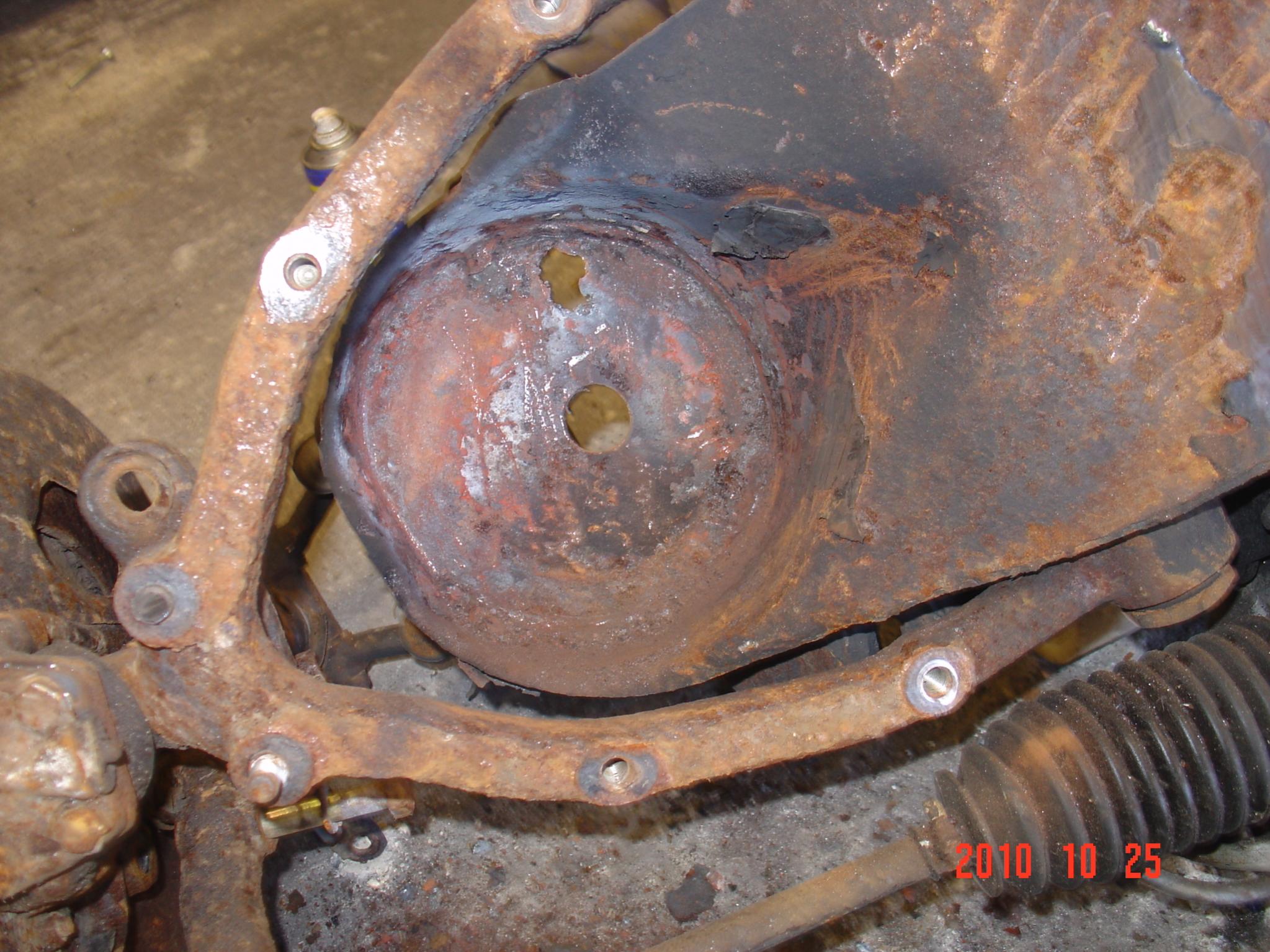

    Bags in a Jag is easy all you need to do is remove the centre spring cup, drill 2 holes in the top and weld up the centre on the lower spring plate and drill a hole for the bag mount. Dampers I run KYB on the stock lower mount and make a top mount. Iv done a few of these but dont have many pictures, next one I do Ill do a tec on it.
    You can see in the first picture the spring cup, drill out the spot welds and remove. This one had a bit of rust but you can see the centre factory hole the air line goes through this, you need to drill 2 holes for the bag.

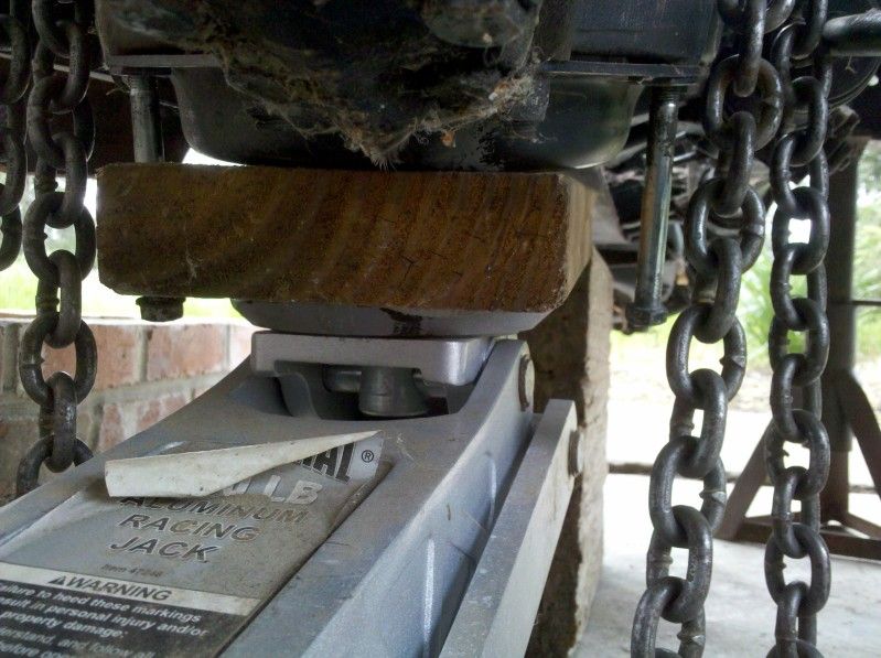

    Well I'm gonna make the swap over to the Slam Specialties SS6 bags. I'll do something very similar to what Orn showed us above. I plan on pulling the coils out and rigging up some shims/blocks to sit the suspension to its correct ride height. Do the upper and lower control arms sit level? Is that what I'm shooting for here? I'm wanting to get the truck sitting right so that I can start working on my motor and trans mounts and get that SBC off my garage floor!!!
    Can someone give me some advice on pulling these coils?? Is there an easy method? I was thinking of putting my jack under the bottom plate and lifting the front end up. Removing the bolts that hold the bottom plate on. With jack stands under the frame, start lowering the jack/control arm... hoping it slowly releases the coil so I can pull it out. Am I missing something here???

    My XJS manual says that normal ride height is 6" from the ground to the crossmember. The lower control arms are angled slightly downward at that height.
    You can lower the coils out the bottom, but you need to guide the spring pan so that it doesn't release all ****eyed on you. Get four long 3/8" fine thread bolts and use those to guide the plate as you lower the jack.
    The other option is to use a long threaded rod instead of a jack. There's a hole at the top of the spring pocket and thru the spring pan where it can fit thru and you can just slowly unscrew the coil.
    Also, these cars can be lowered by using spacers between the spring pan and the lower arm, too. 1/2" of spacer will lower the car about 1". Use longer Grade 8 bolts to hold the pan on.
  19. Slag Kustom
    Joined: May 10, 2004
    Posts: 4,312
    Slag Kustom
    easy way to remove springs is 4 long threaded rods in place of the spring bolts put a chain around frame and under jack.
    jack up so chain is tight, remove bolt and put rod in, after 4 rods are in take out other bolts and lower jack.
    there is too much tension on spring to try and lower it out with out the chain around the frame
  20. Orn
    Joined: Jul 17, 2005
    Posts: 1,106
    Orn
    When I remove my coils I use a 2x2” wood beam standing up on top of the frame and up against the garage ceiling and then a jack under the bottom plate and lift it to take out pressure and then remove the bolts and slowly lower the jack and the coil falls down nice and easy.
    Maybe a little “low tech” but it works nice. ;)

  22. IRON MAIDEN
    Joined: May 28, 2010
    Posts: 517
    IRON MAIDEN
    Thanks for the advice gents. I was able to get the coils out without even a ****** knuckle. I had some long bolts from the Jag I parted out but they were too short to let the tension all the way out!!! So I dropped a couple rods through the two bolt holes next to the shocks and removed all the bolts and lowered the jack. Worked like a charm. Also used the chain arount the jack and crossmember. The block I used between the jack pad and bottom plate had nails I put in it to keep the block locked in position. It seemed to work well for being such crude engineering. Or, on the spot engineering as I like to call it. No need to make a fancy one to use only once.
