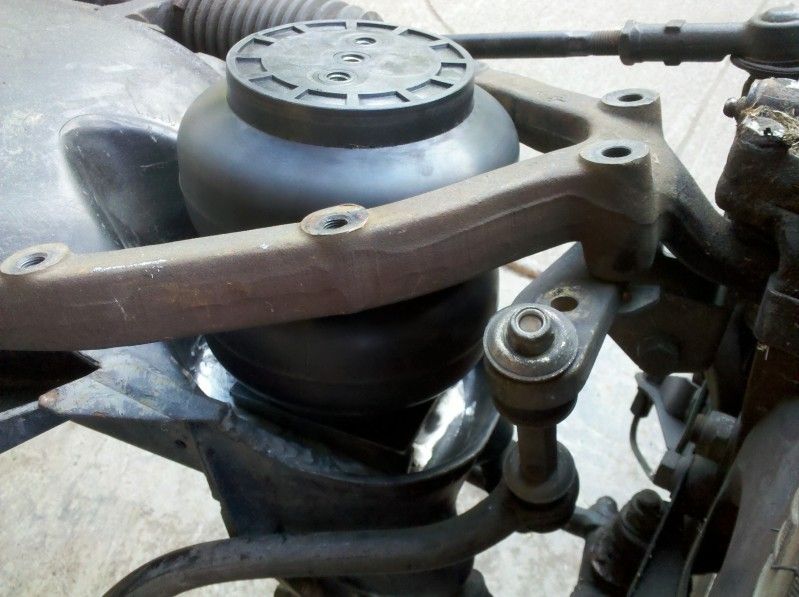

    So for the longest time I've been debating how I was gonna solve my wheel versus the Jag hub problem. Machine the hub shoulder down. Run a spacer to keep my wheel off the shoulder. Open up the wheel holes to clear the shoulder. I've waited months and months as I wasn't sure what route to take. Well, I decided to bag my Jag frontend and have been working on it. I was at a rod shop pricing out bag mounting plates and ended up buying some spacers for the wheels. All excited, I went home to see if they worked. Guess I never tried my Centerlines on the Jag front???? They fit no problem without spacers!!!! Did I really not try them before? What a rookie move.

    I ordered up the Slam Specialties SS-6 bags. I already made the lower mounting plates, now I just need to get the bags and figure out the top mounts. Thanks to ORN for showing me how easy it is to bag these Jags. I'm pretty much doing what he did but I made my own plates after seeing what they charge for them. Total ripoff! I'm gonna do the top mounts a little different than he did as well. With the Jag crossmember 6.3" off the ground, what I read was correct from the factory, I have 7" from the top and bottom plates. The bags I'm using have a range of 2.7"- 11". I'm trying to set it up so that the bag is in the middle of it's stroke at proper ride height. I'll post pics asap.

    Finally got around to fitting the bags in the frontend. I had modified the lower spring mount the way Orn did and had been looking at the top mount trying to figure out how I wanted to make it. The top and bottom plate are angled away from each other so when you compress it between the surfaces, it squeezes one side of the bag more than the other. I didn't like it so I made angled top cups/mounts to take away the angle up top. Now the bag sits straight up and down. Then I cut the bottoms out of the lower spring mounts and corrected the angle that was in them so that the top and bottom mounting surfaces are now perpendicular to each other. I still need to clean them up to match as best as possible and weld in the mounting studs in the upper cups. Drill the mounting and drain holes. I'll post a couple pics when I mount the bags back in. First pics are the upper mounts. The front end is upside down, obviously.

    The lower mounts. First pic is how I first did it. Just flat plate welded to the bottom.

    I ground down the outer welds but left all the welds on the inside untouched. I can't imagine these not being strong enough. I went through an entire roll of wire building them!!!
