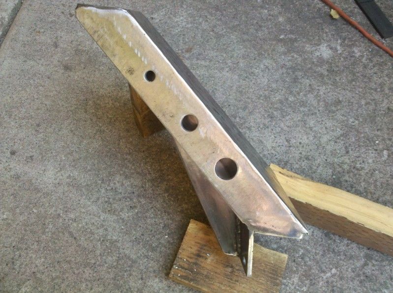

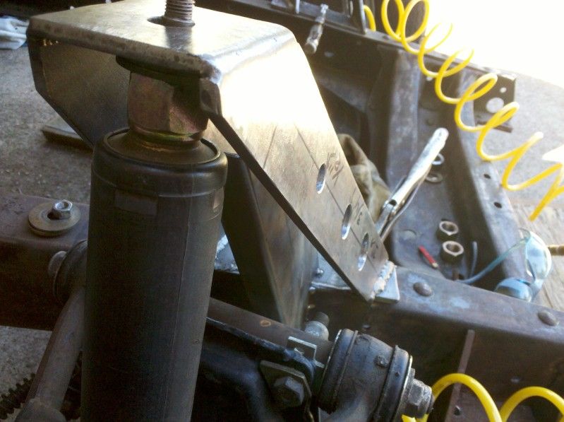

    Well, you had me more concerned with the shock bottoming out before the suspension. So I dropped the suspension as far as it would go. Let the air out that is. Then fabbed up a quick mount to hold the shock in place to test throught the full travel. With the suspension fully dropped, the mount holds the shock about 3/4" from being bottomed out. It's just enough to be able to compress the shock and slip it out of the upper mount. Then at full lift, up against the upper bumpstops, the shock reaches its fully extended point the same time as it hits the bumps. The suspension can cycle through its full range without the shock holding it up. But, at the fully up position, the shock is done. So now I question myself as to what extreme I will ever reach. If the suspension ever bottoms out to the point it runs out of room, the shock will still have a tiny bit more breathing room. But if I ever hit my upper bumps.... the shock may bottom out or fully extend at the same time. It's one or the other. Or I could adjust it a bit on the bottom side to have the shock 1/4"-1/2" play left, and that should give me about the same bit of shock left on the upper side of my travel. Any thoughts?

  18. CoolHand
    Joined: Aug 31, 2007
    Posts: 1,942
    CoolHand
    Alliance Vendor
    The way you have it now sounds like it will work just fine, unless you plan to drive on it with the suspension all the way extended like that (I don't know why you would).
    If you want to move it down a bit so that you're not hard against the end of the shock in either direction, that's fine, won't hurt a thing.
    You shouldn't come close to ether end of the stroke under actual driving driving conditions, so you'll be fine either way.
    You have to bottom a shock out pretty hard to bend it or the mount. Think hitting a giant pot hole or a giant speed bump at 50 mph.
    Short of that, the suspension shouldn't ever compress or extend far enough to bottom the shock.
    You'll be fine.

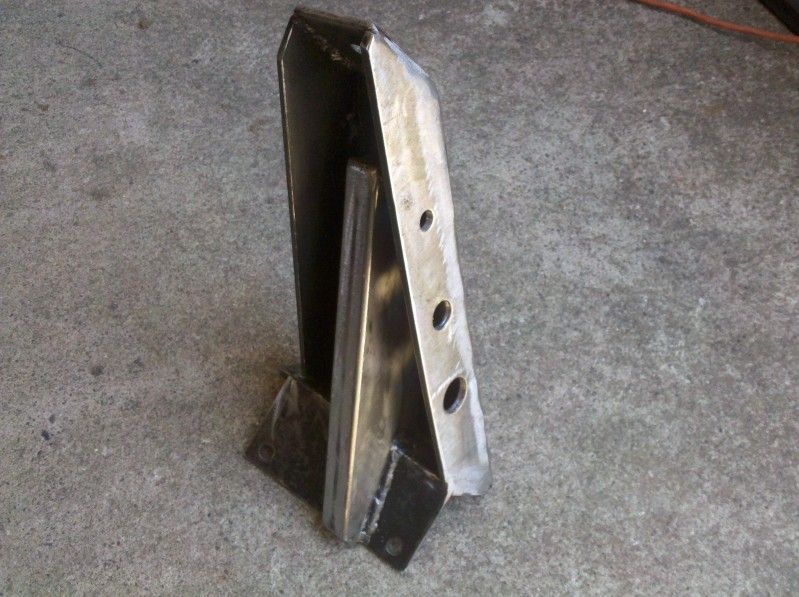

  20. IRON MAIDEN
    Joined: May 28, 2010
    Posts: 517
    IRON MAIDEN
    Everything lines up and is level. The mount will wrap around the outside of the frame and have a support gusset. I just havn't decided on how I'm gonna finish the front and or backside of the arms. Just box it all in or do something a little different. Gonna stare at it and think about it a few days. Also deciding if these should be bolt on or just welded to the frame.
    I'm happy with them though, they seem to position the shock perfect as it moves from bump to bump. 1 more problem solved.

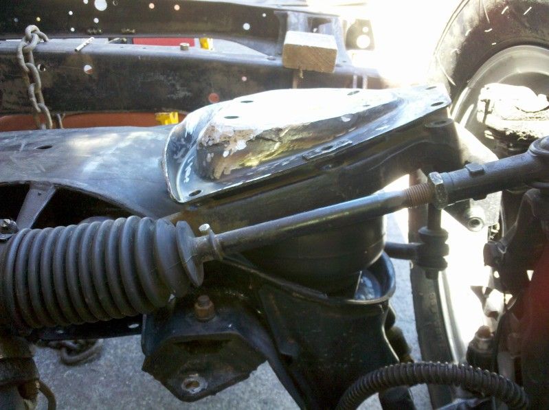

  21. IRON MAIDEN
    Posts: 517
    IRON MAIDEN
    Finally finished the shock towers. It's been 100+ and being bundled up to weld ****s but what's a little sweat when you make progress.
    I'm gonna tack them on for now. I've been using .035 flux-core all this time and have been holding off finish welding anything on the frame as far as suspension and such goes until I get a gas setup for the mig. I'm moving to the rear now. Gotta get the leaf springs mounted up. I will fab up the front spring hangers but am now thinking about using leaf spring sliders rather than shackles. I really like the way they look and it will mount the rear spring eye higher than I could have with shackles. I'm not sure I will find any sliders that will work with my Explorer leaf springs though. Seems they are all made for chrysler springs. I'll keep searching or maybe use different springs. My Explorer leafs are 2.5" wide but the bushing sleeve is 3" wide. The bushing diameter is 1.75". The sliders I've found, Afco, Speedway, Summit... all have a 1" bushing for Chrysler spring eyes. If I can't find any, maybe I can have a couple reducer sleeves made up that are 1.75" OD/ 1" ID. press them into the spring eye and them the solid slider bushing into the sleeve. It's a thought.
