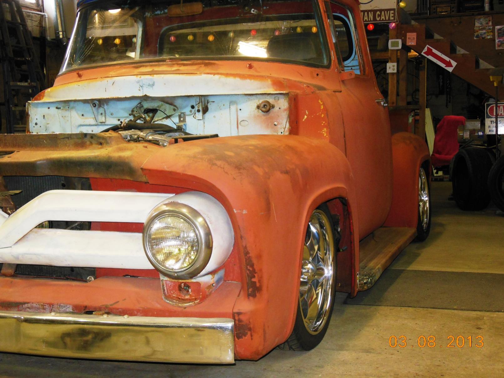

    This posting influenced me into purchasing a 79 Jag XJ6 last spring, but I was finishing another project for my daughter inbetween times (64 MGB). Over the last couple of weeks, I must have read through this thread another 3 times. The posts on the air bag option tipped me toward doing a solid mount as Paul indicated at the beginning. I appreciated his availability via PM to answer some questions, and as this is my first true hot rod project, it could not have been made easier. The IFS is mated with an 89 T-bird SC IRS (Team321 adapters used) and since this post hasnt evoked any flaming (as yet) I will stick my neck out by saying that I am probably going to stick the SC 3.8L V6 into the truck...(anyone know of any forum members who used this engine?)
    Here are some before/after pics, even though it is not loaded and the rear is fixed about 1" too high with all thread in lieu of springs. Nice wheel combination, wouldnt you say?
    Thanks to all for an excellent post!
    John

    Where are your install pics??? You praised the thread for all the contributions made by other members yet you didn't include yours??? Let's see how you did yours and maybe it will help the next guy. Truck sits nice. Did you airbag the front or were you doing it later?

    Very nice. I am using the Jag/Mark VIII combo in my `57 F100, on bags. Should be a good combo.
