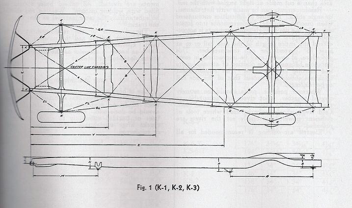

    Sadly, the tech links such as geocities are expired, and leaves some question marks for the unknowing.
    EDIT: Here's a pic showing the IH frame Iron Maiden is talking about.

    The 86 Jag will be a series 3 which is what you want. I would go and get it. You can sell the rear IRS if you do not use it and other part outs are possible such that the IFS could be free.
    I chose to box the front of the frame on my F-1. It is not absolutely necessary, in fact, Kent Fuller told me that it was not necessary. I was surprised at his response to the question when I asked him however I can't think of a more qualified person to answer the question. He built hundreds of drag chassis in his career. His list of custormers included guys like Tommy Ivo and Don Prudhomme amongst others.

    Very nice. I just got back from looking at it. Agreed to $500. I'm meeting my friend there at 9am tomorrow to tow it to his yard. My friend, and coworker at UPS, owns a tow business. He let me strip the Ford 8.8 rear out of an Explorer on his lot before he sold it to Pick-N-Pull. That's what I'm putting in the back of the Harvester. He's towing it to his yard and after I'm done taking whatever I can use or sell to get the $500 back, it's his to sell to Pick-N-Pull. We both make out. Car is in great shape. I didn't look at the odometer but he claims the car only has 28K on it. The motor had a cracked head after being driven without water. the motor is torn apart in the car. He said it's a different motor,? I don't care but I hope the 28K miles is true as the front end should be in fresh shape. especially the steering rack ; ) I measured the front donut rubber mounts and they are about 28.5" center to center like mentioned before. It was raining and I didn't want to lay in the puddle to really look under the car. From what I can see, it's very oily and dirty, like a car with 128K on it. But, it's all torn apart and has obviously had motor/head problems so it might look like that due to those mechanical issues. Think I found a winner though.
