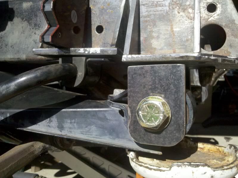

    I cut some quicky 1/4" tabs to tack up the front mounts. It levels the crossmember as the truck sits right now and will be fine until I get closer to redoing them. Problem I'm seeing now is the clearance for the swaybar. Only have 1/4" between the bottom of the bushing retainer and the crossmember arms. Not sure how much the crossmember will move but I/m guessing it will hit here. Think I'm gonna seperate the big plate and raise the swaybar portion to level it with the bottom of the frame. This will give me another 1/4" of clearance.
  4. Had you considered moving the sway bar saddle mounts "outwards" 1/2 an inch each side? might give you enough.

    Yeah, it was the first thing I tried. Didn't really help enough. I've got a couple ways I can correct it. Just gonna see what one I like better.

    So I changed my design a bit. It may have been fine as it was but.......
    More than anything, I'm just trying to be smart and avoid a possible issue. It may have cleared and it may have rubbed. I will never know. It took me an hour to make adjustments to the mounts and now I have "Peace of Mind". That's an Iron Maiden reference ; )
    I'm sure there are much easier ways to do stuff like this and I wish I had the right tools to do it with, but I'm sure I will appreciate the truck more when I'm done being I did it all the hard way.
    Plenty of clearance now.

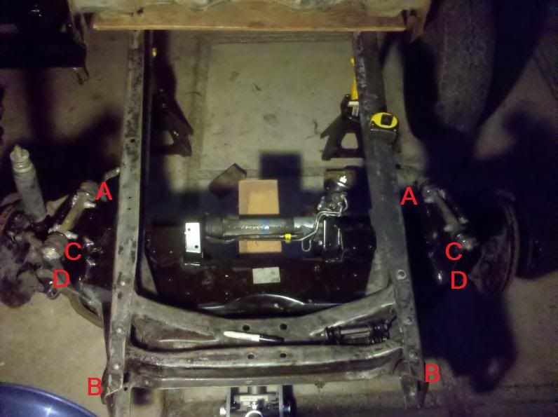

    Next is on aligning the Jag IFS in the frame. I'm asking after I already tacked it in place. I was fed up with trying to align it and finally said "F" it and tacked away. Picture below will help me describe how I did it. I measured from the frame rails. "A" and "C" are the outer washers on the upper arms. "B" is the front bushing mount outer edge. "D" is the actual crossmember tower.
    I was able to get the "A" the same on both sides. "B" the same as well as "C". But the two spots I measured on the crossmember tower "D" were off??? WTF!!!!!!!

    Iron maiden the best way to measure is to fixed points on the crosmsmber, The A arms can measure different because of hittinig a big pothole. adjustment after a wreck, or alignment set for a high crown road. and the lower A arm is normally set parallel to the ground when the frame is set at ride height and ride angle. The year you are using has a lot more adjustment for alignment that the later years F 40 jag's.

    Thanks Gents. I called my buddy up who welded up my grille for me and is loaning me this little Lincoln I'm using. He laughed at me, yet again. The one I have is a 220V but obviously not up to the task of much other than tacking. He was the one who suggested I use the solid wire. Either way, he offered up bringing his other welder over and doing it for me when it's ready to finish weld and maybe I can get some more lessons : )
    Here's where it's at now. Yes, the frame where the rear mounts are will be beefed up. Front is tacked and bolted up though. I put the wheels back on, lowered it down, and stacked 450lbs of weights on top of the frame. Still on the bump stops ; )

    The only way that would possibly make sense is if you had a different amount of caster/camber adjustment shims on the driver's side vs. passenger side. Can't really tell from the pic.
